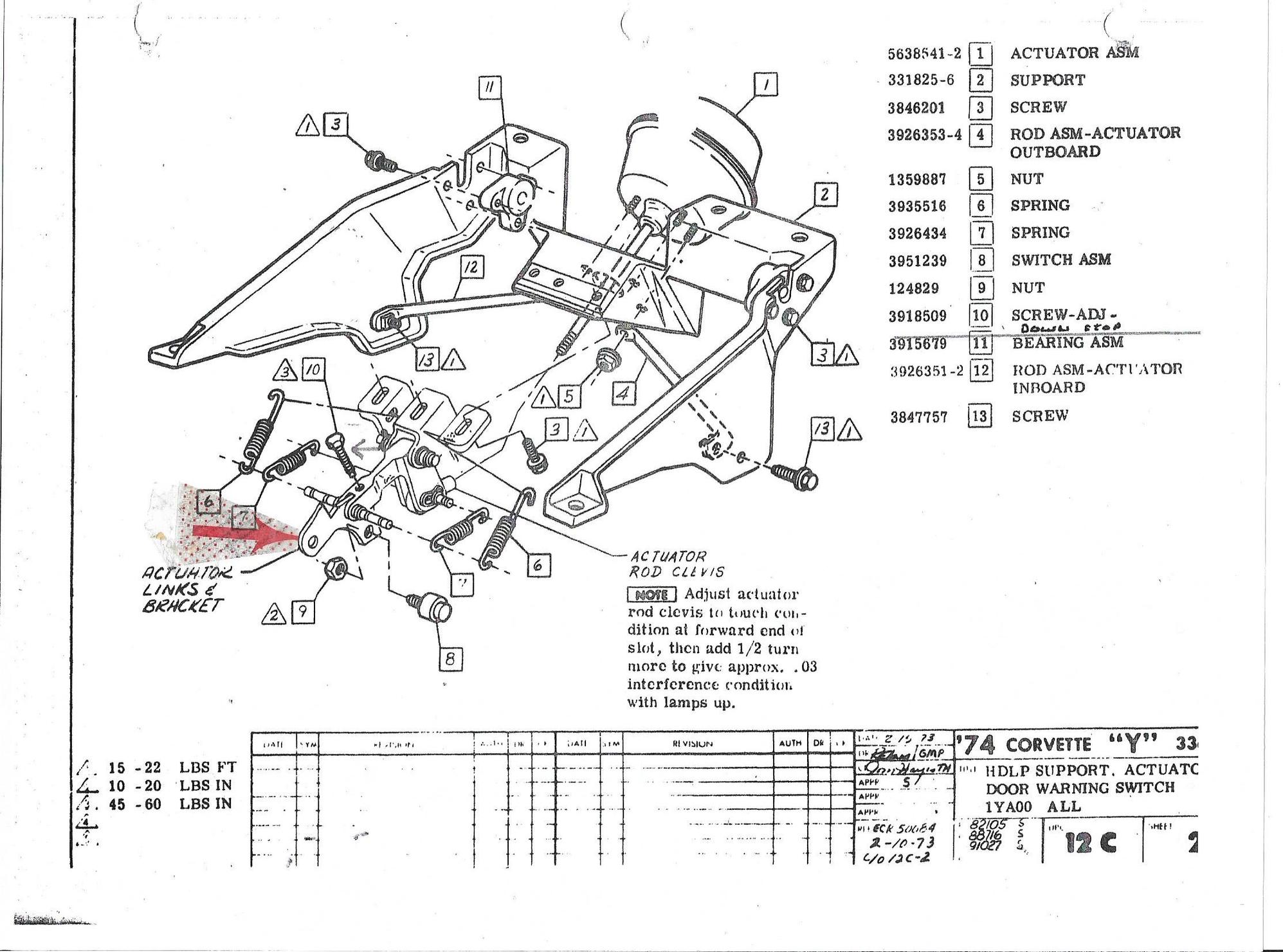

Go under the car and pull down on this part.
Thanks for your help and the schematic

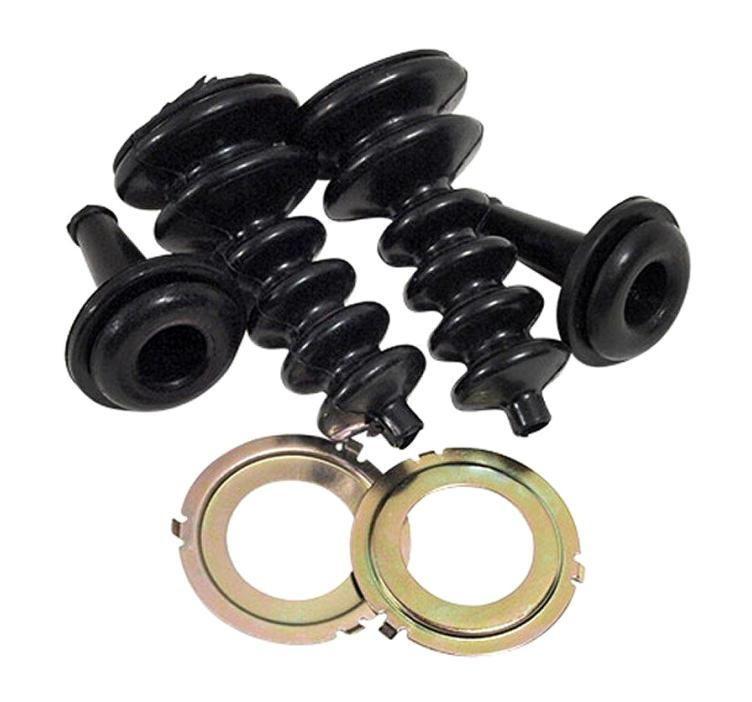

Many times you just need new seals:
To 78 headlight problem
