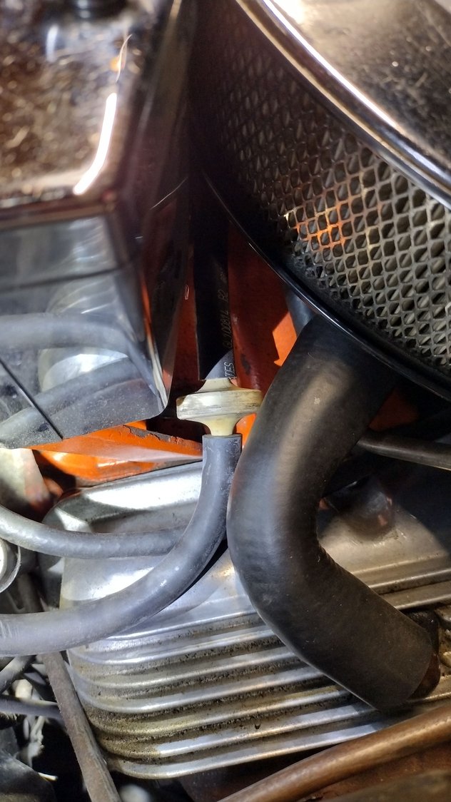

Looking to identify the name of this. The plastic piece in the vacuum hose. New to C3 so cut me some slack please

Filter

Yep, it's an air filter and if it's original, I'd replace it.

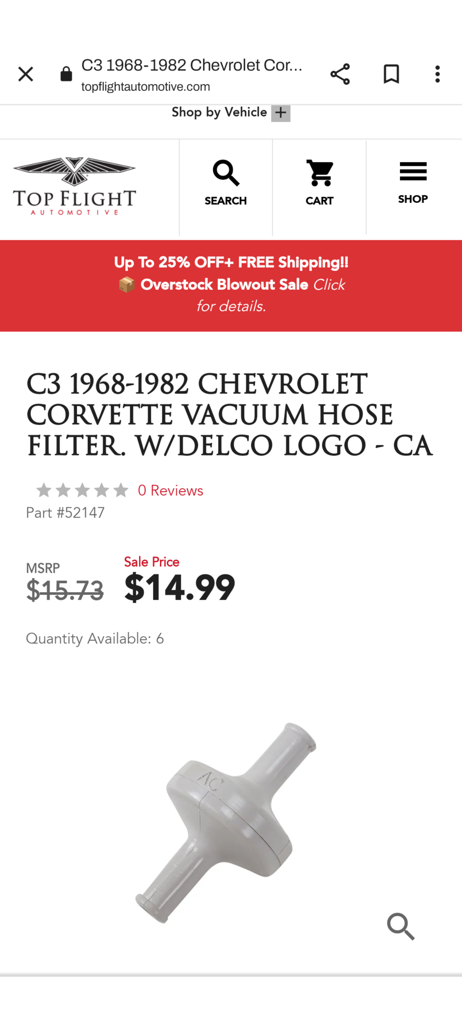

I might be getting hosed or did you actually mean this?

Both replies were answering that the small plastic piece is an inline air filter to keep any small bits of schmoo from being directly sucked in through the manifold vacuum. Being new to the C3 group, I think you were overly sensitive to getting razed over something. Back to the filter: it's a very basic sort of thing that doesn't have much filtering meat to it.

What I have done with those filters before is make a pencil mark across the seam.
Using a fine tooth hacksaw blade follow the seam and split it open.
Originally there was a piece of foam inside that usually dries up and disintegrates into fine dust...
Cutting a circle from a drip coffee filter holds up very well.
Super glue around one half, align the 2 pencil lines seal the 2 halves back together.

I bought one....
