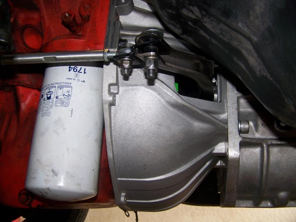

Could anyone please tell me where I could get a clutch fork setup like the one in the picture? Thank you

https://www.mamotorworks.com/corvett...-joints-675620
There may be other vendors, also.

I would highly recommend not using the small bracket and grind the slot in the clutch fork wide enough for the helm joint to go right into the fork. Eliminates a huge failure point on these. Might need a longer rod to extend it. I did this a few years ago and it works great. I bought mine from Speed Direct.

The connection at the fork is rather cheesey. This is 75hotone did his. Start at post #15. https://www.corvetteforum.com/forums...h-linkage.html

buy the parts, build your own = save money
upper / lower rods, so the rod from the clutch pedal to the Z bar (upper) & the Z bar to the clutch release fork (lower) is that what is being said ?
someone in the referenced post on the other thread mentioned a 5/16" end was hard to locate, just make a reducer from the 3/8" hole to 5/16"
about as simple solution as you can get.

I found the proper hard to find rod ends at Summit when I did mine. I used the part numbers found in the above referenced thread.
