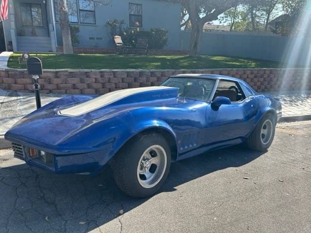

Originally Posted by randallsteel
I’m curious if you are going to have hood clearance issues.
If I remember right when I added a manifold that was an inch taller, I had to buy a drop base. After some other mods I ended up going with a hood cowl
yup. :-)
