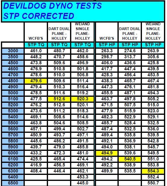

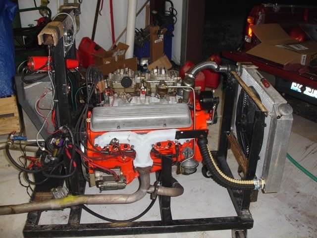

Since we're looking at past combos.....we had fun building this 400" one for a magazine project. It was a plan to just select parts and bolt them together with no tweaking (which killed me!) using parts from the DART engine packages. We used an all forged bottom end in an SHP block and a set of their as cast 200 cc heads. These were actually their early design..not the newer ones. Definitely not where AFR CNC heads are...but they did work.
We used a tight lash solid roller cam 248/248@.050 on a 109 LSA and lift went over .600" with the 1.6 rockers. There was a LOT of strategy in this came. I spent over an hour with Billy Godbold at Comp going through various lobes basing it on "where" the restriction would be. It wasn't the carbs....it would be the tiny intake. The only way to get more air is more duration. Same on exhaust side..."where" is the restriction? Manifolds? Headers? Mufflers? Which mufflers because they act different. Etc etc. This one uses an "intake" lobe on both intake and exhaust side for the better ramp rates. We could have done it with a hyd roller also..but the owner likes the solid lifter sound.
We tested it with 3 carb/intake setups. Since it was destined to go into a pretty much original '61 283/270 HP car with hubcaps...we first tested it with a heavily ported/welded 283 2x4 intake using WCFB carbs. Tiny intake even after porting it to within an inch of its life. We had to add metal to top of the runners (and then disguise so no one notices) to cover the intake ports in the heads. Then we threw on a Dart dual plane and 750 Holley and then a Weand low rise single plane with the 750 Holley.
It is in the car with a TKO 5 speed and 3.08 rear gears. It runs killer and is easily drivable.
JIM

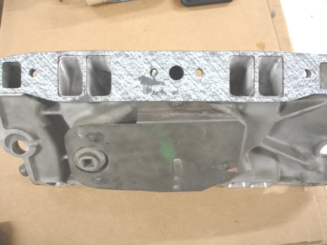

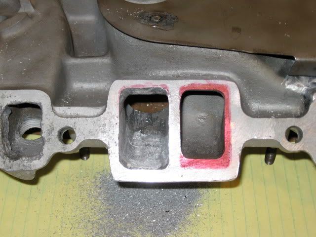

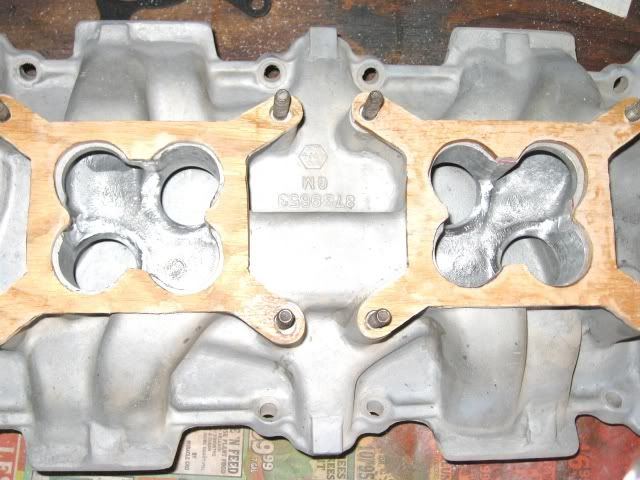

You made that power through manifolds? Tell me more....that is a large cam to have no scavenging......is that an exhaust balance crossover up front on the dyno?
The 388 is impressive too.....with that 220 head.......
We built 555/565's with 345+ cc heads all the time back in the 2000's......they all ran great but that big bore is a whole different ball of wax......you probably spun your N/A combo pretty high too I bet......
I love 565's.....probably my favorite engine of all time......still a short deck, massive torque and ballzonya power......632's and all that are cool.....but all stroke.....
I could put bigger heads on my builds but they are just so much better off idle and you can lug the **** out of them in the wrong gear with a small head......keeps the carb signaled.....and they make just about the same power upstairs.....my school of thought and it works....
The big solids are cool too......but no one wants to lash valves.....I drove a members 1980 406 Auto combo with a Howards Hyd. Roller like your solid and it was sick.......better point where you are going first LOL.....
That WCFB Dual Quad intake is very interesting......one of the worst "performance" intakes ever.......but I imagine the whole package was neat.....500hp in a fairly stock solid axle would be white knuckled LOL.....were any mods done tot he WCFB's?
Fact is.....it is really hard to screw up a well built engine with todays heads and cam grinds......they are all just so good now.......and the learning curve has pretty much reached its end......everything that has been done to improve something has been done to the SBC/BBC.....
