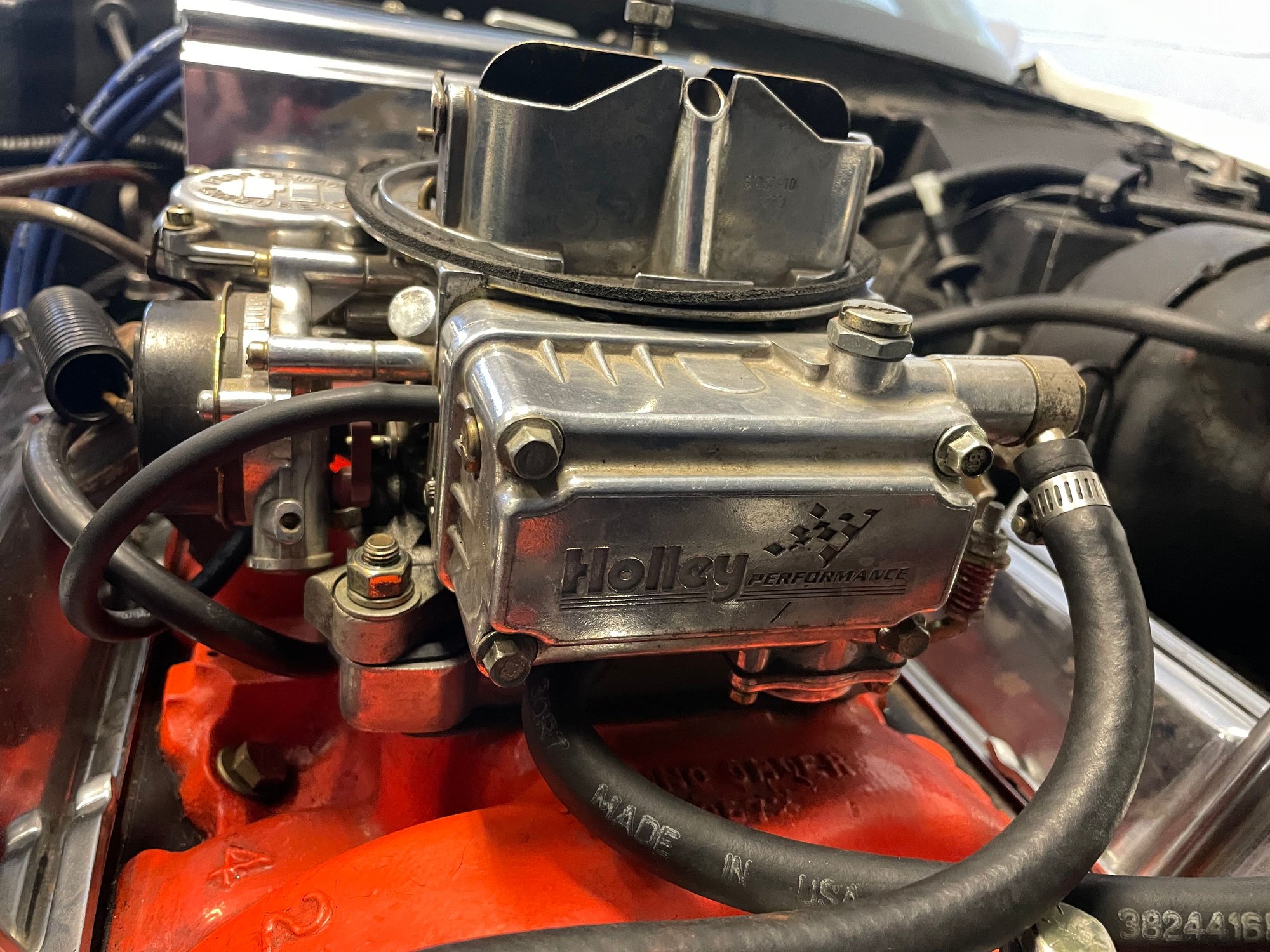

have you had the carb off the car looks like you have a conversation plate I have seen people install them upside down also I would check the float level and power valve

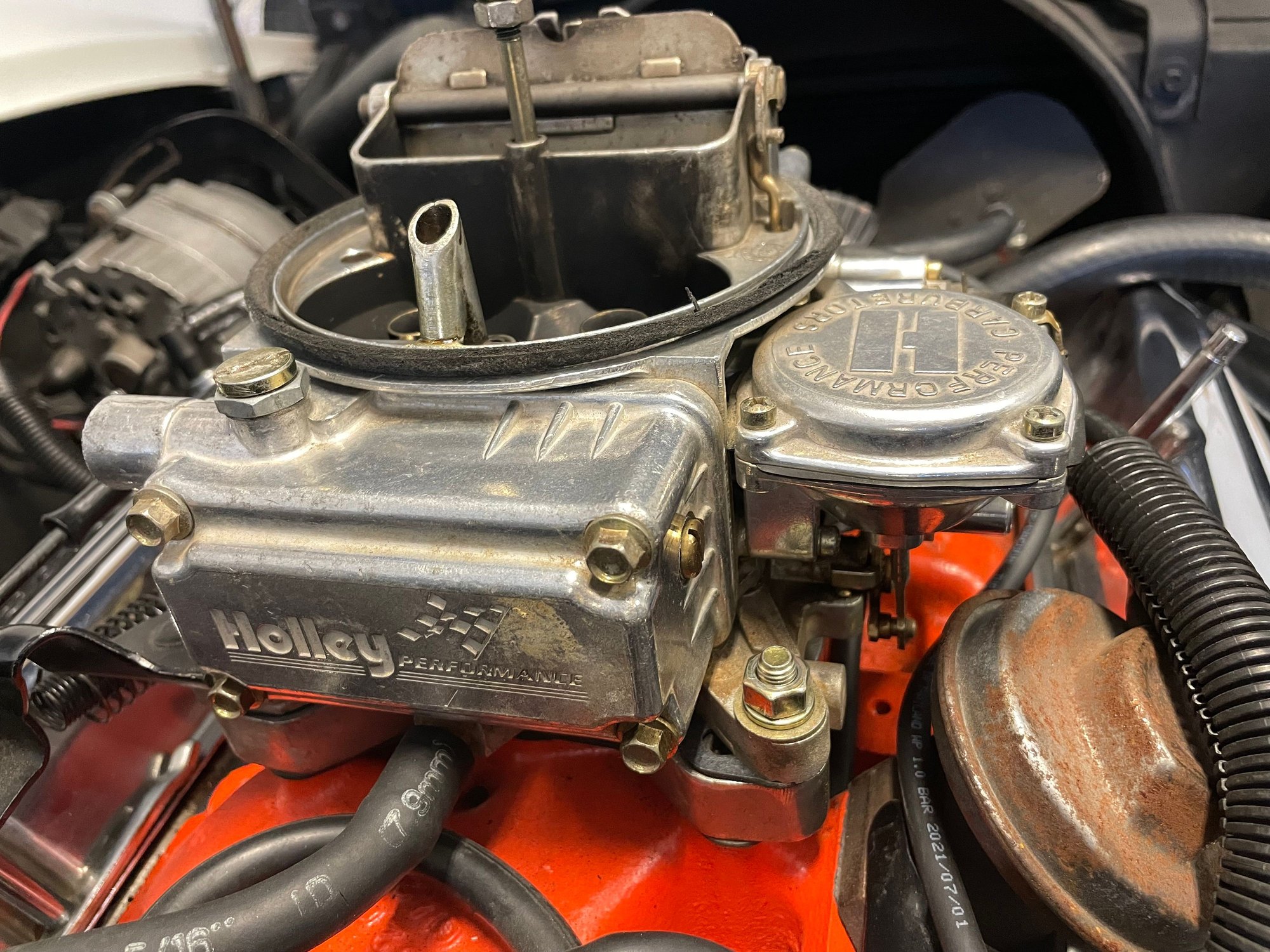

Off hand, I'd say it looks like a Holley... Probably of the 600cfm variety. There is a stamping on the airhorn - visible in the 3rd pic down - but the resolution is too low to read it. That stamp will tell you the model number.
Just for discussion, the '67 427/390 engines came with Holley 600cfm carbs and they perform very well with that setup.

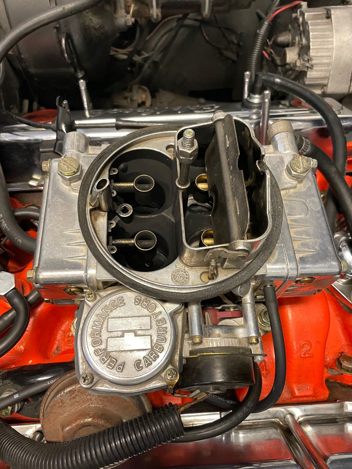

You took photos of every angle, except a photo of the angle showing the carb list number. What's the list number?
Without knowing anything about the carb, I can tell you that you have severe exhaust gas reversion soot staining up through the carb. This is indicative that your timing is way off. Before doing anything with the carb, you need to fix your timing. E-mail me if you need copies of my papers on how to set up your timing correctly. Remember this: Timing affects the carb. The carb does not affect timing.
Also, that carb, without knowing anything about it, is a little 600 or 650 cfm carb. Way smaller than your engine needs (your stock carb was 750 cfm, which you should consider re-installing). You do not need a smaller carb - complete nonsense. You need a bigger carb with a proper fuel supply and a proper setup.

Those adaptor plates are really frowned upon.
Either get a better carb or a better Intake.

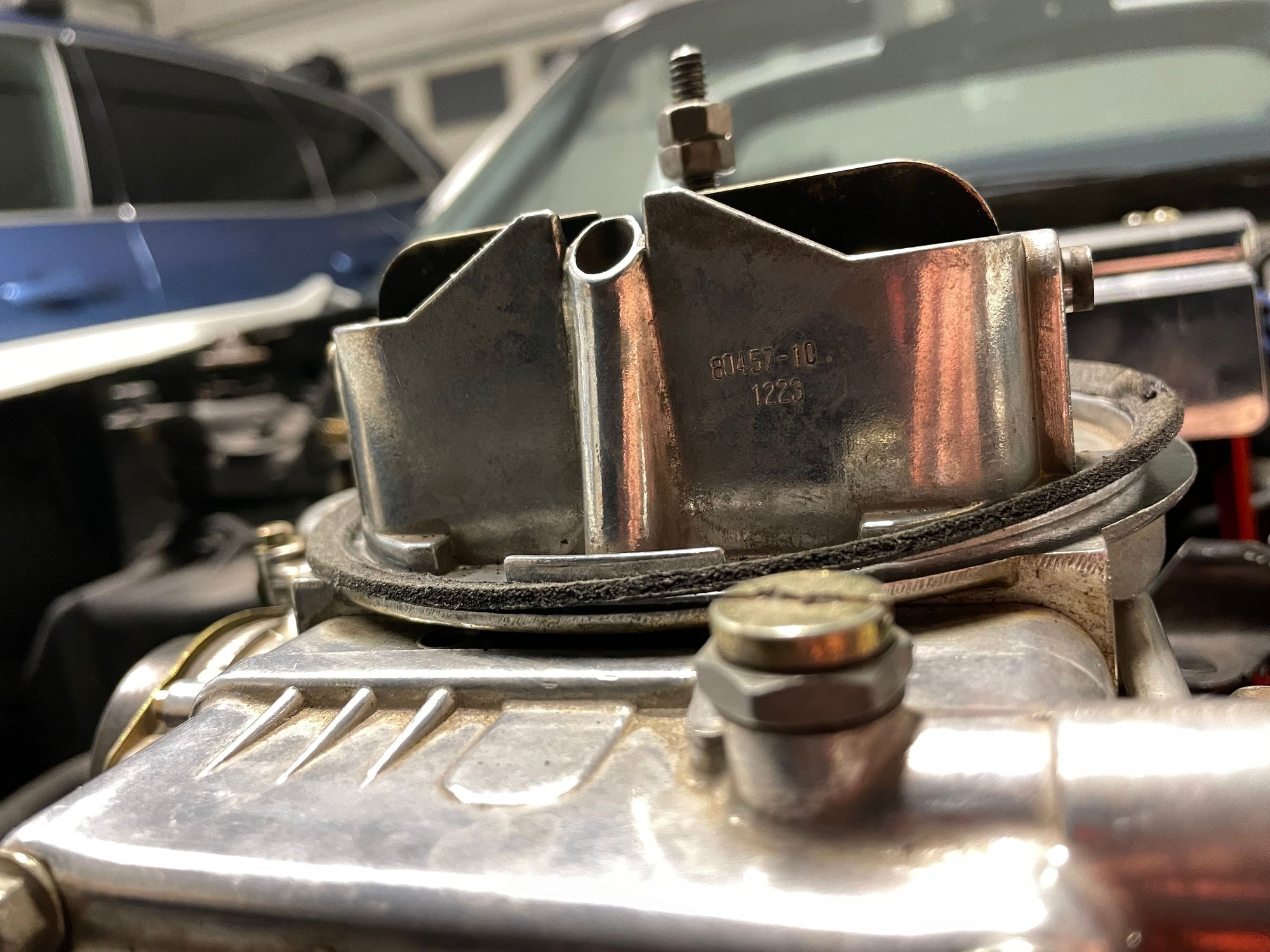

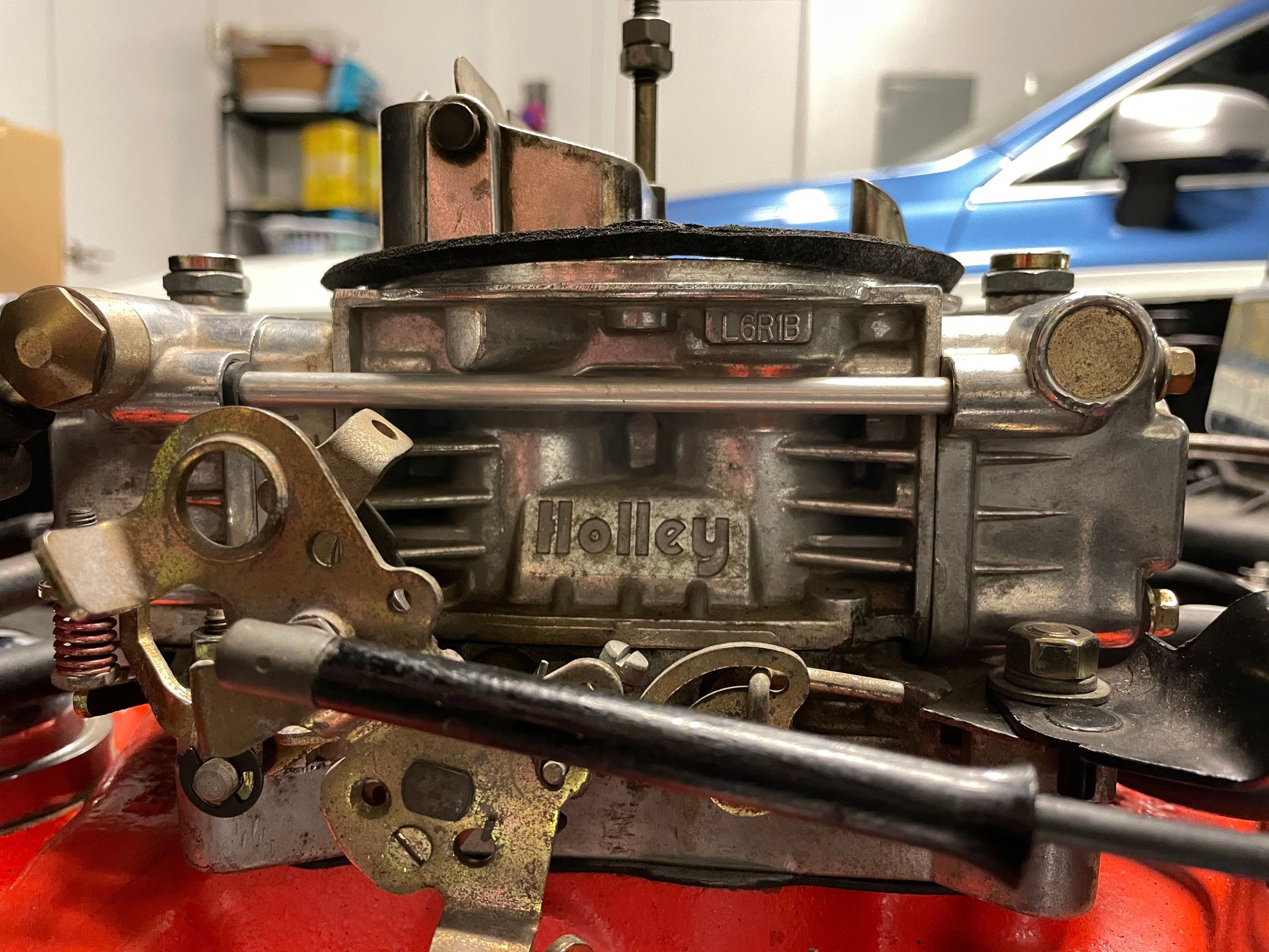

I’m seeing L6R1B and for what someone else indicated is likely the more important number,
80457-10 1223.

80457-10 is the Holley model number, it's a 600 CFM carb. It's not to big for a 74 350, as Lars said it's more likely to small. It's an okay replacement for an AFB carb on a 64 327, but not for a 70's Q-Jet. It's also not a spread bore base carb and requires an adapter plate under it to mount on the stock intake, which doesn't help. Do yourself a favor and buy a rebuilt/restored correct Rochester Q-Jet from one of the companies that specializes in rebuilding carbs for collector cars (and not your local parts store).
I can't understand in the first place, why someone would use that carb on a stock intake? If they really wanted a Holley, Holley sells a spread bore replacement for the Q-Jet, that's a direct bolt on. I'd still look for a correct Q-Jet myself, and stay away from the Holley's. You can tune that carb up all you want and it still won't be right carb for your engine.

Your retarded timing won't damage the engine. It will cause poor fuel economy, poor performance, and elevated engine temperatures.
As for the Q-Jet, you can technically use any Chevy passenger car Q-Jet between 1969 and 1974. However, if you want to have the option/ability to hook up all vacuum hoses and systems, and if you want the throttle cable/lever system to be correct and easily installable on your car, you need to stick with a 1974 Chevy passenger car carb. The throttle lever was revised in 1974 from the design used up through 1973, and the '74 carb has vacuum hose connections unique to that year. There are a lot of those carbs out there in good, rebuildable condition for a very fair price - you just have to look. You can e-mail me for info on what to look for.

That's a little 600 cfm 4160-series vacuum secondary carb - it's one of the smallest 4-barrel carbs on the market. Keeping in mind that the stock factory Q-Jet is 750 cfm, it's a big step backwards in terms of potential performance. Additionally, that carb, in its Holley-supplied configuration, has the "black" secondary diaphragm spring in it, which will prevent any operation of your secondaries. With a significant amount of work, you can make that carb run, but the end result, in the "best condition," will be far short of the performance you'll get from a properly set up stock factory Q-Jet. ...And the stock Q-Jet will allow you to use the stock air cleaner assembly for a very nice appearance.
A stock factory Q-Jet will require a bit of mechanical ability and work on your part. Your fuel line to that Holley is a dangerous rubber hose, and should be replaced with the stock, steel fuel line. Installation of the stock line assumes that you have a stock-type fuel pump on the engine, with the fuel outlet in the correct clocking position. You may have as little work to do to make your car run right...
You can make an immediate improvement by hooking up your distributor vacuum advance correctly: You're currently hooked up to ported vacuum, which is aggravating your retarded timing condition. Yank that hose off and hook it up to the manifold vacuum port on the carb and you'll see an instant improvement in idle quality and off-idle throttle response (you'll have to re-set your idle speed and idle mixtures once you do this). Make sure you suck on the hose before you relocate it to assure that your vacuum advance control unit is not ruptured - common problem.

As for the black secondary spring, if those aren’t opening am I correct in associating that with the issue on WOT, it’s getting more fuel but not enough air. Unless it’s been modified from the factory-supplied setup, as you noted, I can’t look at mine and tell north from south on it.
