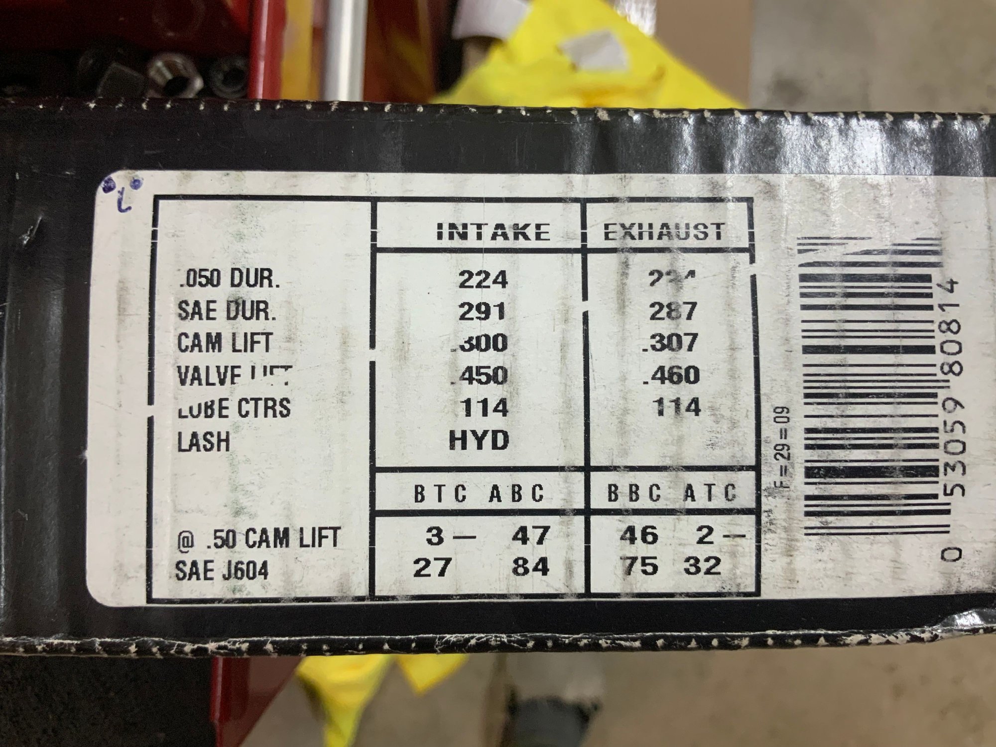

The problem with most of the CompCams cams is that they are ground on a very tight LSA (110 degrees). This tends to produce poor idle vacuum and idle tuning capabilities in a low compression engine, and is more intended to induce that "cammed engine sound" with little benefit to performance in the low-flow, low compression engine. If you note, all the factory performance cams run LSA up around 114 degrees, for good reason.
For comparison, the factory L82 cam is actually a very good unit. It's the same as the 350-horse L46 cam. Its specs are as follows:
Duration @ .050: 222/222
Lift: .450/.460
LSA: 114 degrees
The CompCams 268H specs out as follows:
Duration @ .050: 218/218
Lift: .469/.469
LSA: 110 degrees
The XE262 specs are:
Duration @ .050: 218/224
Lift: .462/.469
LSA: 110 degrees
You can see that these cams are very close to the factory L82/L46 cam specs, but have the disadvantage of the 110 LSA. If I were you, on your otherwise stock, low-flow, low compression engine, I'd seriously consider running the factory-spec L82 cam. You will have good performance (that cam produced 350 hp in the L46), ease of carb & timing tuning, and good manifold vacuum for your power brakes. The 110 LSA can work on a higher compression engine, but on a low comp engine, it's going to bleed off what precious little compression you have... so I'd keep that angle wide if I were you.

What is the advertised duration on the stock 222/222 L-82 cam? I'd bet it's a lot more than 270*. I've read it's in the range of 292*-288*. Can't confirm it, but sounds likely given the era.
That is going to make a big difference.

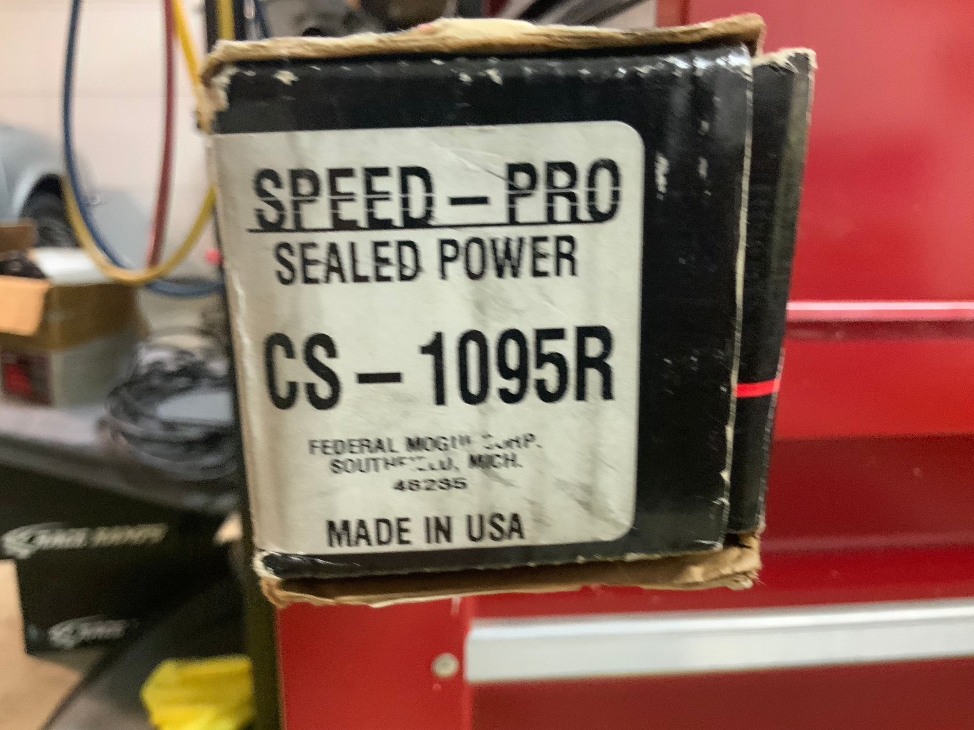

I followed what Lars and SWCDUKE have stated and recommend on the forum for my original numbers matching 1970 L46 rebuild. The motor produces 17” of vacuum at 750 rpm’s, while pulling strong to 6K redline. The motor produced 410 lb ft of torque on an engine dyno, I know after the dyno results, I had Henry Olsen tuned the motor in the car and that tuneup definitely added some more numbers in the torque beyond the dyno results.
This is the cam card from a Speed Pro L46 camshaft.
To Camming the 76
