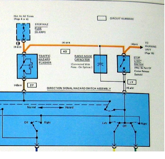

This appears to be a resister of some sort, but I can't figure it out.
It is spliced into the yellow and white wires going to the plug to the engine as shown.
I suspect it is some sort of static eliminator for the Fosgate stereo that previous owner put in, but not sure. Not even sure if this fosgate works.
Any ideas what this is?

Yes that is a factory installed Capistor.
It's done, remove it.
Those are orange wires and part of the courtesy circuit, they are hot at all times.
You may also find another cap bridging the turn signal flasher relay...

Being you have a 74, it may be a Dealer installed cap.
It is your call on removing them. By the looks of it is leaking and decomposing as we type...
But yes those scotch locks are what was used.
Here are both that were factory installed on my 77.
I need to make a correction, the orange wires are your Stop/Hazard circuit not the CTSY, but still hot at all times.
And shows in the circuit...
