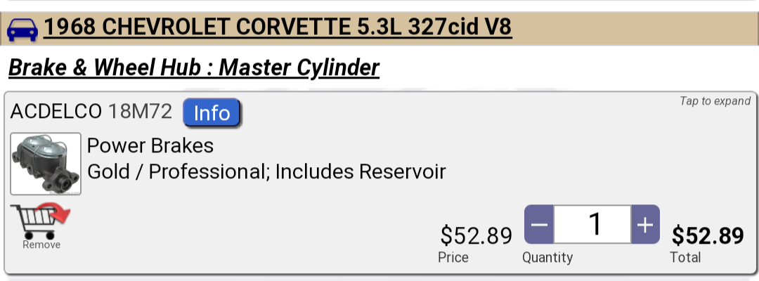

Can I trust Rock Auto if I purchase a master cylinder from them. 1968 PB car? I have heard that parts stores are selling a one size fits all 68-82 master that is not correct. Thanks.

It should not be a problem if you specify an AC Delco master cylinder for a power brake car. #18M27. The bore size is 1.125".
You mean 18M72 not 27?
