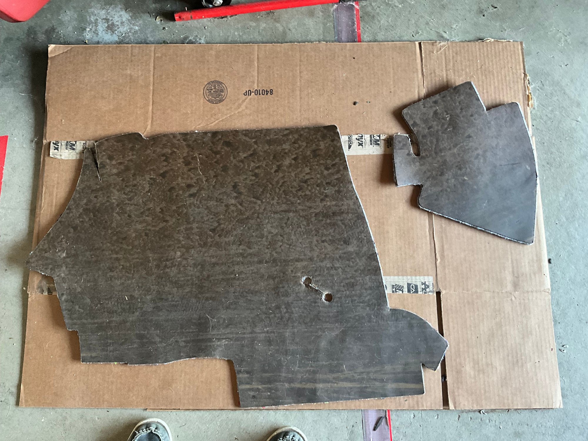

Anyone know how these fit in the rear compartment of a 1970 Coupe? Bought from Top Flight but they are not answering emails or phones. Thanks.

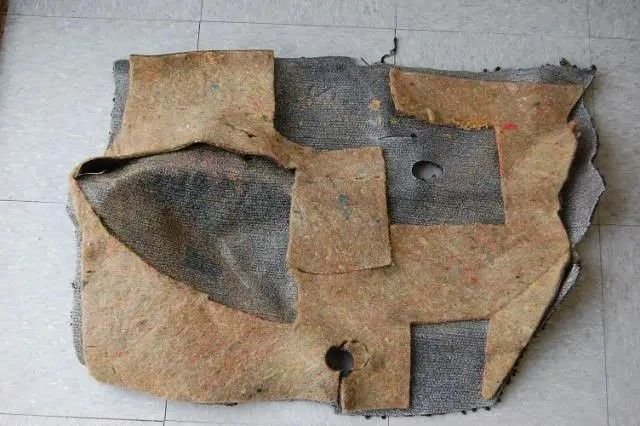

Does this help? Mine is a '69 Coupe

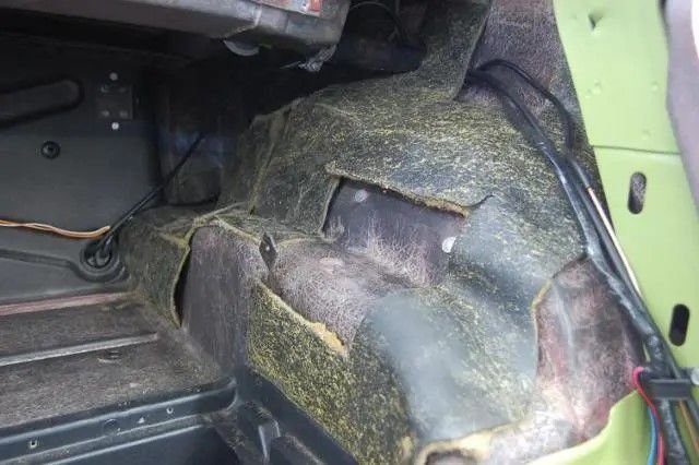

There should be two of the small pieces. One goes at the top of each of the rear wheel wells. Don't know what that large piece is for.

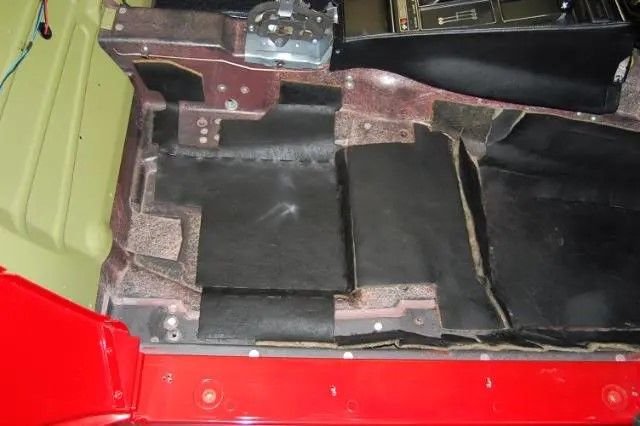

Alan had a few pics here.. might help in post 8
https://www.corvetteforum.com/forums...ew-carpet.html
and another thread here with pics..
https://www.corvetteforum.com/forums...tallation.html
personally i would use both.. why not.. unless under pedals.. where's waldo?

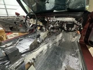

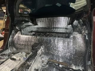

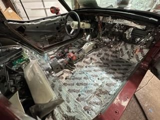

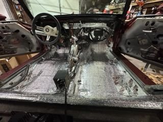

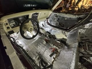

Jute def helps. Remember these cars new only had jute and were fine…only after 30 years is it a prob. I did kilamat .050, then vette nuts full foil insulation kit, then top flight jute with foil and then ACC new carpet with jute. Underside is foil backed fiberglass heat film. 2.5hr drive and didn’t feel anything in the car.
