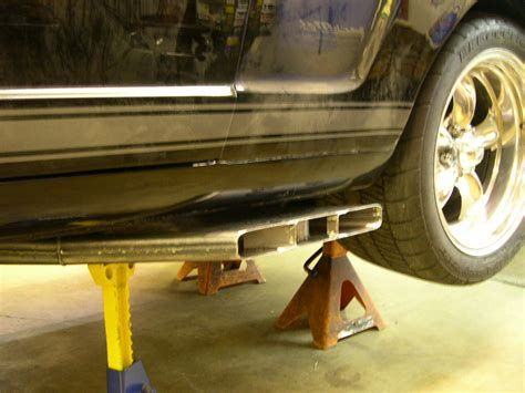

TBH it’s just that I want both. I already have a decent 3” system with a custom rear (see pic at top of the thread). If it was all about performance then I’d just stick with that. But I also want the side pipes! And I enjoy exploring “what if”. But I think it’s just too complicated, for now. So I’m just going to go for the side pipes and be happy with that.
