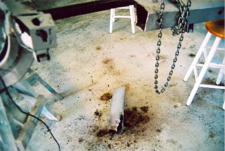

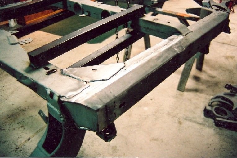

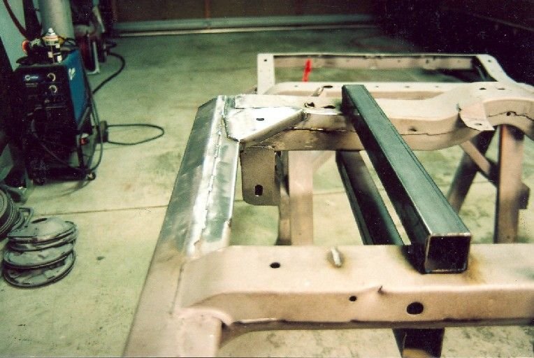

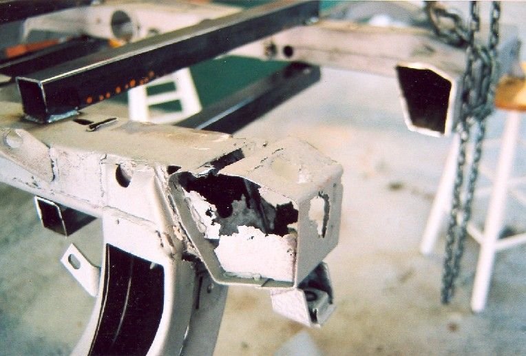

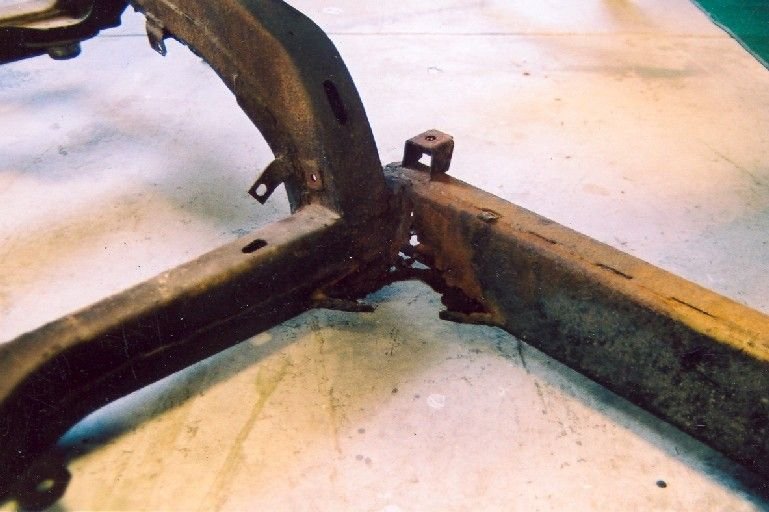

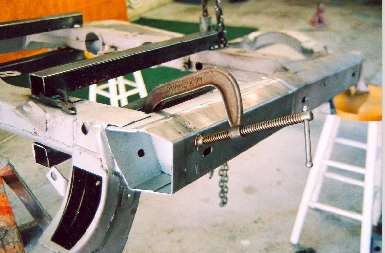

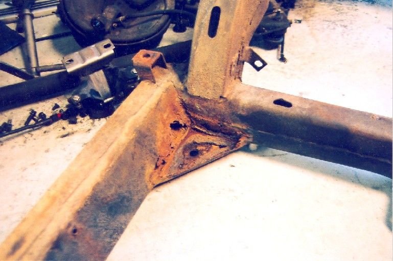

Yup, the only thing you do with rust is cut it out and weld in new material. Here is a typical Vette frame from a East Coast car I worked on, and this is what you do with it:
Cut it out, and weld in new material. There is no other option. You can buy new metal for all parts of the Corvette frame.
Lars
