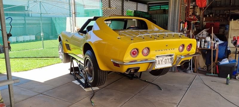

Joined: Oct 2010
Posts: 2,276
Likes: 337
From: "ɹǝpunuʍop", Adelaide, South Australia

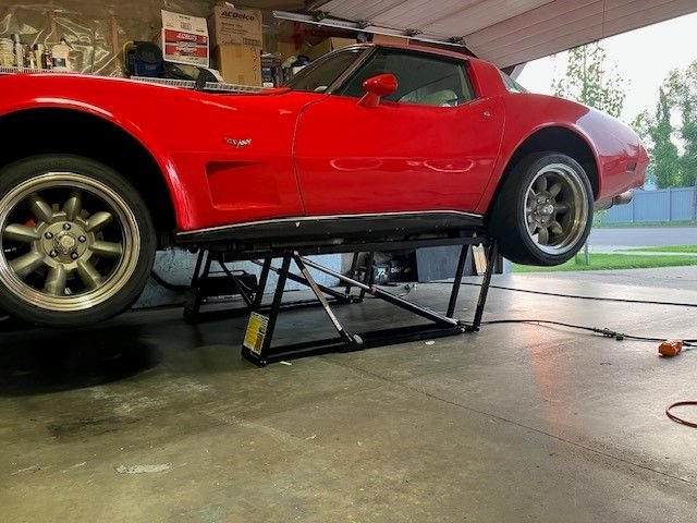

Had my 78 up on one for 6 months no problems. One of the best tools I have.

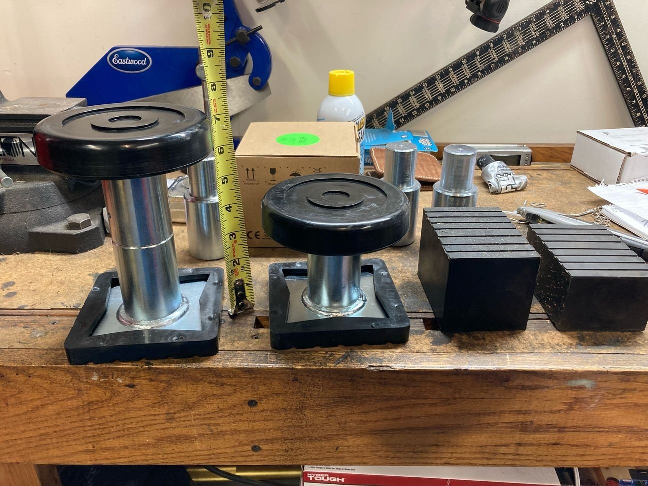

The TL is about 3" more lift which would be nice sometimes. Mines the older 5000SLX and I still wish I had bought it years earlier

I would only caution my experience with Quickjack.. which i love BTW.
i never double stack blocks.. they say you can i do NOT.. the c3 block placement barely fits as frame starts to dive inside, and when lifting anything off center will fling the blocks.. (ask how i know)..
better yet.. get the SUV kit.. use the half size one, this will gain even more clearance safely..and stiffer and as you say.. every inch counts..but safely
i can also say even with extensions i cannot use on my honda ridgeline.. too short at 62 inches.

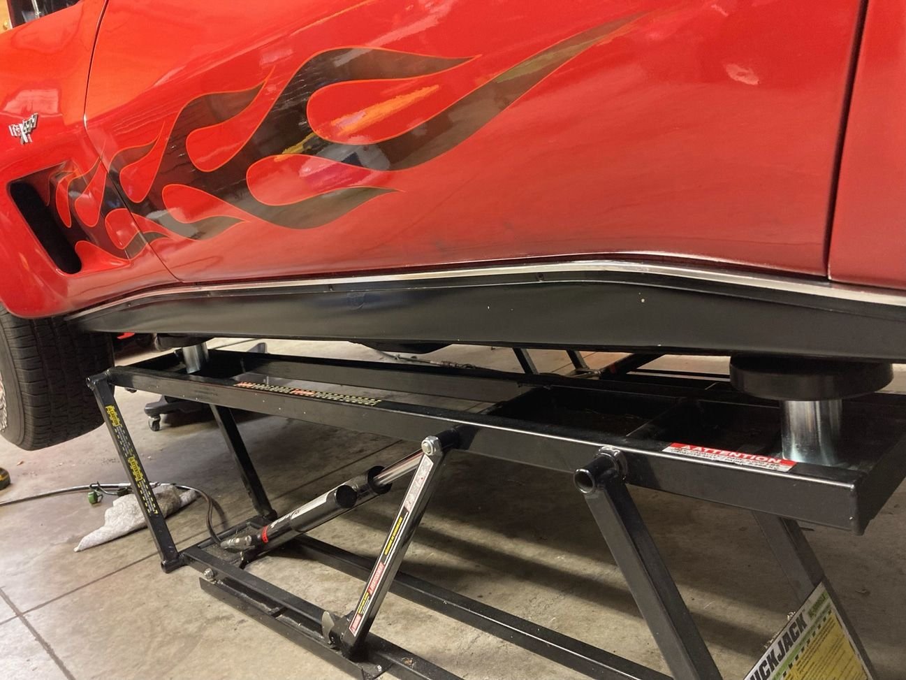

I love mine and service all my cars with the exception of my Toyota Tacoma. I bought it several years ago and have used it when pulling the engine on my 1970 ( big block ).
I moved and have a 4 post lift in my new garage but still use the quickjack on the lift to pull tires, suspension etc.

use existing jack points in manual.. you will need to put as far back as you can to catch the front frame before it dives in at the front.
not sure it matters which way you jack the car front or rear direction to last question..it will move slightly in the rear direction as it rises, so put a few inches from car to garage door if you want it to shut in air..

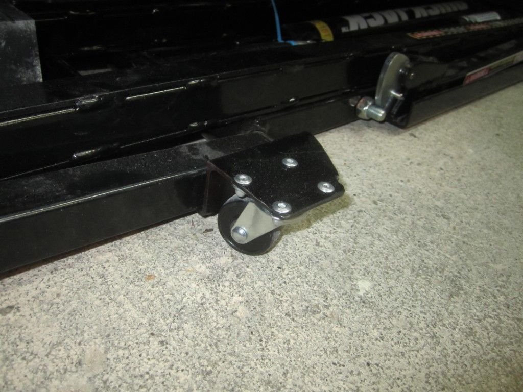

I got my wrist slapped before but I'll add that putting casters on the quickjack makes positioning it under the car / sliding it out of the way soooo much nicer than dragging it around on the floor.
M

As mentioned, try to get the rear pad as far back as you can on the frame rail and the front as back in the jackwell as you can, it's usually just where the frame starts curving inwards as mentioned above. It's easier if you are lifting in the direction where the car moves forward as it goes up. I've done it enough to know where the QJ has to be in relation to my rear tire both fore/aft and side to side. Then I look at the frame of the QJ compared to the rocker molding to make sure it's more or less straight to the car and up it goes.
Somethings to be aware of:
  • The rear tires will not slide outwards when you let the car down so it prevents the car from settling back down to ride height.
  • The car usually wont go back into exactly the same place where it was when you lift it... so don't be too close to the garage door, it might want to settle back an inch or so
  • Never double stack the rubber blocks, regardless of what QJ says, if you need more height, put a block of wood that's the size of the jack well on and then the large block or get a set of risers or make something.
Now one more thing... if you are jacking the car up and the rear of the jack frame touches the rear tire, not much but a little... and you remove the wheel for say doing the brakes or something. It's entirely possible you won't be able to put the wheel back onto the hub because the frame is now in the way... and you can't let the car down to move the frame because the tires aren't on.
Makes for a real head-scratcher. Just saying
