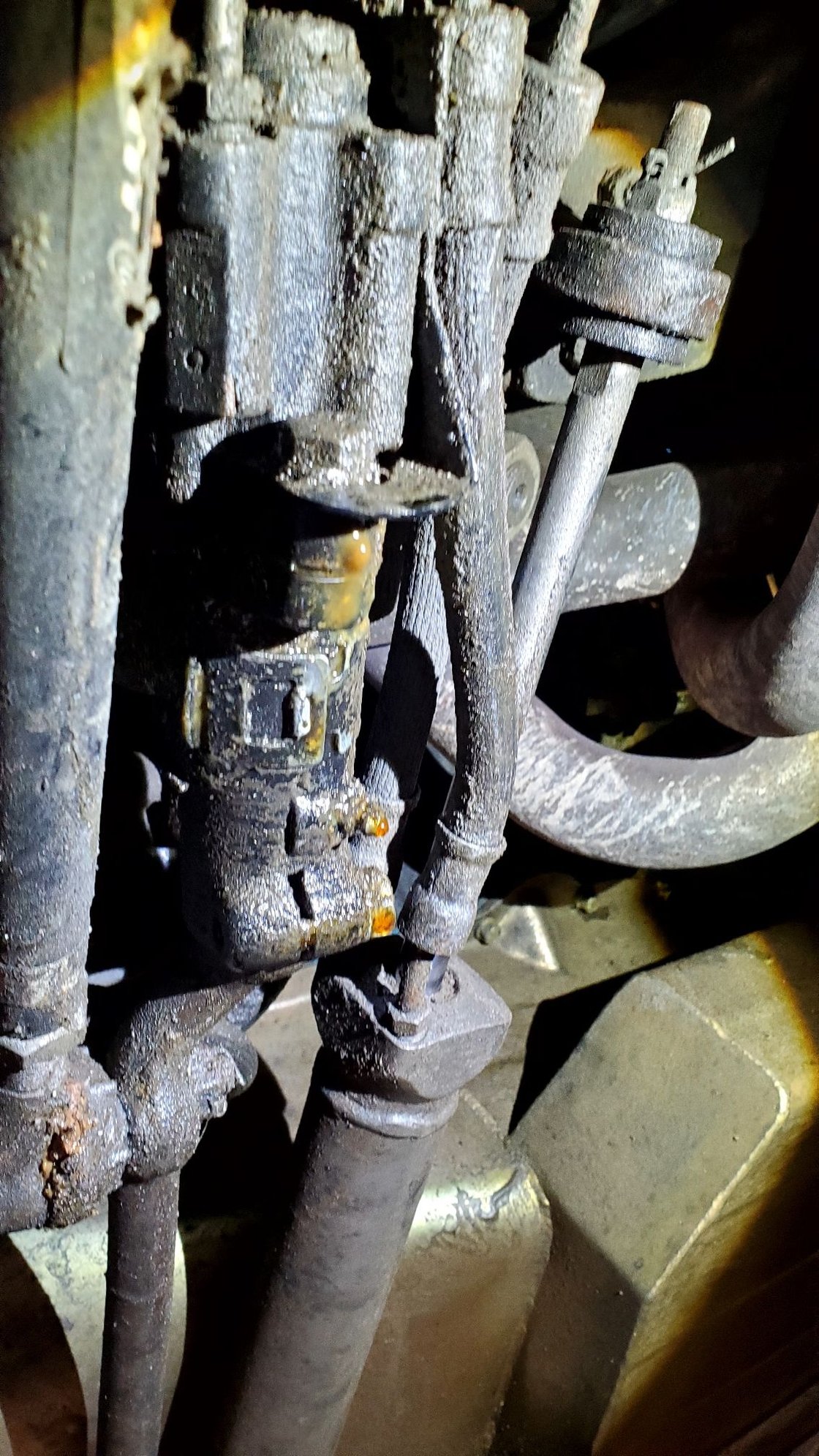

Took the car to Summit Point to do a HPDE. When I came home, I found fluid on the floor of my car trailer.
I went under to take a look. It seems to be the Power Steering Control Valve is leaking. I confirmed when looking in the Power steering unit and it was dry.
The one leaking was from Vette Brakes. Anyone know where I can get a NON-Chinese replacement?
