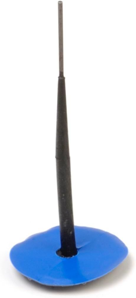

For a visual. You prep and patch the tire from the inside, but pull the long part thru the hole. This not only plugs the air chamber, but also the hole, to prevent steel belt rust.
I think or I hope THIS picture clears up any procedural doubts you had.

Yes it does. Thanks all.
I'll know know what to ask for.
