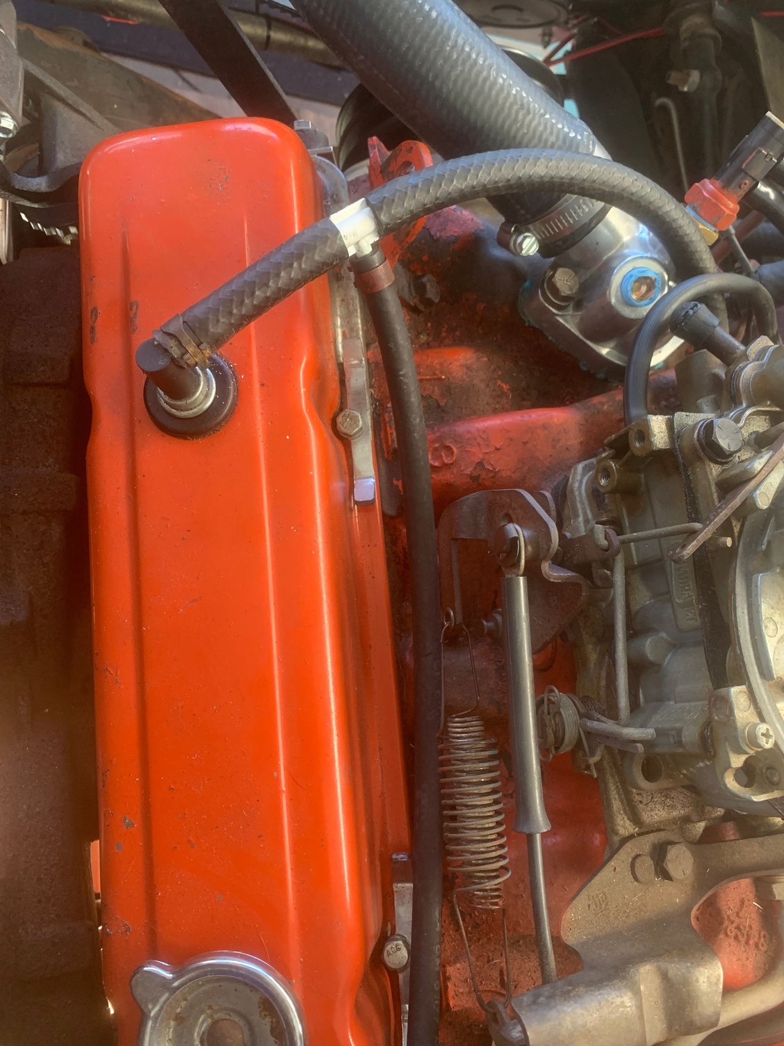

All right. Got my PCV line T’d with the Evap line. How does it look?

Perfect

No where near the factory configuration, BUT I think it will work, sure looks like a simpler way to do it..
Which brings up a question of why the factory set up has a vacuum controlled valve that has to have vacuum applied before
vapors are removed from the evap canister.

First run with this configuration of vent for the Evap via PCV.
First, the raw fuel smell is gone.
A cold engine cranked right up, idled in the 1500 range until the choke settled. Engine then ran smooth and idled great.
Cost = about $1 or less for the T.
Time = about 15 mins.

No I meant the small plastic valve (purge valve) located on the canister on drivers inner fender, I don't think it's temperature controlled/related at all, just a port in the carb, no other devices
the way he has it (T) into the PCV would pull all the time, which I guess would work, vapors build in tank, escape to charcoal canister until start up, purge gets vacuum = opens, pulls vapors into engine

It would be best to look at the emissions hose diagram for his year, if it's a direct connection it has constant vacuum.
