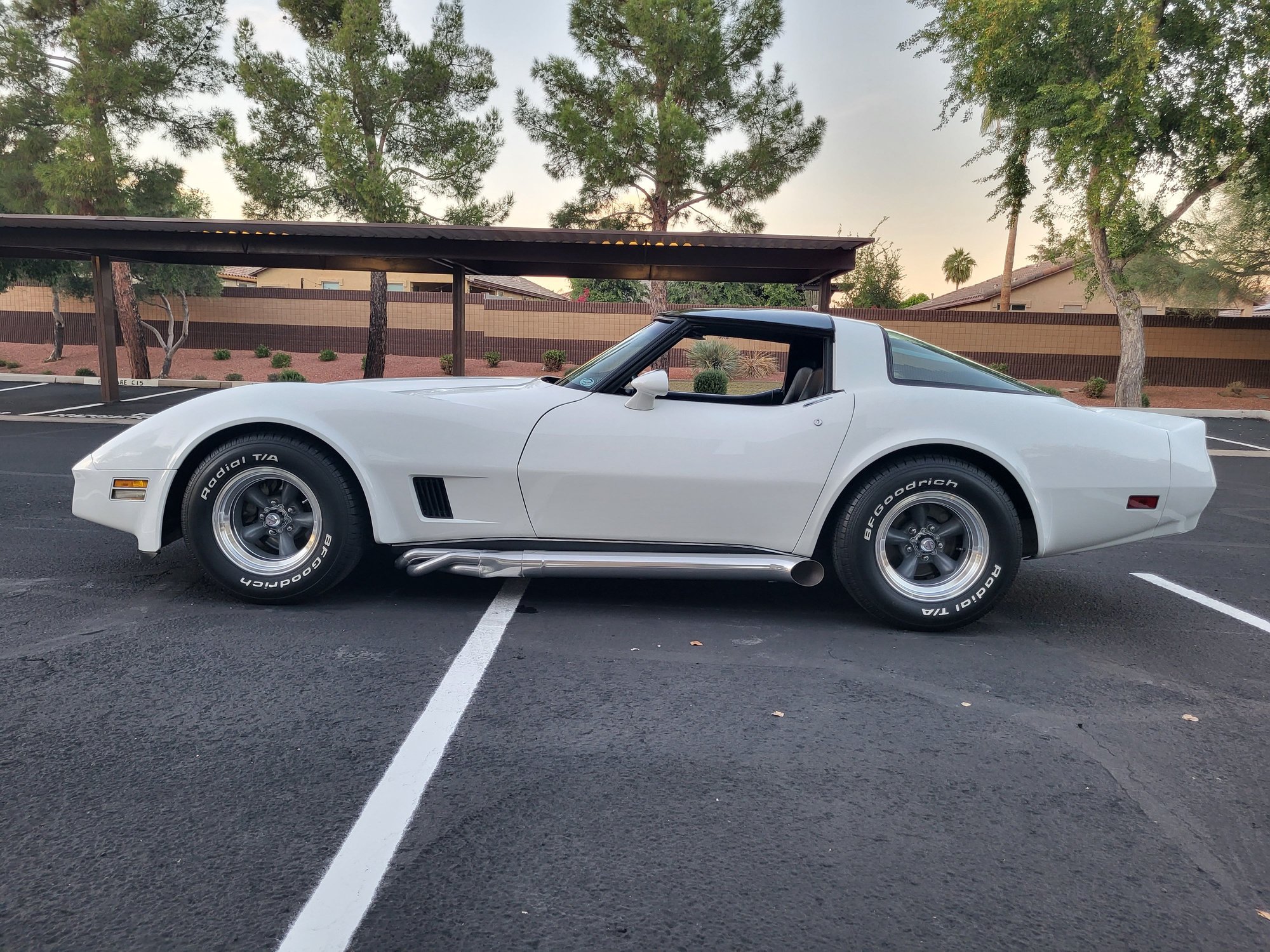

Okay my 1980 money pit seems to be sagging a little on the driver side. I took everything off to see if it had been clocked wrong and it was by about 1.5 inches; however, upon further observation it still seems to be bunching a little at the bottom of spring. Coils are a little closer together as it hits the bottom. At first I thought nothing about it but then I realized I converted almost everything from the cam up to aluminum, so I might have lightened up the car about 70lbs, so if anything the coils should be more open like the passenger side. Anyway thanks to some good info here in the forum(Leigh's, 4-vette's and some other threads), I was able to take the front spring off with not too much hassle. I will admit it was a little scary, but you all know how it is when you want something right you set your sights and go. My question is my car seems to have a pretty big gap on both sides regardless of one being lower than the other. I approximate about 2.5-3 inches in between tire and fender. What spring do you all recommend to bring this gap down to at least 1-1.5 inches? I have looked at all the Corvette online stores and some say they are easier to install but that the ride height shouldn't be affected. Any recommendations, all my other suspension accessories are MOOG. I would really like to just put the springs in once and forget about it, but I guess if I have to cut a coil so be it. I don't want to change rear leaf spring at the present time so I would like to stay with a spring of less than 460lbs. if possible.
Thanks in advance for your help.

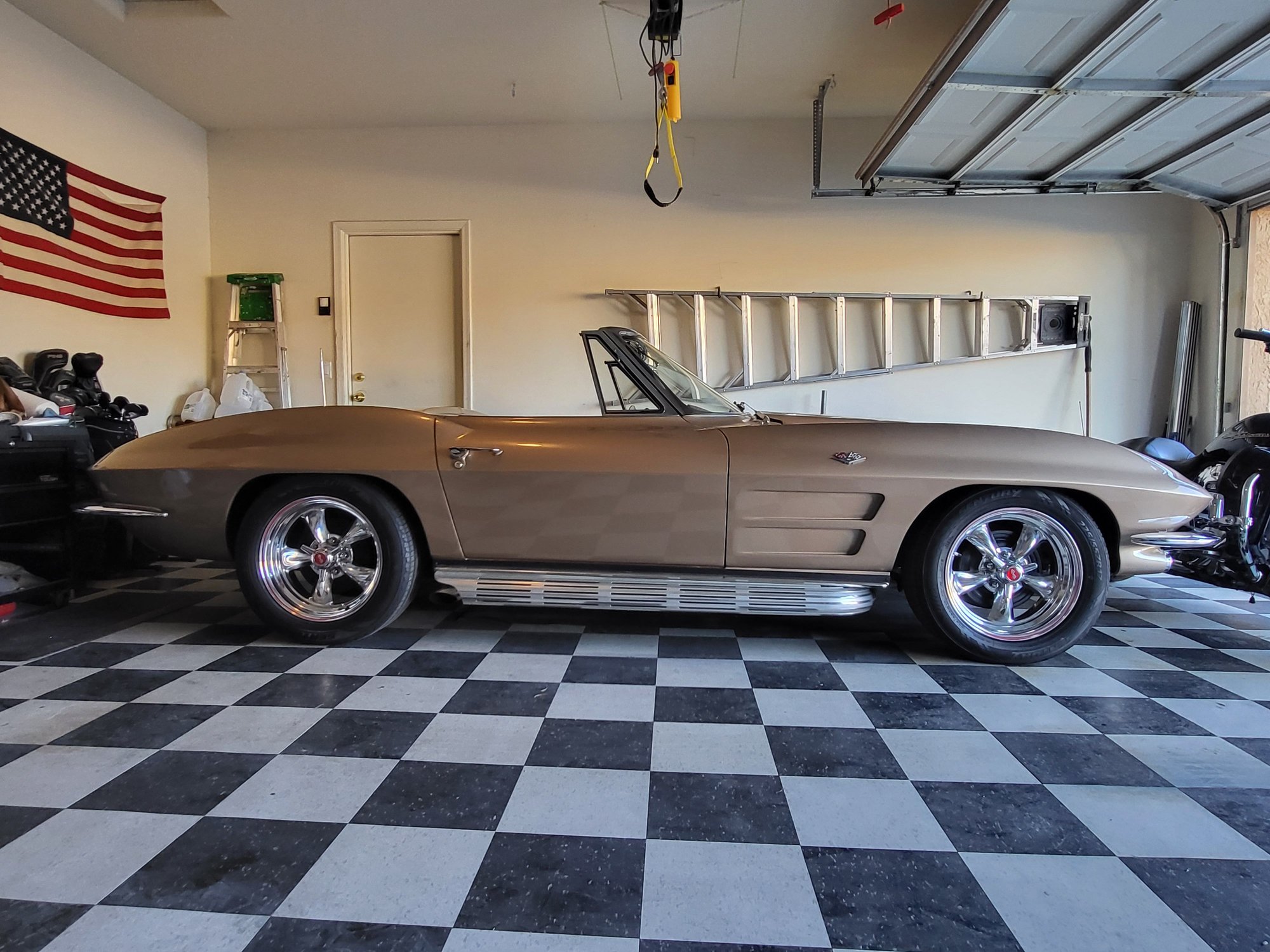

I’ve been very happy with the ride height and ride quality of these Hyperco dual-rate(480-700) springs from Ridetech. Advertised to lower 2”, but mine went down 1”. Good ride height for me; can be cut as well; optional spacers for less change. Paired with 330 rear composite spring; also would be good with 360. The 550 coils I put on my other Vette resulted in the same 1” lowering, cost half as much, but ride is rougher. Side-to-side leaning in corners and quick lane changes greatly reduced; reduced even more with 18” wheels. Pictured with same as original 27” diameter tires. Interestingly, manufacturer’s instructions mention springs can be mounted with either end up.
Charlie

I went ahead and ordered the #460 that supposedly drop it 1". I am going to go ahead and install them that way and drive for about a month. Then go back if I have to and cut a coil.

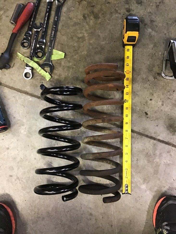

Just a FYI. Back in 2017 this was the result of the Corvette Central 460 lb. not cut. This is with aluminum heads and intake without A/C. I was not happy. And yes, springs were indexed correctly.
CC 460lb. spring with 1 1/2 coil cut.
Dorman 474lb. with 1/2 coil cut. Stock Rallye wheel/tire and 17" TT wheel/tire both have 27" diameter.

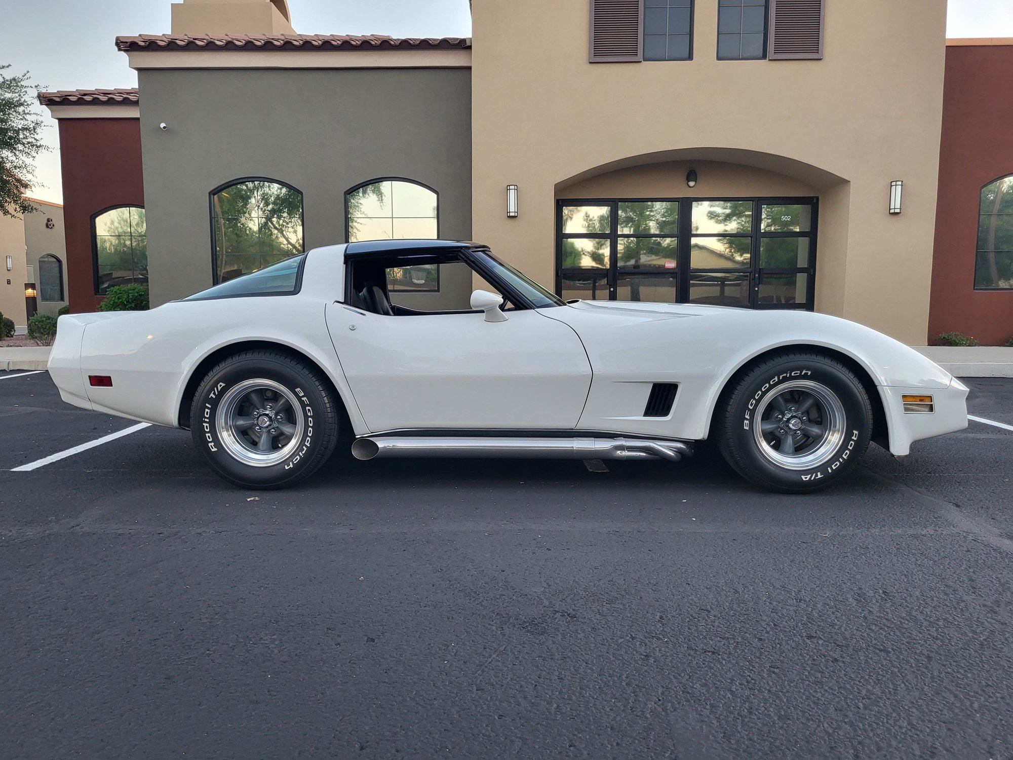

So you think right of the bat it is going to be high. My car also has aluminum heads, intake, headers instead of exhaust manifolds, and no smog stuff. I also got rid off clutch fan and shroud. Has electric fans for now. I am tempted to cut at least 1" from the start.
I use the rule of thumb half the spring hight cut gives twice full height drop... 1/2" spring hight cut give 1" lowering
this is 3/4 coil cut (.75" spring height cut) gave 1.5" drop
