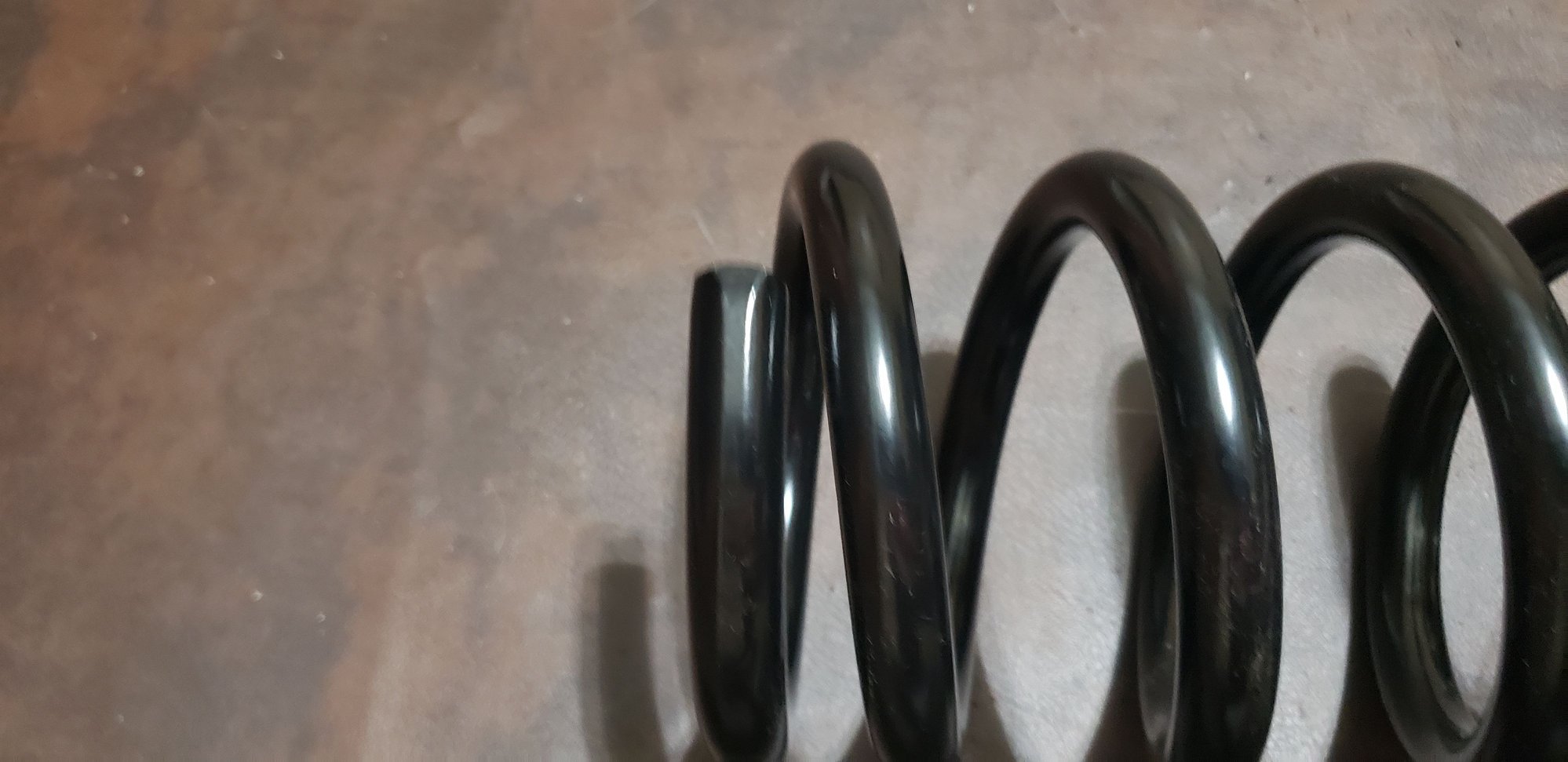

Okay guys looking at these coils, which side would you think to be the top?
This side has some indents in it, like where the machine that made them grabbed it.

  #34
sunflower 1972's Avatar
sunflower 1972
Joined: Sep 2016
Posts: 2,230
Likes: 984
From: Wauconda IL
Doesn't make a difference. Pick an end and go!

Old Nov 13, 2023 | 09:27 PM
  #36
OMF's Avatar
OMF
Joined: Jul 2006
Posts: 2,291
Likes: 493
From: Salmon Arm, BC
If the coils were tighter at one end that would be the top side, but yours look evenly spaced so either end will do. Be sure to locate the coil end between the two small holes at the top for correct "clocking" of the spring.

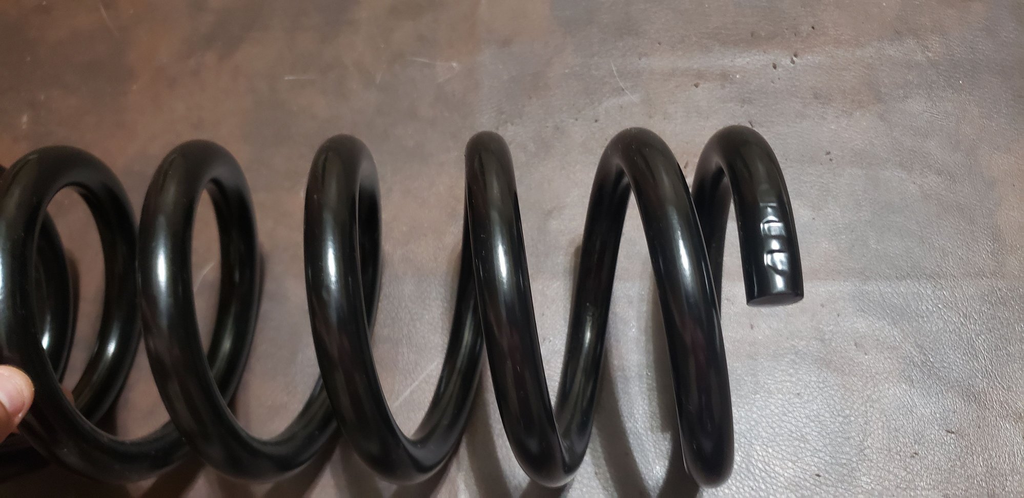

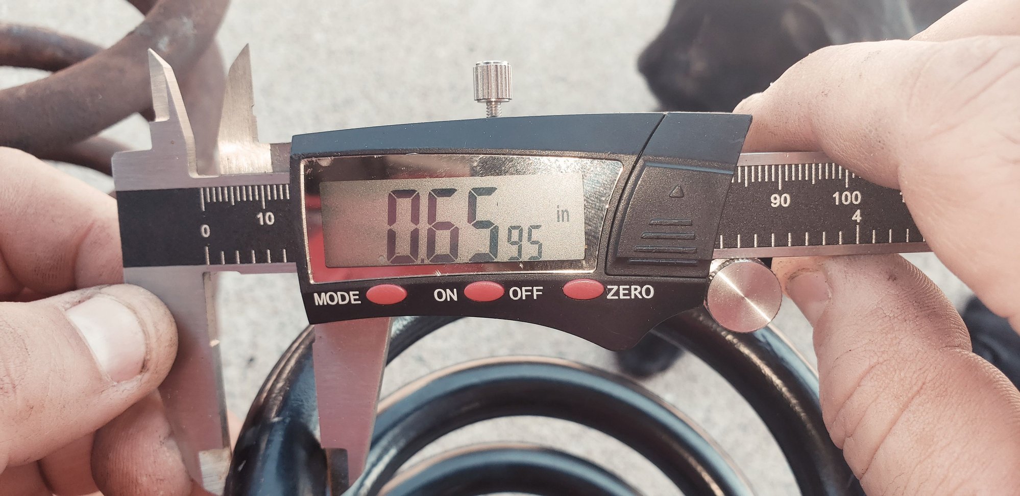

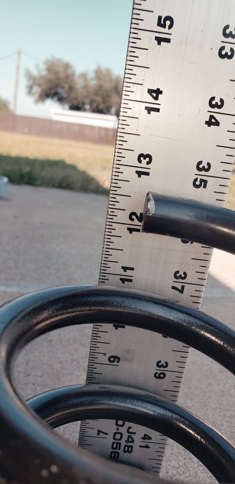

A little bit of an update. I haven't finished yet because I ran into a caliper that was leaking so I ordered some replacement parts.

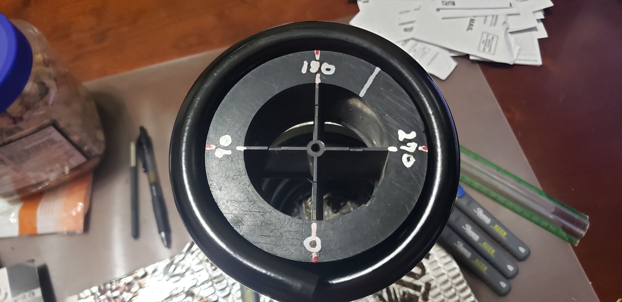

Found this little wire spool and put some degree marks on it. Zero is the beginning of the coil.
After getting info from several people here on this tread, I decided to cut a little past the 180 mark and not to the 3/4 point. So the first red line after the 180 mark.
Originally this spring was 13". After the cut it came down to approximately 12.65"

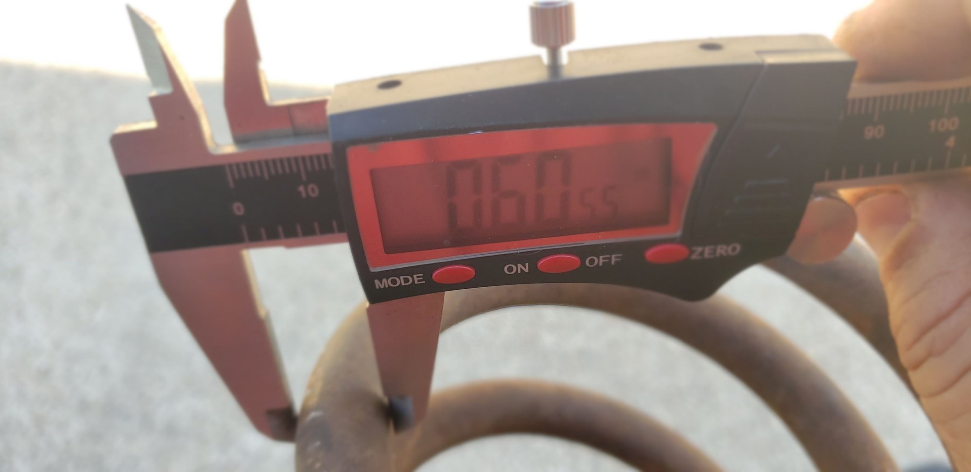

The overall thickness of the new spring measured the following.
The Original spring that came out of the car was about 15.25".
The thickness of the old spring was about .60

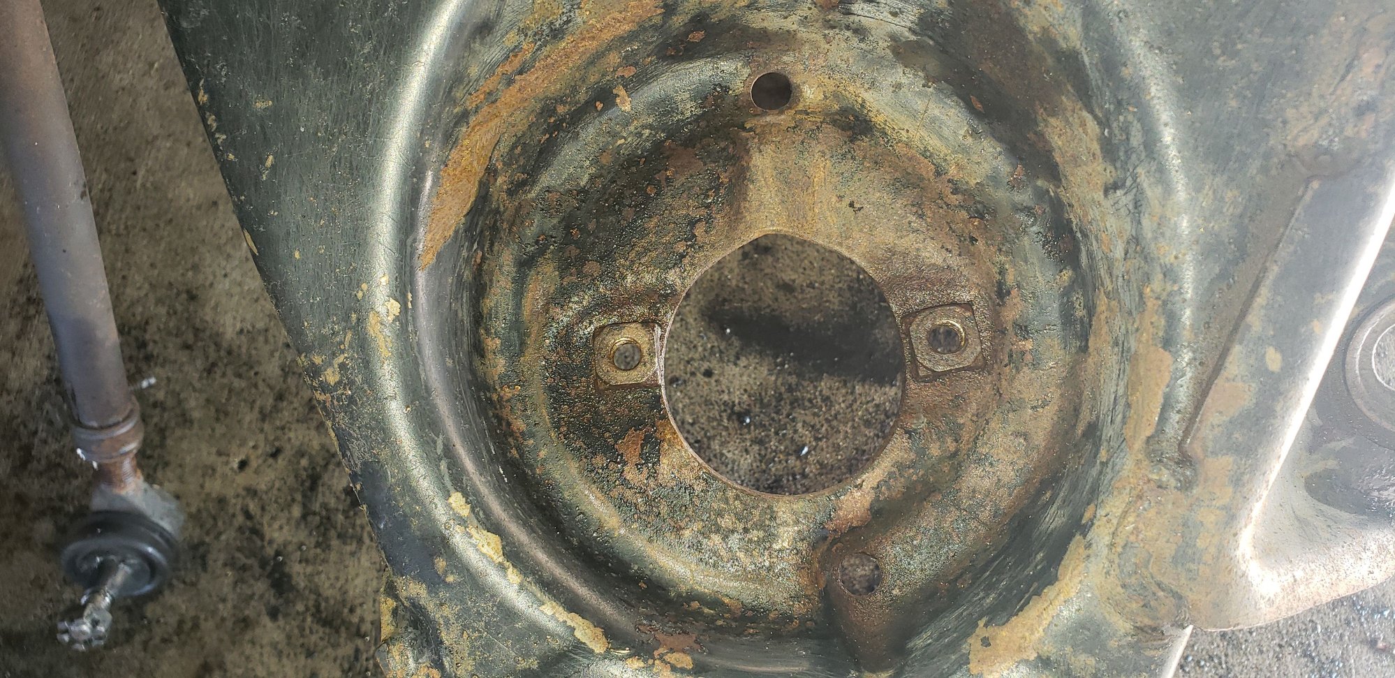

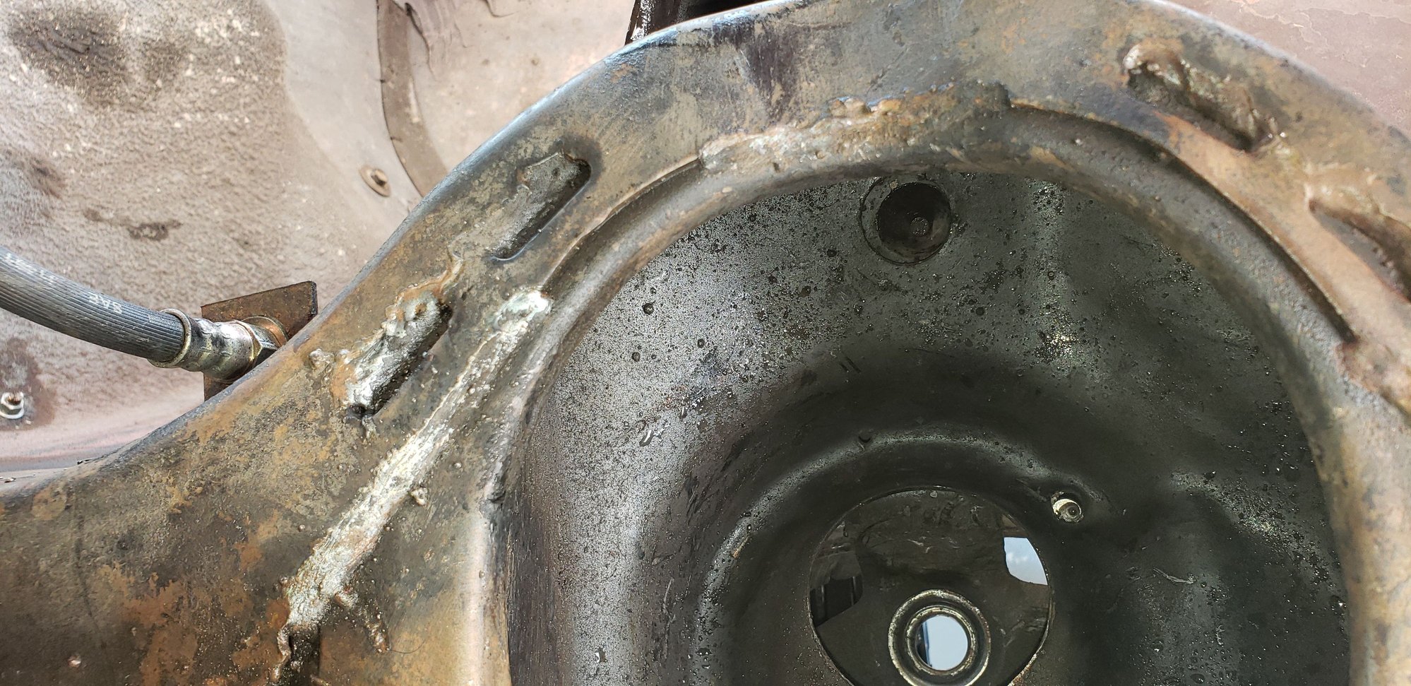

I also noticed why people want to index spring from the bottom. It seems there is a slot on the bottom where the spring drops.
The top part has one as well. Well after cutting the top part of the new coil, the top part of the spring was indexed properly but the bottom extended a little past the drop point. This was going to happen regardless of whether I cut it or not. For this not to happen, I would have to have cut the bottom one as well, but then it would have dropped more.
Later this week after I bleed all the brakes, I will get you the overall height of fender and the clearance between front tire to fender.
I think it is pretty obvious that the top pic is the top......it is flatter and tighter to the coil.
Also...the uncompressed length of a coil spring doesn't mean a thing here.......50 years of manufacturing difference, materials.....machine process could have a spring that is much longer or shorter out of the box.....it is when compressed is what matters....what it does under weight.....
Jebby
