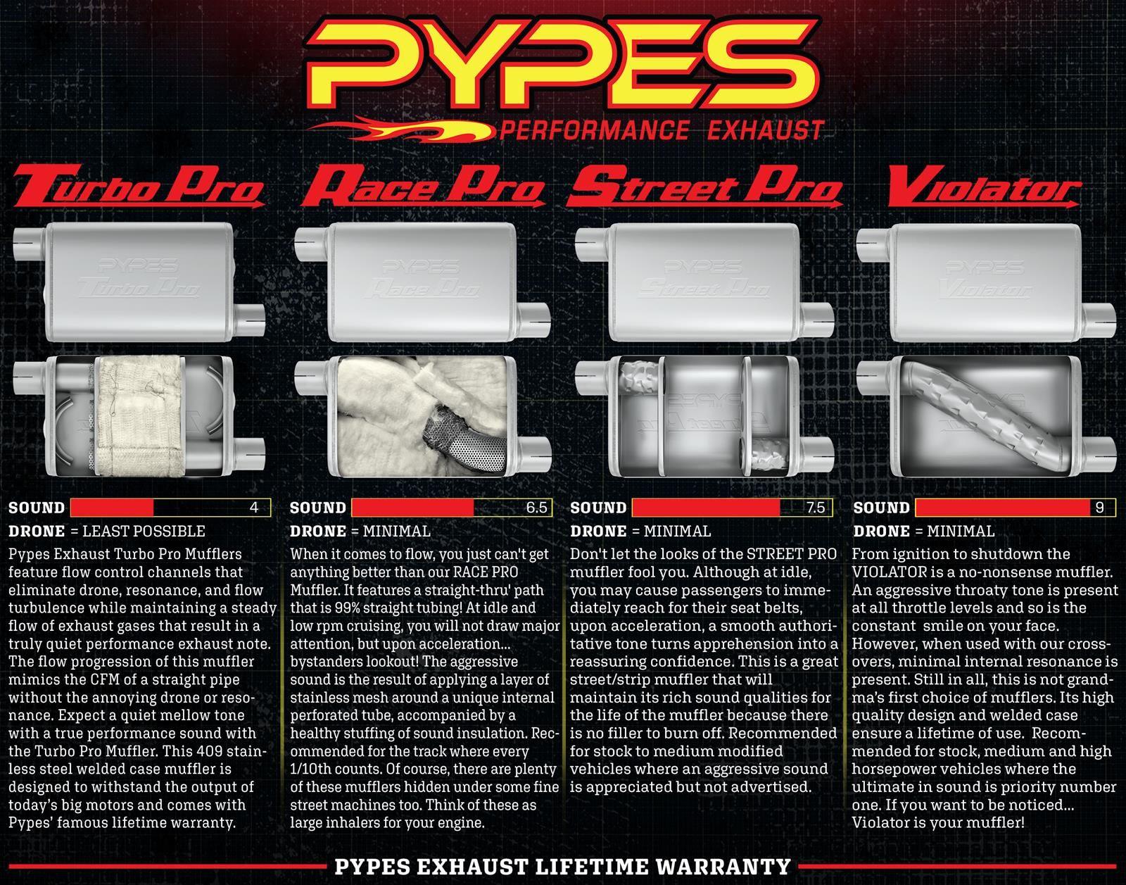

It will depend on the type of muffler, but typically, yes, the same size pipe will be used internally. How it is used, though, will vary.
Here's but one example of different configurations.
