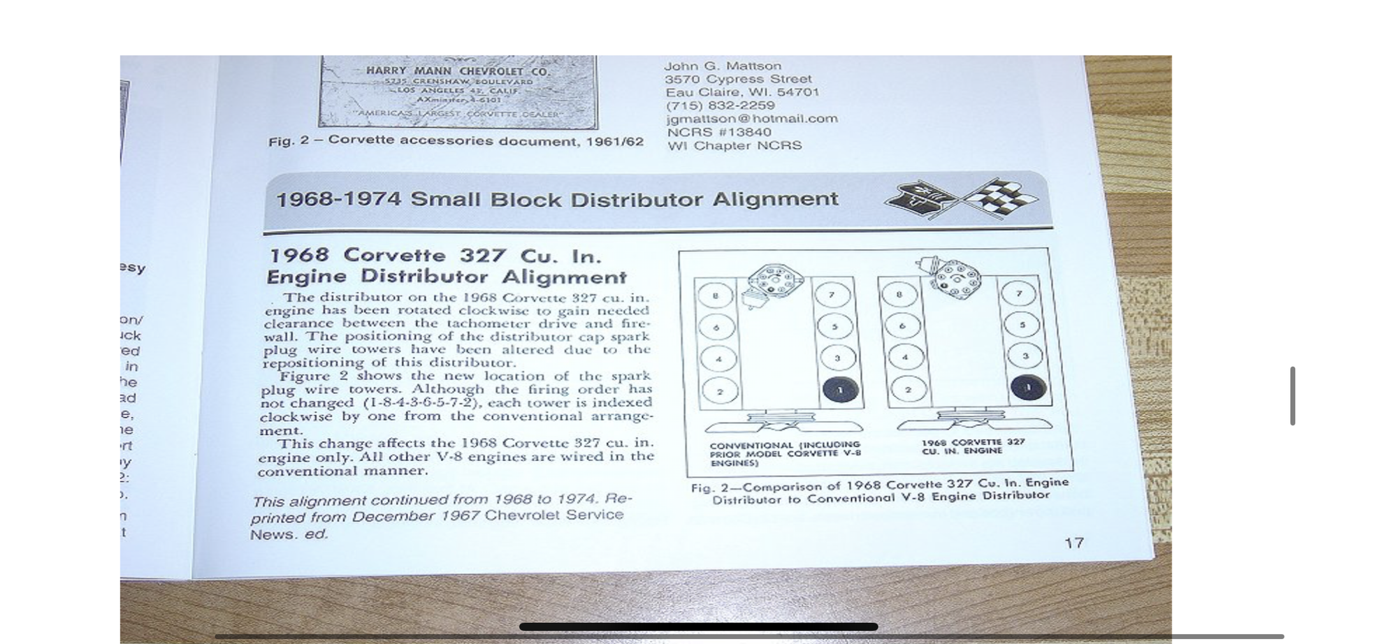

Ok I found “an issue” and now so far it’s looking like it could’ve been “the issue” because it’s running perfect now.
Turns out it was an issue caused by the distributor being reclocked. The factory installation has the tach drive facing the firewall and the vacuum advance can facing forward.
Once it’s been reclocked as this one was the tach drive faces the drivers side fender and the vacuum advance faces the passenger side fender.
This was done by the prior owner and what I wasn’t aware of was that the vacuum hose to the vacuum advance was contacting and rubbing on the ignition shielding box which wore a nice slice in the hose. That caused a vacuum leak and most definitely prevented the vacuum advance from operating properly. Pulled like a bear anyway.
Above where the hose was I modified that small area of the boxes bottom edge. I used a cutoff wheel and then a Dremel to round it out and finish it neatly making a cutout in the bottom of the box to give clearance for the vacuum line. It blends nicely into the box, doesn’t look butchered.
The car idles perfect at all times now.
