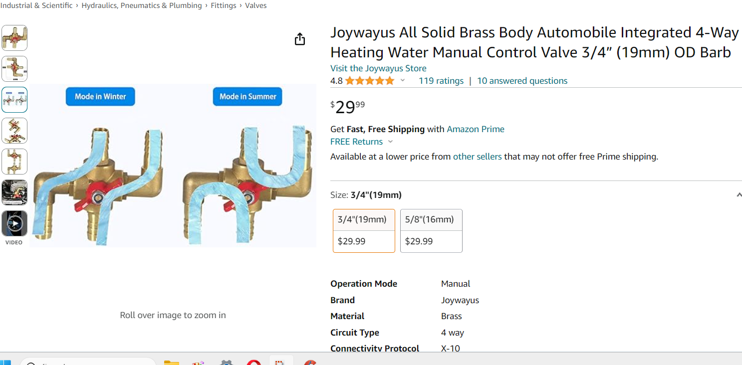

It sounds like you need more flow via that heater flowpath. You can buy a diverter valve that will isolate your heater but still allow recirc flow. Or buy manual valves and make your own. It is easy enough to do and you'll find out quickly if the problem is related to that.
Here you go. For 30 bucks you can find out if it is something along those lines.
