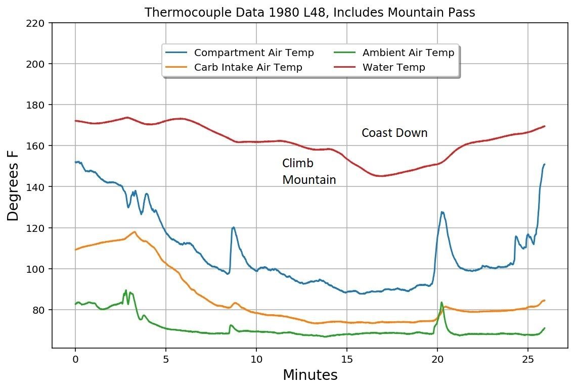

Looking forward to seeing photos, and seeing your temperature measurements confirmed with an IR gun or some other method.
Here's a run I did using an Arduino with 4 thermocouples. The "water temp" channel was taped to the outside of the upper radiator hose. Insulated, but still in the engine compartment, so that may account for some of the low temps. The rest could be from the tiny holes in the 180 degree thermostat. At any rate, my cooling fans (195/185) never came on during this run.
