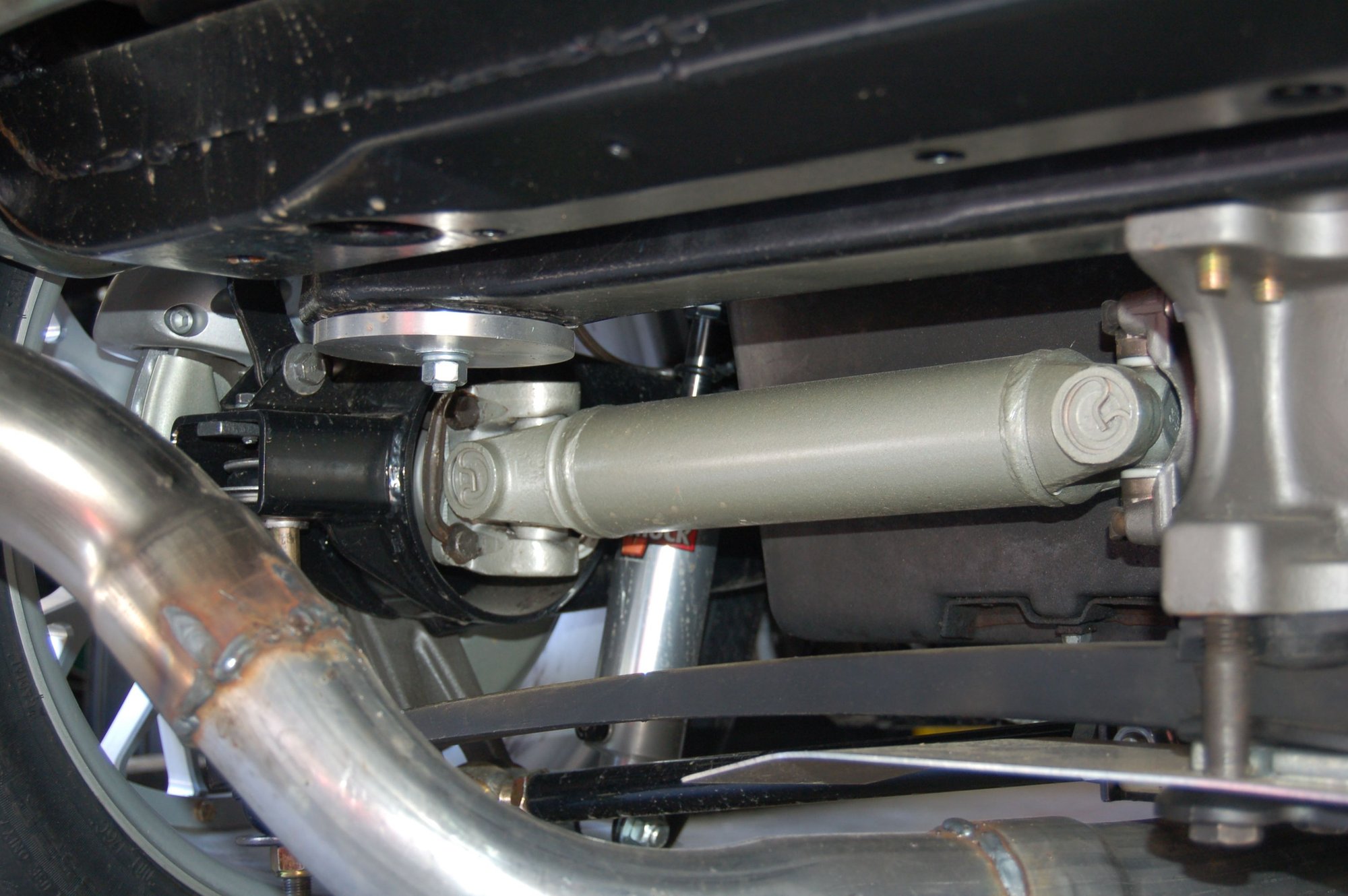

As to the differential mounting, if you want to go completely hard core, here's what's in the Chevy Power guide. A bit too harsh for me. As to why, I suppose this eliminates any compliance change with the chassis that affects wheel alignment. That's about all I can come up with.

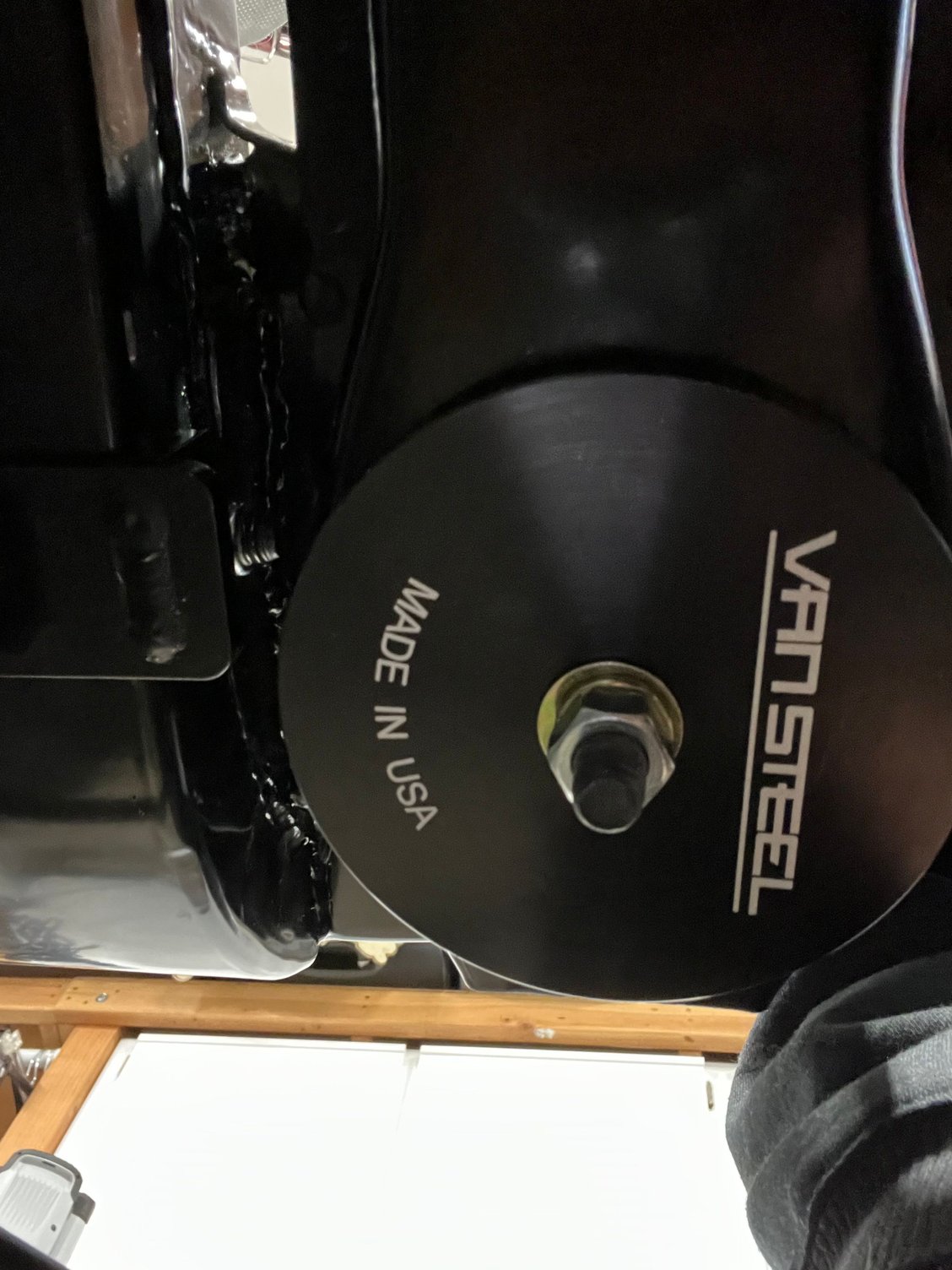

On the Van Steel Delrin bushing kit it replaces the rubber crossmember bushings for Delrin bushings, then an aluminum plate is installed once the crossmember is installed.

Love the heat shield under the composite spring.

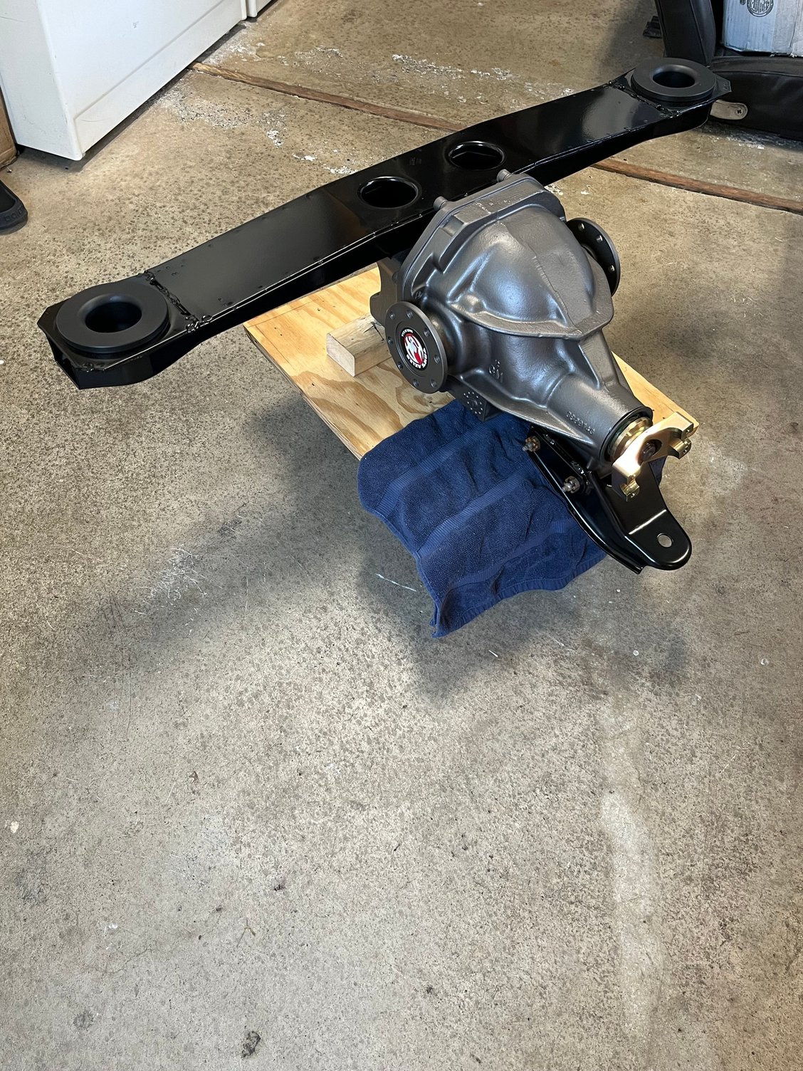

That bushing also helps with driveline alignment. I think I recall you are swapping in a 5 speed. When you drop the new powertrain in the chassis, be sure to make sure your driveline angles are aligned. Cutting that puck down is one way of changing the diff angle to get it right. I know after I hard mounted my rear crossmember and swapped in the TKO I had to adjust the thickness to get the alignment correct. You may or may not need to do this. Usually just depends on how many changes you make, each change takes something a little further from design time...
Pics look great though, nice work!
Just a note: When you go to the aluminum disk ends depending on which kit the gain is also raising the differential mounting point by up to 1/2 inch. I posted pictures years ago about modding the rear snubber bracket mounting bolt hole. Mine is higher to allow the front snubber mounting to go up. I use an aluminum shim disk that I made to make the differential as ridged as possible. A CF member by the name of 66impala or something like that from Placer Ville lake California actually did cutting and channeling the rear differential cross member mounting point even higher.
Correct, the kit does raise the crossmember up into the frame.
The shorter Delrin cushion allows the snubber bracket to be mounted up and closer to the frame mounting point.
