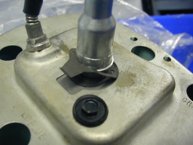

trying to remove it but limited space ofcourse, how do u disconnect speedometer cable?

Hard to describe without a picture but here goes: There should be a very thin metal catch surrounding the cable that sort of bends away from the speedo housing. Depress this catch towards the housing and pull the cable out of the housing.
Bonus points if you can do it one-handed.

When you press the tab have a helper pull from under the hood.

depends on the year, the early chrome bumper cars screw in just to enlighten those that read this later
Must be earlier than ‘71, mine has the clip.

While pressing clip with your thumb. Pull on cable housing with your remaining 4 fingers.
Can't describe it any better. Done it that many times.
Basically pulling your hand away from your thumb while pushing your thumb.

Whats that short cable that comes out from the rear of the spdometr

Trip reset...
Your bracket may or may not be the same.

I’ll be darn I had no idea what that bracket was for now I know thank you very much
