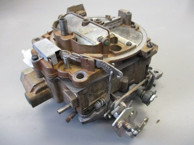

Can anyone tell me what this part number and date code translates to on my carburetor? I know it's not correct for my 68 327/300 auto but would like to know exactly what I have. The reason is I am hoping it might be worthy to somebody as I am hoping to acquire the correct carb and hoping I could swap this one for it or sell it and use the cash for the right one. I have searched the internet as well as the NCRS manual and can't say for sure the exact details. The 70... number seems OK as a 69 carb but the number below it I can't quite figure out. The carb I do want is 7028208 DB for a car made in late June. Thanks.

The carb shown is a commercially rebuilt carb, sandblasted and hacked, that has some funny stampings on it. Notice how the "9" is smaller than the other numbers, and it's missing the assembly plant code letters. The number itself is indicative of a 1969 Hi Perf carb, but the date code shows a 1967 or 1977 build date. If I were looking for a carb, I wouldn't buy that one...

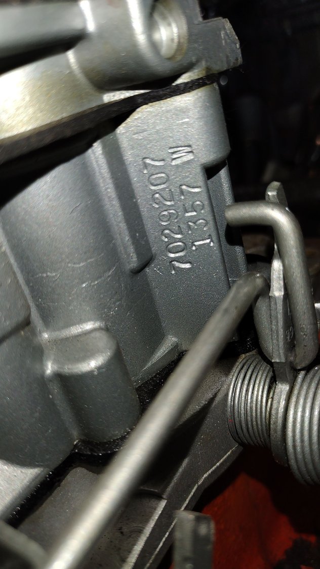

This is a correct "SR" (Service Replacement) 7029207 carb with the correct, original (but worn...) colors, coatings, and stampings for an SR carb built in 1973:
