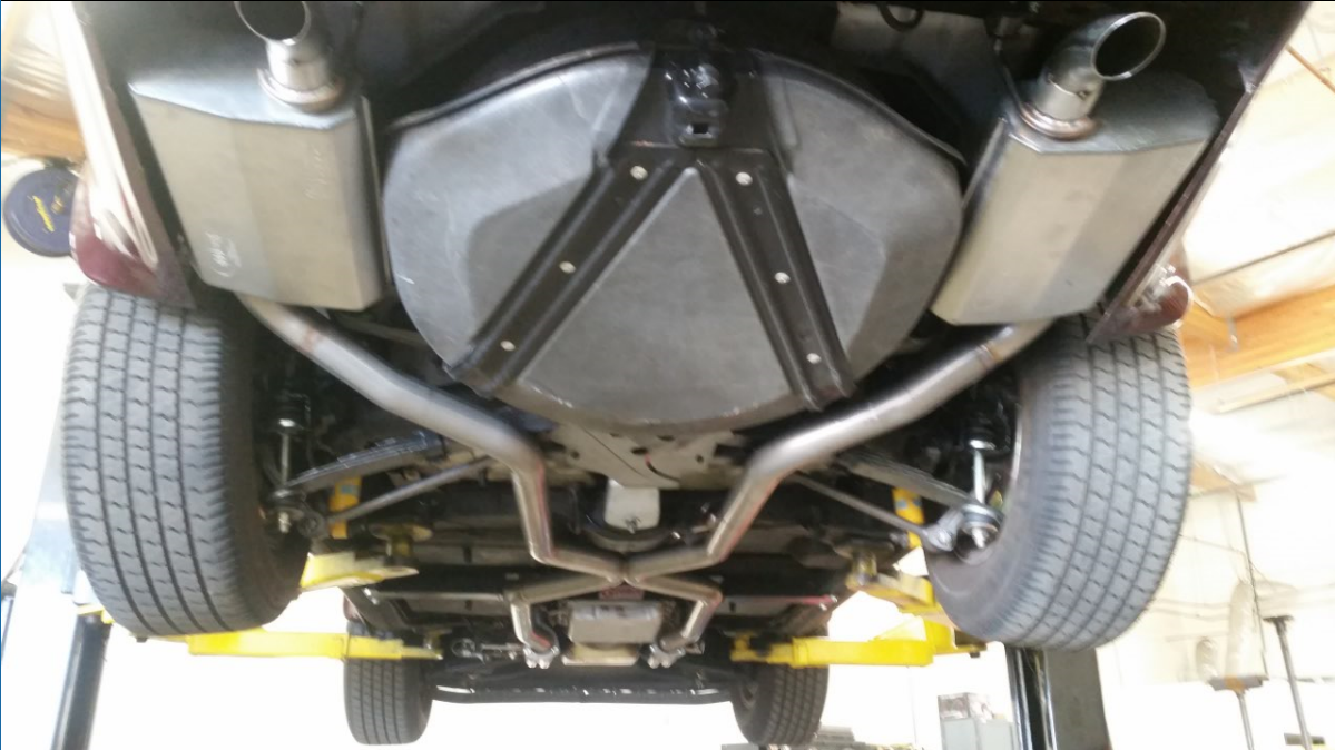

If you just want to do some true dual exhaust system on your 82 with 1 5/8" headers, you can go this route and works just fine, including the crossmember from G-Force. Direct bolt in. Here is what I did on my 82. Hooker max flow mufflers also. The way I did the exhaust, I can install or remove it by myself as one piece in 15-20 minutes. All SS tubes. As far as side pipes go, I have thought about installing side pipes on mine, but they would be flat or matt finish to blend with the rocker panel and a C3 has to sit low for it to work with side pipes IMO. An *** high C3 looks horrible with side pipes. My car sits level and low.

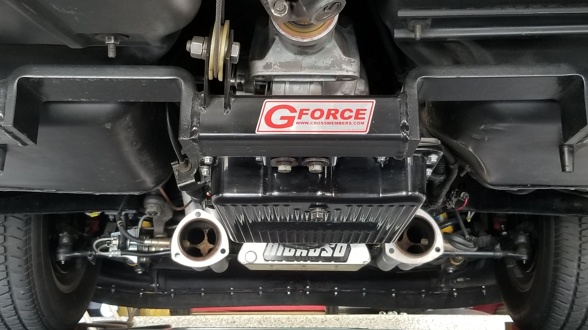

I have the same GForce crossmember and it is a quality part.

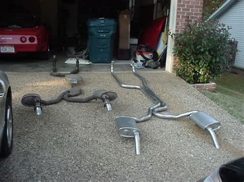

Tru Duals for the '80 next to the OEM exhaust.
Ran this setup for years. Added an H-pipe where the pipes came close together. Worked very well.

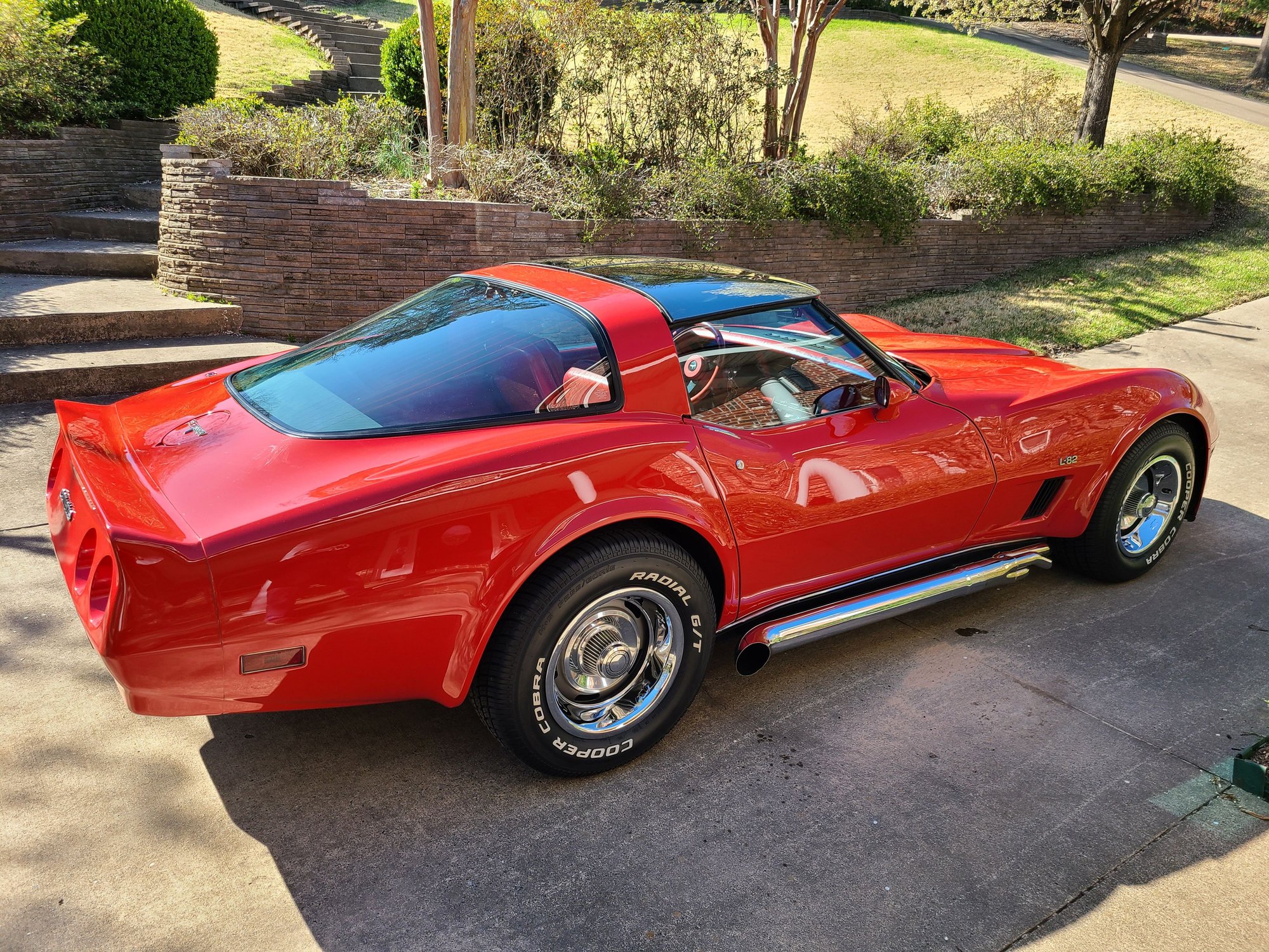

Made a few changes....Put Dougs side pipes on with with Vettepacks inserts for my new 383. Lots of positive comments.

Looks awesome. What size pipes did you run? Are the 2 1/2" or 3"? I saw a kit from CC that's a 2 1/2 and driver side crosses over for the crossmember. You did not have issue with the driver side electric seat?
