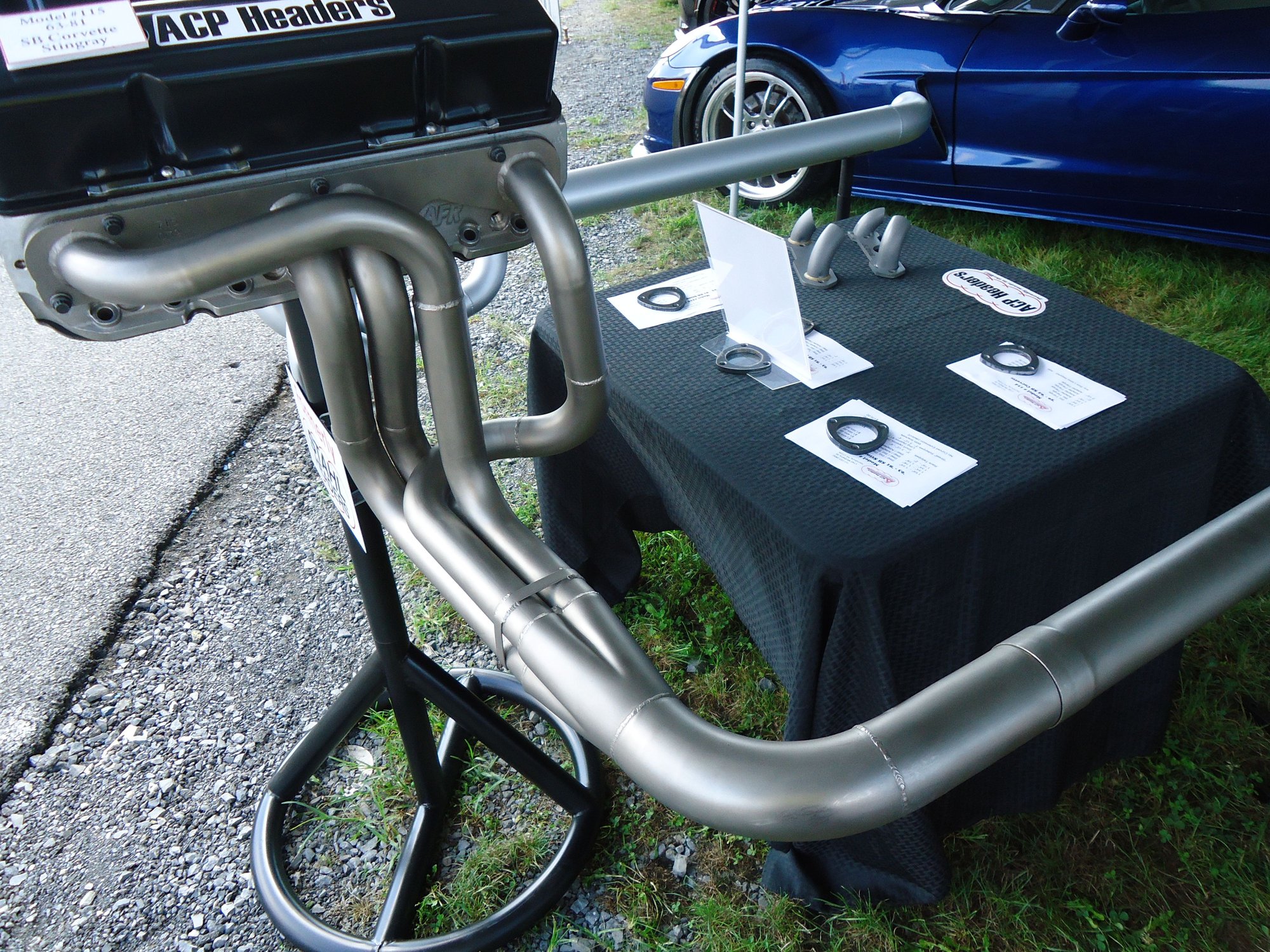

If you want the best, Stahl/ACP side exits.
If you notice....the collector is way up by the header tubes......this is where scavenging is most effective......the Hooker style sidepipes look cool as hell, but the collector is way out behind the front wheel and makes the header tubes too long to boot.......there is some pulse tuning but way too weak to be effective......
Jebby

Sure, but by staying at 2" as they pass under the frame rail, the Hooker-style sidepipes give you more ground clearance. I can go over speed bumps with mine. How well do those ACP headers fit?
There is an Engine Masters episode, now behind a paywall, that shows the advantages of X-pipes. So, to @gkull's point, an under-car system will come out slightly ahead, if tuned properly and the stars align (and you are at the correct RPM, for example).

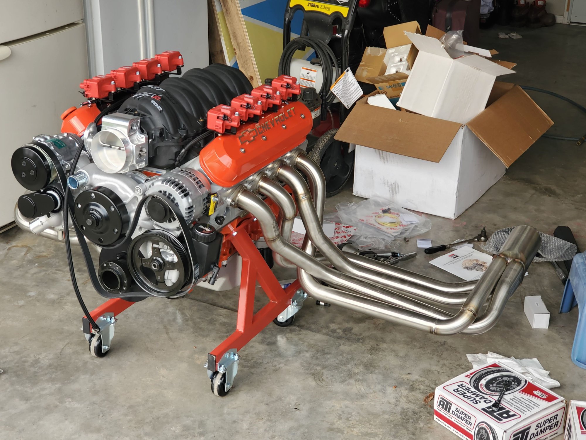

Here is another sidepipe option for you, though it will force some other improvements under the hood. See how the 2" pipes go low for the frame rail, then loop back up to go along the side of the car?

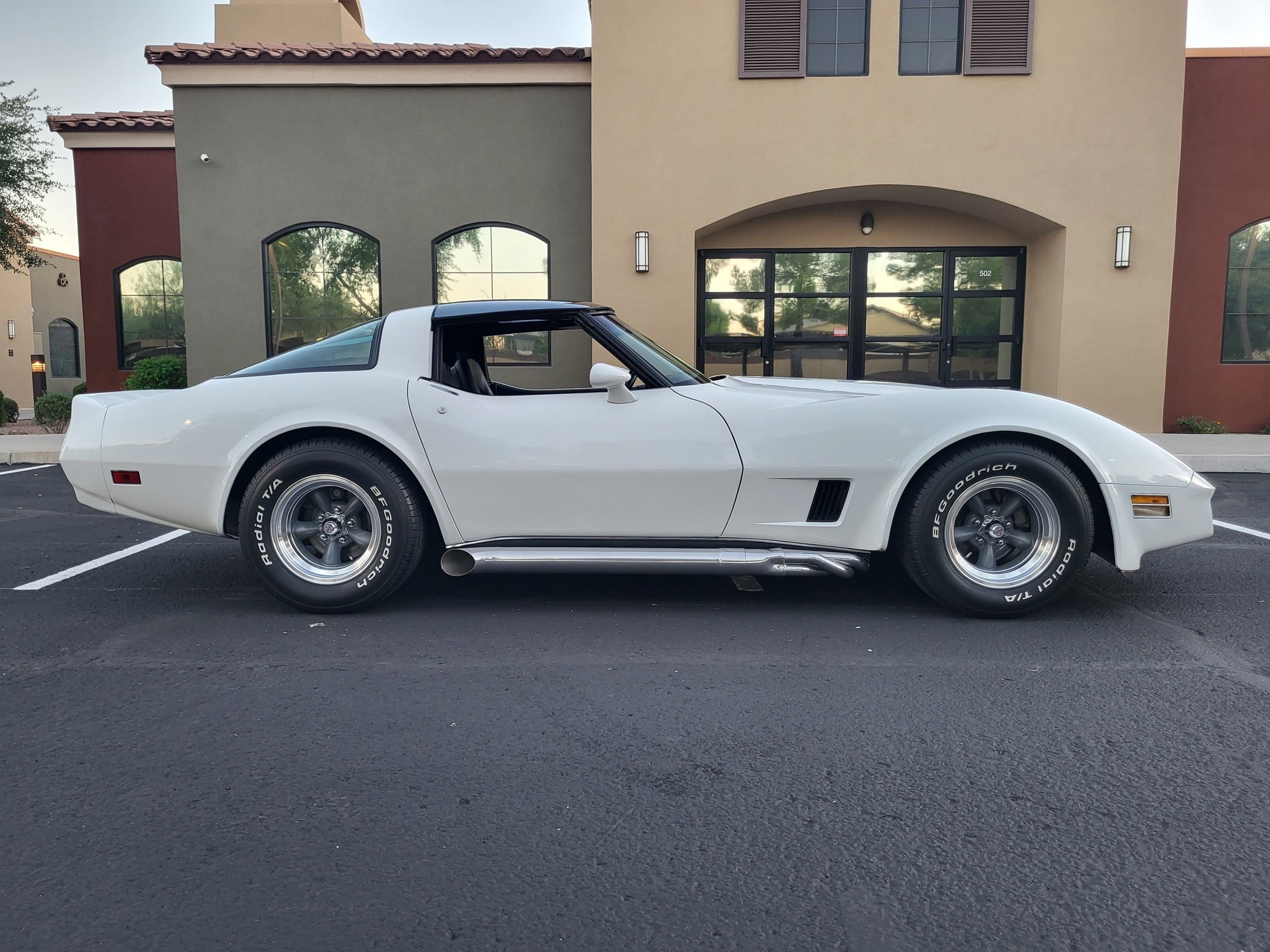

Originally Posted by Golfobsessed
Side pipe headers and AR Torque-Thrust wheels.......................
