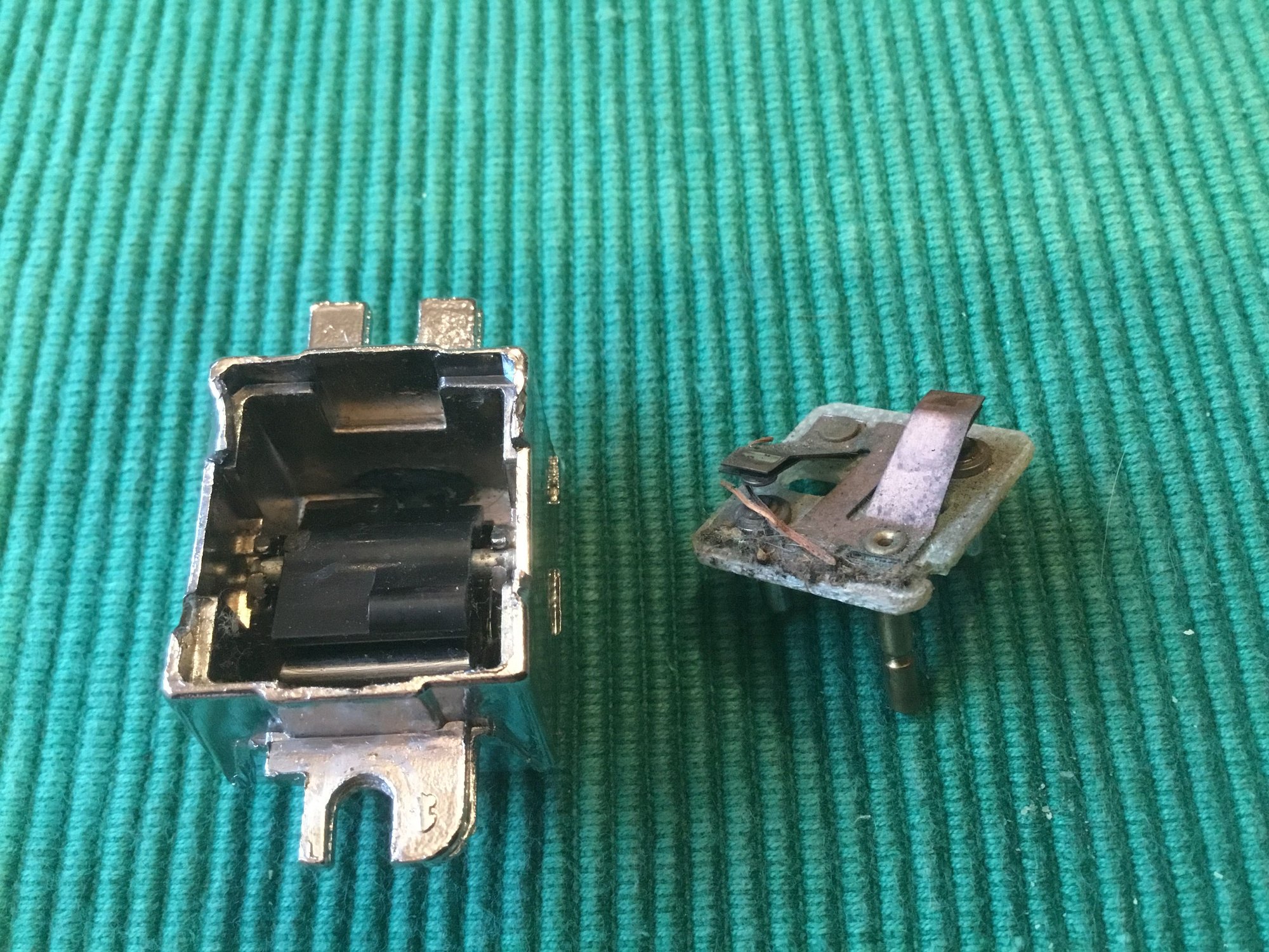

One of my 78’s is an ultra-low mileage, all original that hasn’t been messed with. I use it as a reference for my other ‘78 that has needed a lot more work. The windows go to the top in 2-3 seconds. The excessive inward lean of the window is the trickiest adjustment. I got the best result by attaching a glass panel suction cup, loosening all the adjustment points, jiggling the window into position, then tightening everything while holding the glass in position with the suction cup handle. It took a few months of leaving the window all the way up and parking in the sun a few times to get the new weatherstripping to compress enough. Lots of silicone on the rubber helps. The straight up orientation of the switches in the center console allows debris to get into the contacts of the switch. One of mine had a pine needle stuck across the contacts. In another one a PO had installed a plastic shield just below the switch swivel to keep debris out. The
switches also arc a little just before the contacts close, which gradually corrodes the contact points. They can be cleaned out, but the plastic casing breaks easily on getting it apart. Replacement switches are cheap and easy to install. New switches on mine made the window go up much faster.
