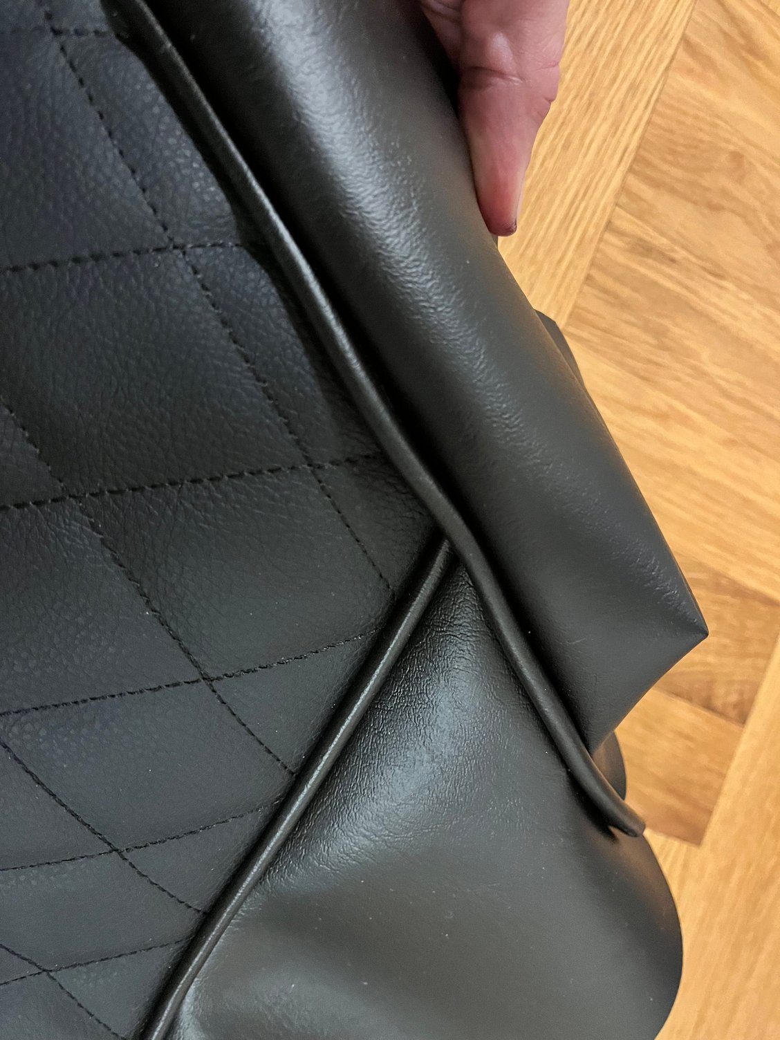

And scene…
Cover for the passenger panel is done. Tomorrow I will be gluing it to repaired panel plastic. By the first measurement it fits like a glove.
Here are some pics:
Piping
Pocket
Backside

So it is done. For some iPhone reason it looks wrinkled in photos, while in real life it is just a tad wavy, I expect it to straighten with time and heat cycling. In any cas I could have prevented it with denser foam. Now I know for the other side.
In any case here it is, you can be the judges.
So
First I had to repair the panel, I used plastic bondo and drywall mesh
Placed new foam, I should have put another layer, this proved to be a bit thin in the end
Strech here
And here, here I had to be very carefull with the heat gun
and here it is
pocket works
Here it is next to the seats
and one with the dash
