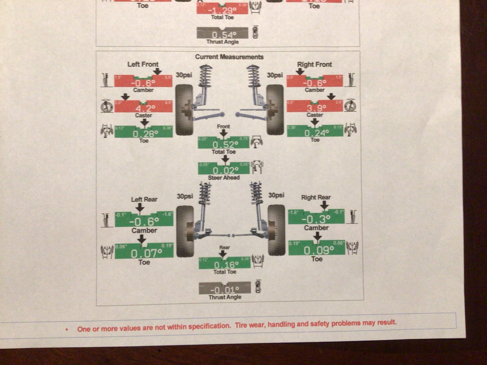

Calwldlife, I’m not great with the Vette power steering system, can you give more detail on too much PS boost? I’m leaning toward issues with the PS as there isn’t many other components that could be causing issues.
Here is the specs from the alignment shop. The tires have almost no miles but will need to be replaced due to age, I’ve been keeping speeds very low due to this.

Why does the rear toe small diagrams left and right show toe out on both sides?
Did you provide the Corvette specific alignment shims for the rear to adjust toe?
Unless it's because I'm on a phone, I dont see before and after numbers.
Exactly how old are these tires? Old hard tires can not be used to evaluate handling.

Hhmm, if I’m interpreting the specs correct the rear toe is about 1/2” positive? I requested 1/8” negative toe so it looks like I’m making a trip back to the shop. I was surprised they were able to get that much castor in the front. You are correct about the tires, they have no wear but are calendered out.

Is that the AFTER print out?
Look at the front, camber and caster they are in the red, that can't be good.
At the bottom of the printout in RED it says'values are NOT in specification'.
Time for new tires and then a correct alignment.

I did provide front and rear shims. I’ll check the pitman arm connection. I think the readout shows off (red) because they put in stock 1971 specs and I was going for more of a performance setup.
