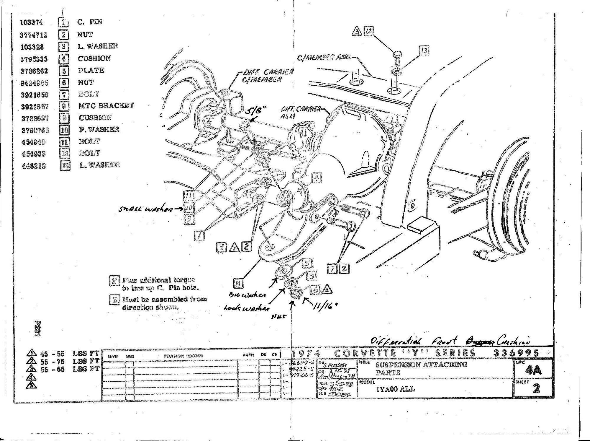

Im having a similar issue. Most of my problem went away when I changed the rubber bushing at the front of the differential however I still get that same noise when going into R from Park though now is much less.
