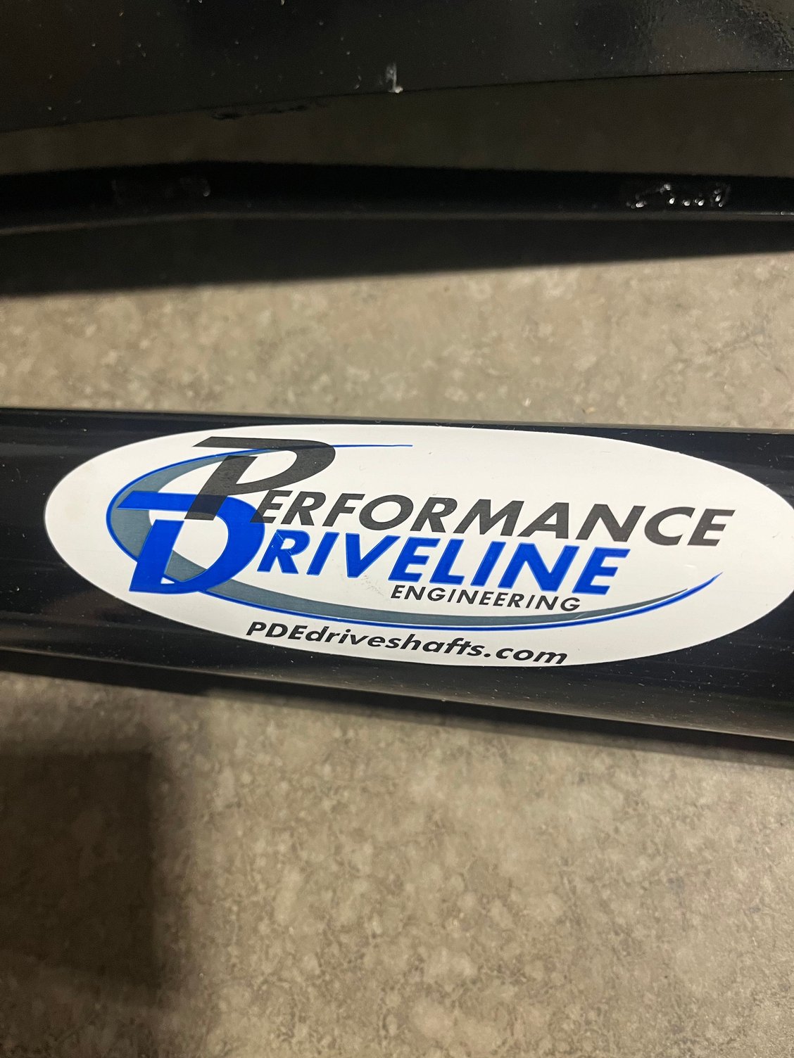

I recently had one built for my 79 700R4 - 27 inches center to center
This who I used:
http://driveshaftspecialist.com/Left...tte-Cobra.html

Sorry for the delay - yes it fits fine and I am able to install or remove it easily.
