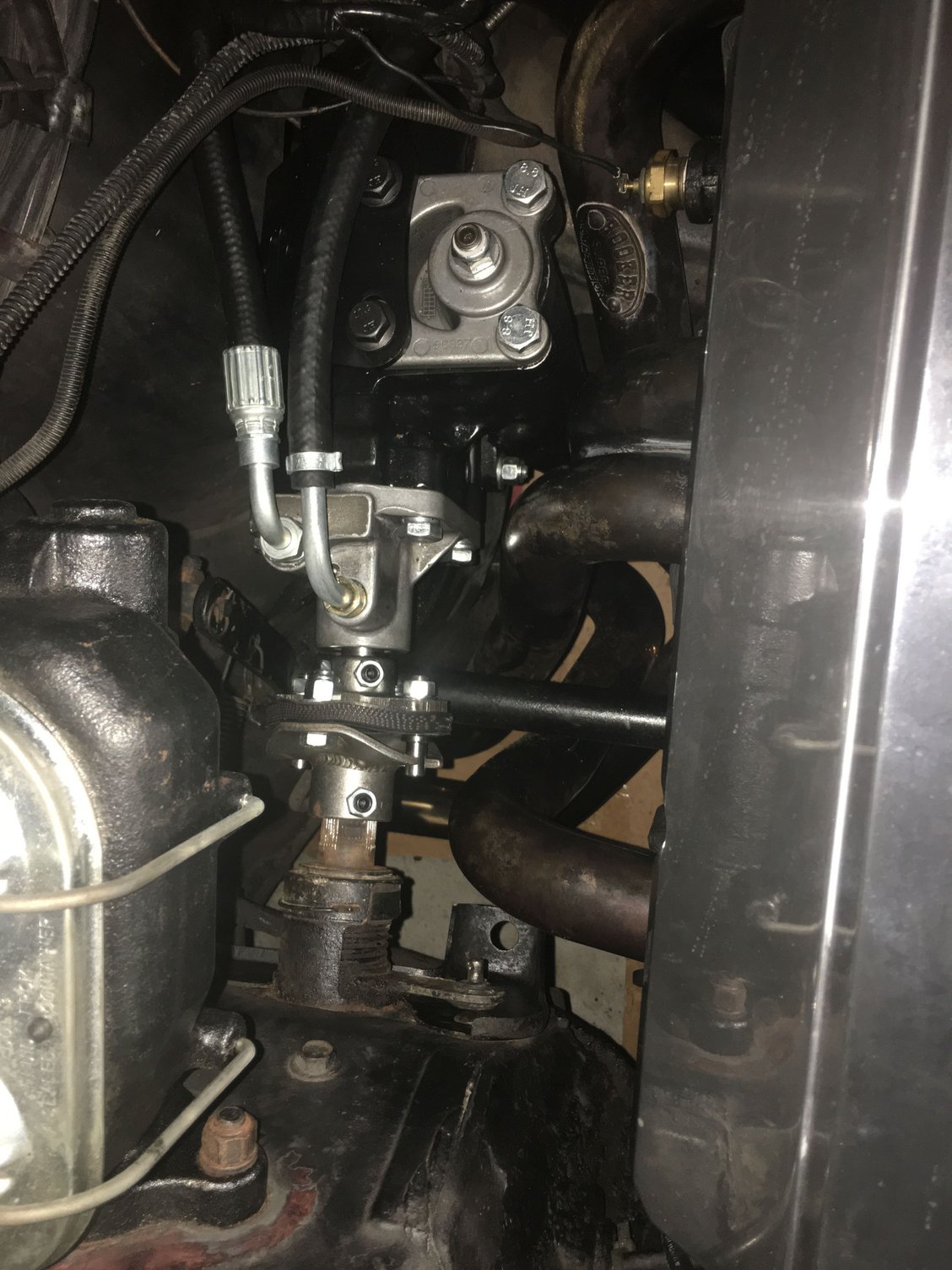

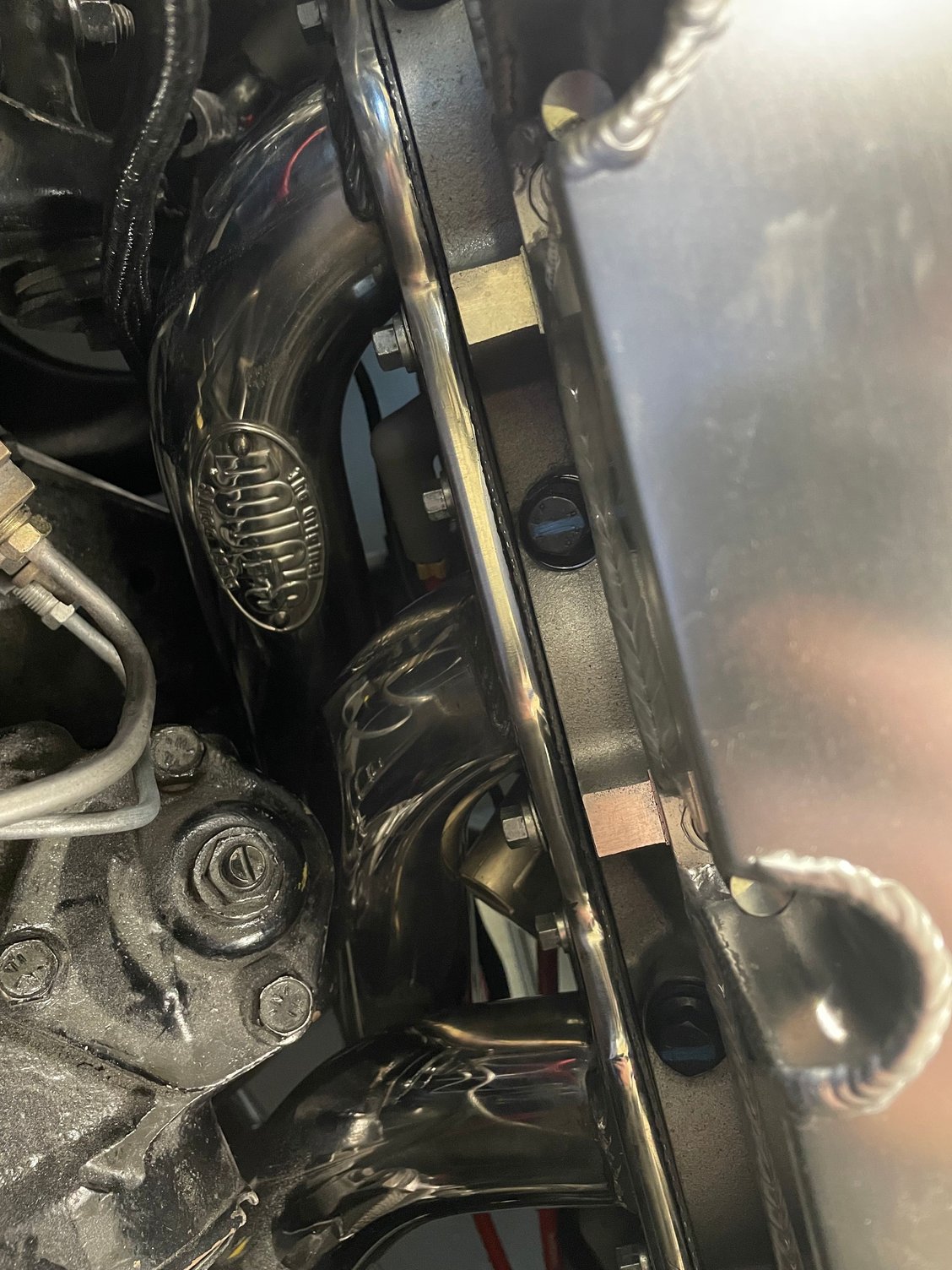

My concern is clearance, the Borgeson unit is bigger than the OE. My clearance right now is very minimal, I run 2 1/8” side pipe header and it’s really tight!
Old Jan 4, 2024 | 11:44 PM
augiedoggy's Avatar
augiedoggy
Joined: May 2007
Posts: 5,007
Likes: 1,114
From: North tonawanda NY
mine looksalmost the same, I have the borgeson, brace and cp1 adapters for the lines waiting to go in. From a couple videos I saw on this with sidepipes theres actually more room somehow with the dimensions of the borgeson. I want to say one of the videos was a guy that goes by lawdog and it was a 74.
