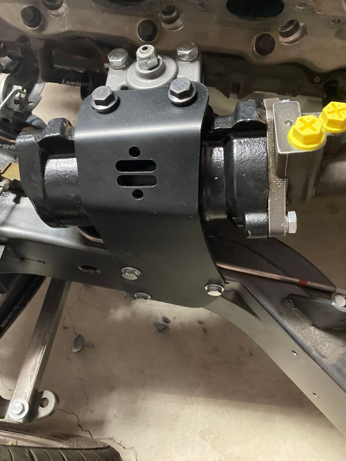

Not sure why you need to use the original carriage bolts once you put the brace on the square wholes are not accessible. Also I I'm running a big block with 21/8 primary's small dimple on second tube. Not an issue
They say tire can rub on bolts at lock.
I've seen that, and I've experienced that. There are ways to limit the max left-hand turn extent which would fix that. Otherwise, it's really only an issue in parking lots.
If you can get your carriage bolts out in one piece, great! I had to choose to cut the bolts, cut the body, or pull the body off the chassis, as @reno stallion shows above.

I have heard several people say the Borgeson is higher from the frame, and that is what causes it to flex.
It is not higher on the frame, it is exactly the same location, because it lines up with the steering shaft.
HOWEVER the boost pressure on a Borgeson is applied at the box.
The boost pressure on the OEM system is applied at the Ram.
Two completely different locations.
On the OEM system some pressure is applied at the manual box, and some from the ram, so the applied pressure is split between some above the frame, and some below.
Hence much less frame twisting with the OEM system, and much more with the Borgeson.
Use the brace.
The OEM system tends to crack the frame where the ram bracket attaches. There is a very thin section of metal between that bracket and it's bolt access hole only about an inch away. That's just a weak spot.
