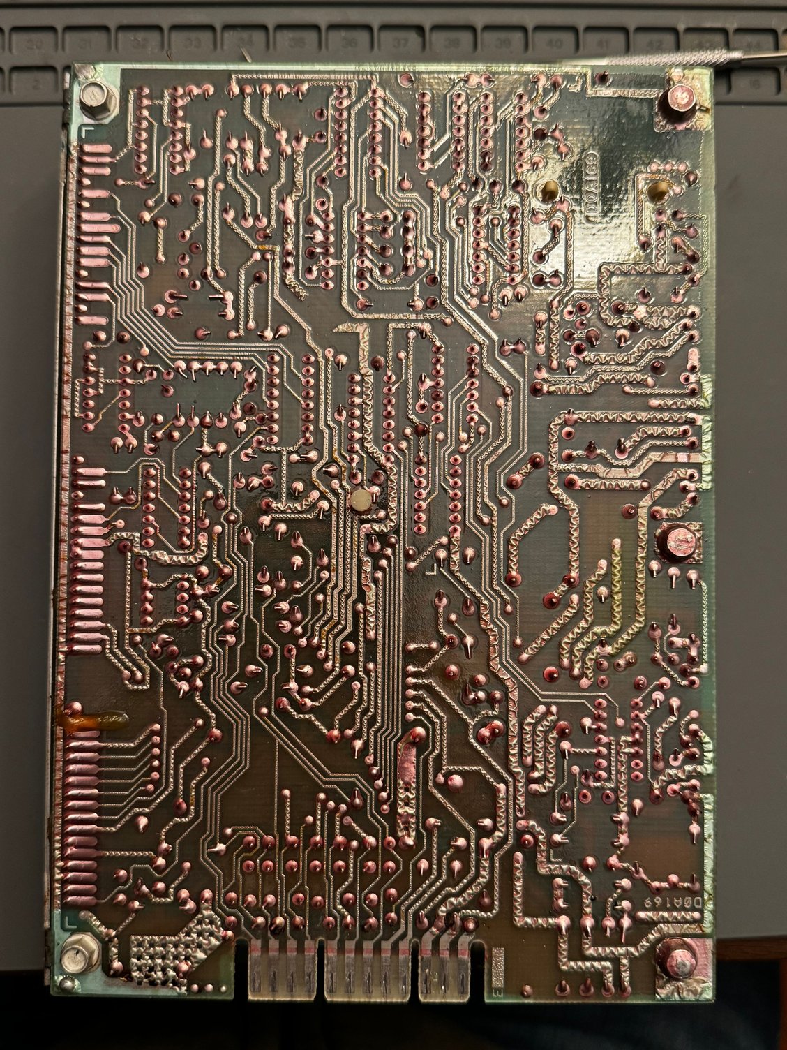

one last idea is did you ever change the coolant sensor my 84 acted nuts when mine was bad. and there cheap

I would open up the ECM and get a visual. My 84 was acting crazy and when I opened it up most of the copper traces on the board were crinkled and lifted off board. Clearly a bad ECM . I was able to find a re man ECM and has been running great ever since
Here’s a few pics I took of the ECM.
Taken after the pins were already cleaned.
