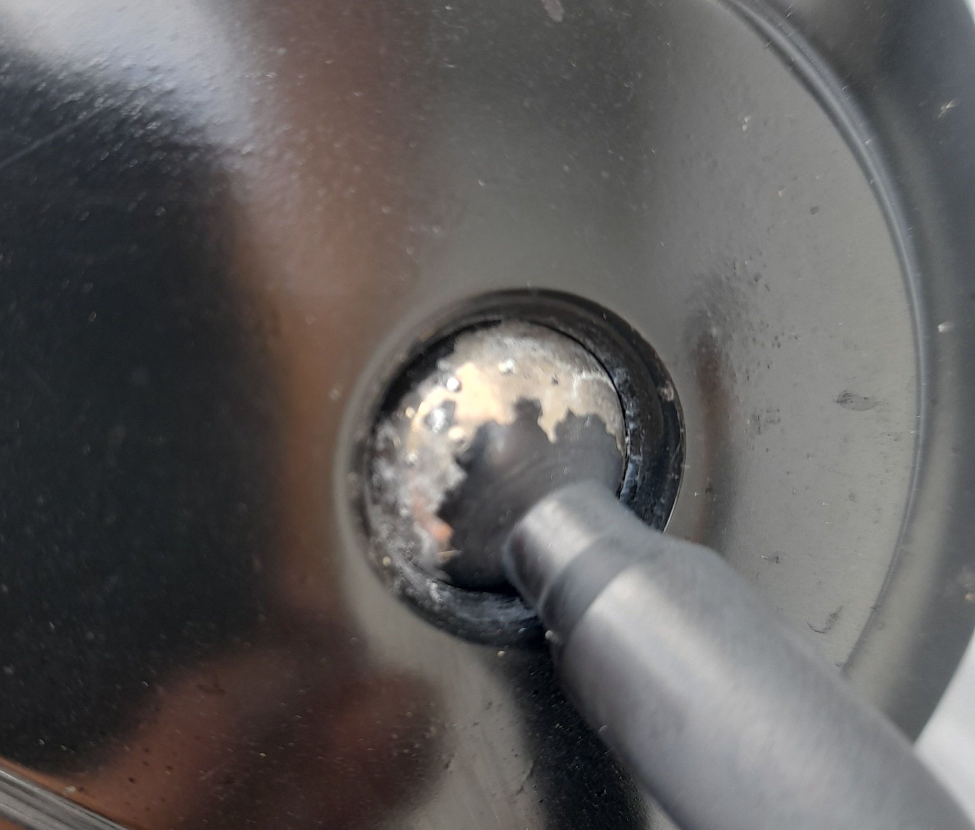

OK. Went outside and took a couple pic's of the mirror on my bike. It had a floppy head awhile back.
I'm not the best photographer, so I took 2. I think you can get the idea.
With a sharp center punch. You tip the mirror to the end of its movement in one direction, make a few punch marks in the ball. Tilt the mirror 90 degrees to its maximum movement in that direction exposing a different portion of the ball, more little punch marks, continue all the way around. Recenter the mirror. Note it's nice and tight now. Takes a couple minutes with the mirror on the bench. I like to put the mirror on a dense foam pad to protect it. Make certain your punch is freshly sharpened, so you don't need a lot of force to make the punch marks.

Originally Posted by TCracingCA
Find your ideal position, mark ball and surround, remove mirror, ensure marks lined up, fill with epoxy. Reinstall!
And if you ever wish to readjust???
The punches tighten it up and still allows adjustability.
