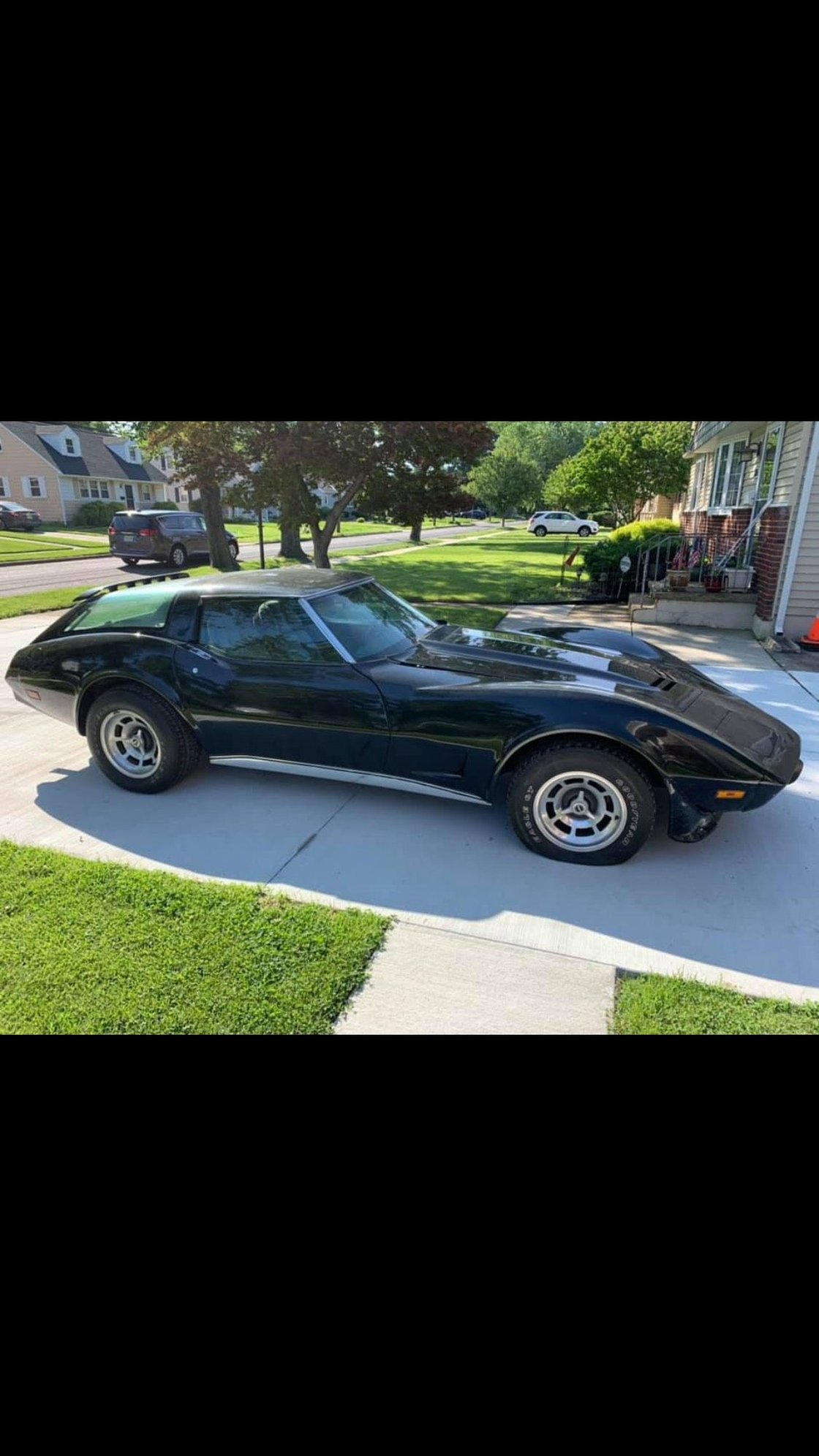

So I found this pic on facebook. The owner had recently bought this car and wasn't sure if the hood is stock height with front venting cutout. Does it look stock height. I kinda like the vent cutouts in the front. The car is a '75 greenwood sports wagon conversion.

The hood looks too high to be stock, and the first thing I thought of when I saw the cutouts was the chicken on a trans am hood. Not a good thing.

That's the stock hood. I have a friend that did the back end close to the windshield, but his didn't have the factory vents to start with.and he did it far enough forward of the windshield that it vented before the firewall.

haven't seen a Greenwood Sportwagon in years.. they were popular in the 70s early 80s .. built a couple in my shop.

That looks like the stock hood. I don't think those vents do anything useful, though. You'd want them a bit further back to extract hot air from past the radiator, like on a C7.
What does the underside of the hood look like?

Do you think it would help flow air out the back vent?

The grill at the rear of the hood is actually an inlet to an airbox above the air cleaner. Essentially a cowl induction setup.
It draws air from the high pressure area at the base of the windshield and routes it into the air cleaner.
You can't vent air out the back of the hood because of the high pressure there. Also, you don't want vents ahead of the radiator, because it decreases the radiator efficiency.
If you want to vent the engine compartment through the hood, you need to do it in the area behind the radiator back to about where the rear of the carb/air cleaner is.
Another option might be to increase airflow out the side vents.

I agree with the others here, I think the vents up front would defeat the purpose of the radiator seals for good cooling effect.

I'd add that later in production, there is no longer an inlet at the rear of the hood. On my black 79 (same hood, without the cutouts), there is a rubber seal at the rear. If it is absent, it will reduce cooling efficiency, as air will be forced in ahead of the windshield, and act to block air that would otherwise flow through the radiator.
Unless the vents at the front of the hood (or the rear of the hood) lead ONLY to the air cleaner, you will at best do nothing beneficial, and at worst defeat your radiator's cooling efficiency. I should caveat that by saying there are several on this Forum that do exactly that, reduce the available inlet air to the radiator, because they race their cars, and minimizing flow under the car at speed is important for handling, and at speed they get enough flow over the radiator to cool the car.
But if it looks cool, don't worry about it too much. The C7 extractor (behind the radiator), both looks cool AND is functional.

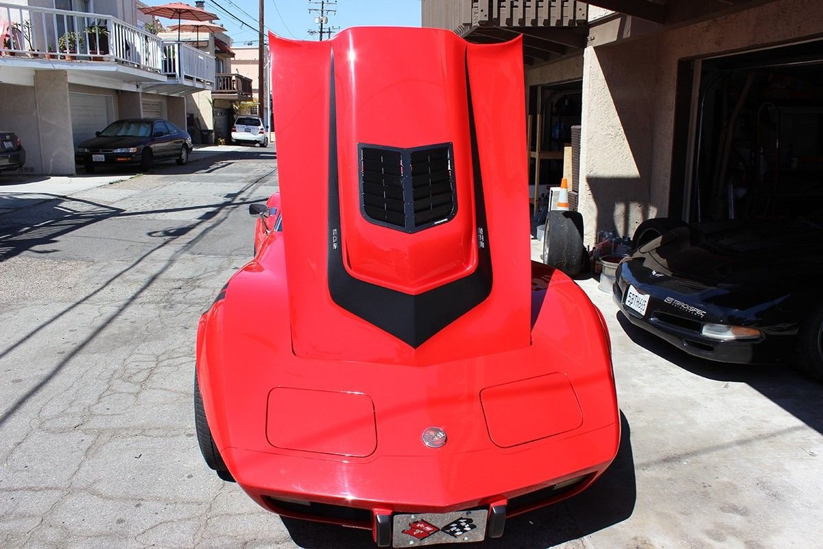

This is what I plan to do to my new hood. C7 hood vent.

I'd like to see how that looks on one of our stock hoods. I got a Turbo to cool under there.

I like the way the 4 vents look in the photo above, but seems to be too close to the radiator to be effective...
There is an aftermarket vent kit similar to the C7 style that's designed for a C3 hood... it looks pretty decent
but I can't remember the name off hand.
