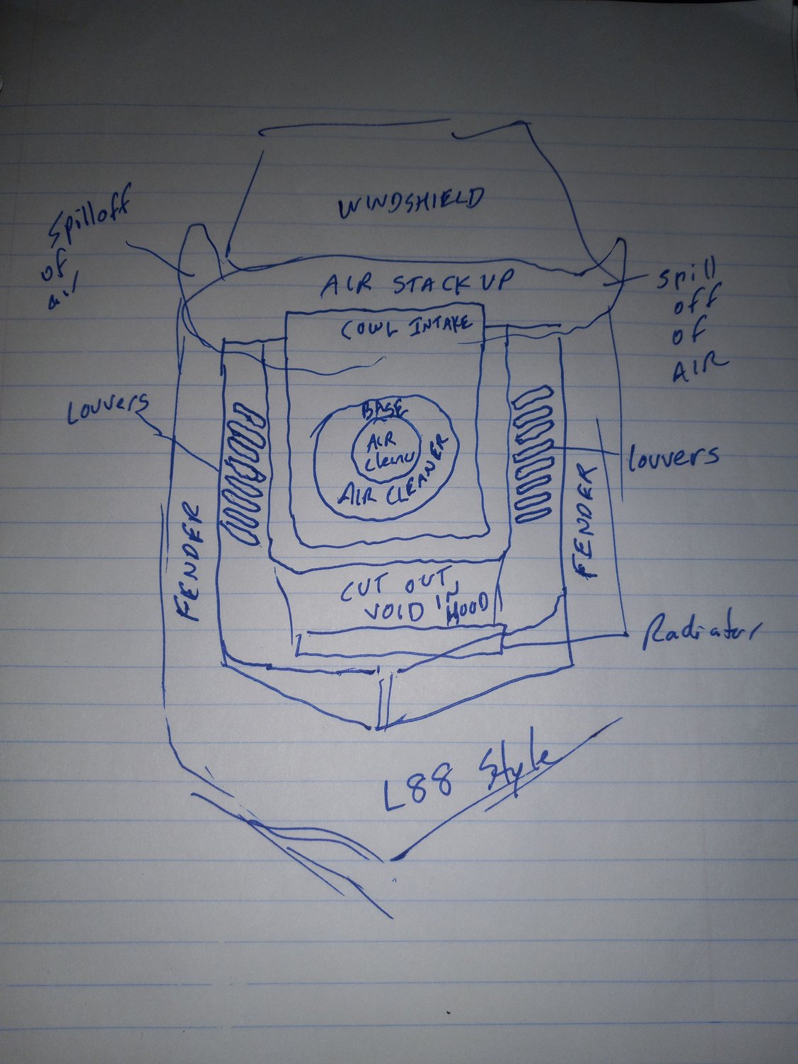

Interesting conversation. I am about to cut the dip or void area out of an L88 hood behind the radiator, in front of the hood carb duct box. The carb is essentially sealed at the front, cowl supplies air. I was attempting on our running car to figure out the area affected by the cowl air stack up by the windshield, and no vents there, at the back of the hood, but forward to help airflow exit, but also allow header heat to vent. Let me attempt a drawing.
