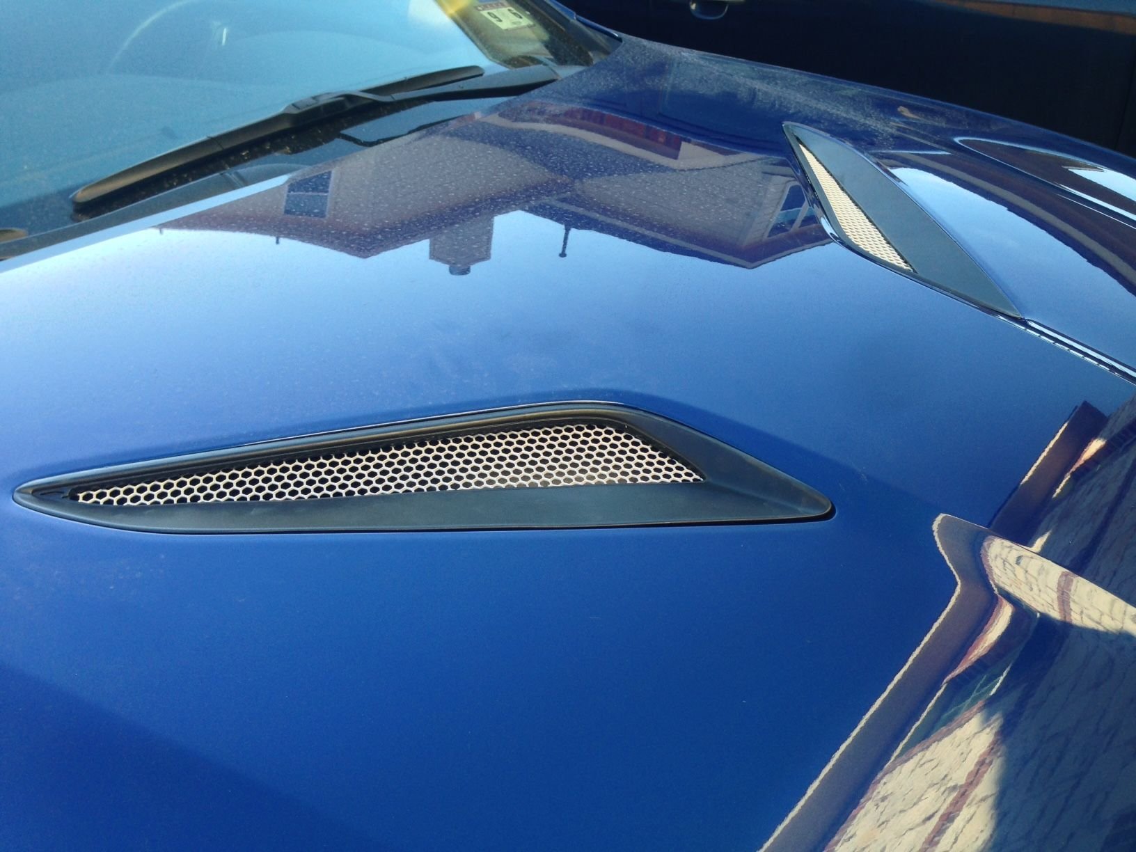

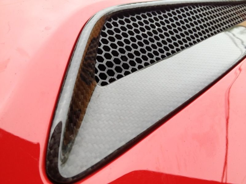

It looks like a couple of those cars are using these louvers from TrackSpec Motorsports:

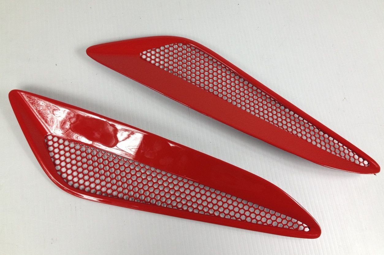

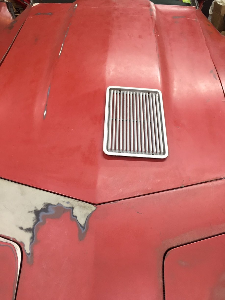

I'm considering this since I happen to have one laying around. It's from a Shelby Charger.
I have one more on the way. To be clear, I'm thinking about two of these, side by side.

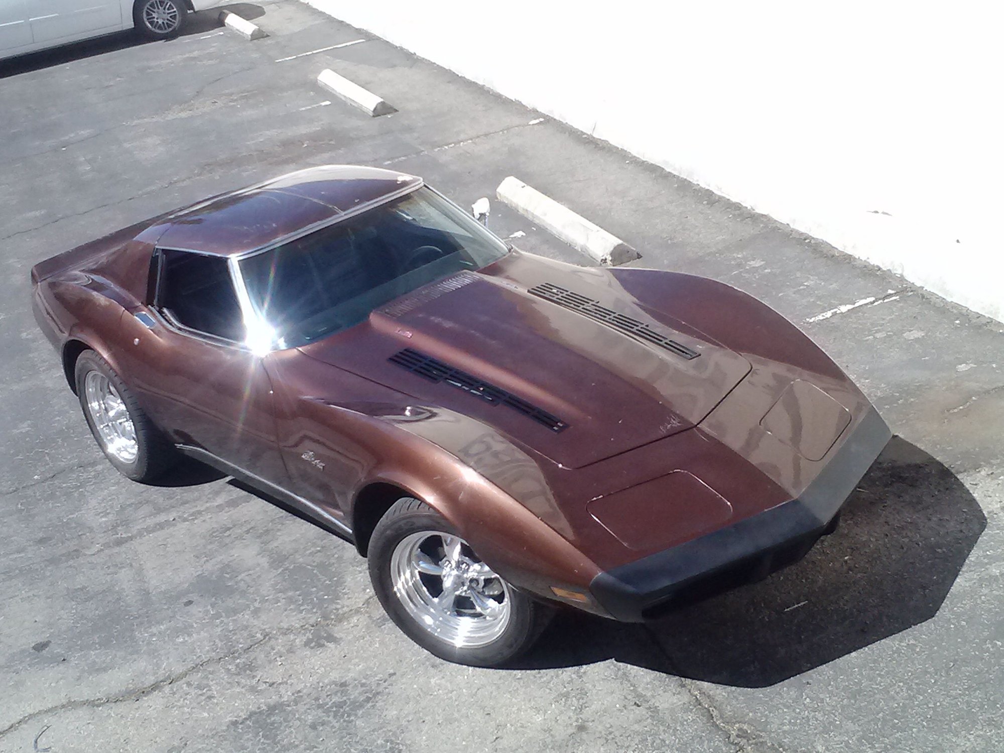

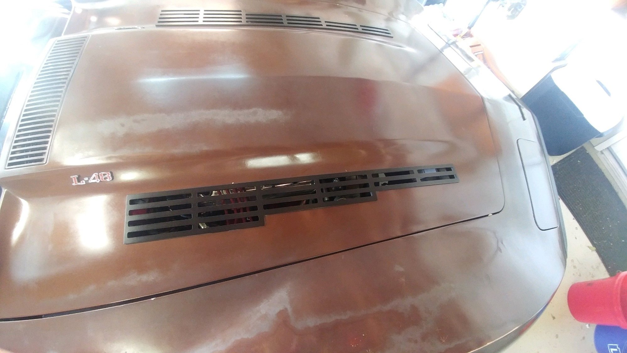

Here are my custom hood vents. I designed them and had a local metal working shop, water jet them out. I tried to go with a 70's factory vibe to the look. They are fastened with 3M body fastener strips. They sure help to evacuate the heat when sitting still, because basically, the C3 engine compartment is a sealed box. Not sure how they work moving, but I've never overheated either.(electric fans and alum. radiator). I have the exact measurements of the hood pieces and pics of the install as well.

I was told that the pressure in the engine bay is up close to the nose and to keep the vents as far forward as possible. Can anyone confirm that?

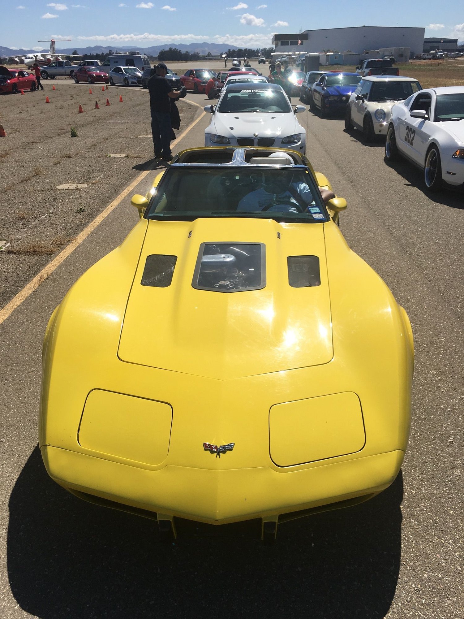

This is what I did to my stock hood. A ZR1 style plexiglass window and two screen vents. I used yarn tufts to show air flowing out of theses vents at speed. The underhood temp dropped, but the biggest surprise improvement was the high speed handling response. The front end was floating at illegal speeds and the vents eliminated that. The car was much more responsive at speed.

Anything that forces outside air through the radiator, while letting heated post-radiator air out of the engine compartment will help.
So, make sure your chin spoiler is in place, and your seals are in place around the radiator. After that, any vent that is on the flat part of the hood, aft of the radiator foam, will help with a car in stop and go traffic, as well as any improvements you can make to the stock fan.
If you are in a parade, for example, you could leave the rear of the hood up, and not latched. This will let your fan blow air out of the engine compartment. Just don't do this on the highway, as it will let air back into the engine compartment, and reduce the efficiency of your cooling.
