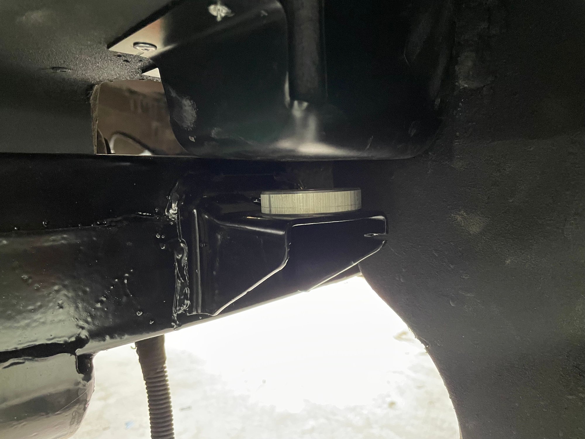

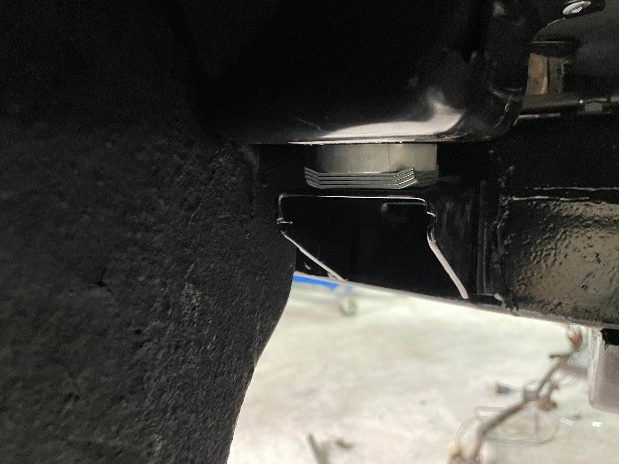

Today I finally put my body back on my restored frame and everything went well. When I got to the #4 Mount, there is a 1" gap between the frame mount and the body mount on the driver side and 3/4" on the passenger side. I noted the shims and put everything back how it was from the factory, but obviously something is out of whack here. Below are some notes:
  • #4 Body mounts are original and I didn't remove them from frame, only new reinforcements on the body.
  • crawled all under the car and I can't find any interference that would be holding the body up higher on the frame
  • I can feel the #3 BM properly seated to the bird cage.
  • If I tighten the #4, it results in the doors not being able to open.
  • The front clip is bonded to the body, but front brackets/supports aren't installed yet
  • Door gaps are close to what they were before I removed the body - still needs some fine tuning.
It seems like something is causing this and shimming the 1" Gap isn't the correct answer. Any advice?

Well folks I went out today to lift up the body to inspect and remove all the shims and found some serious user error: The fender washers and lock washers were sitting on top of the #3 body mounts!!!! Explains why I couldn't find them!!! So that's why the #4 was so high! I put the body back down with no shims and only finger tight. The PS #4 took one shim and the DS #4 took three to make it touch the mounts.
