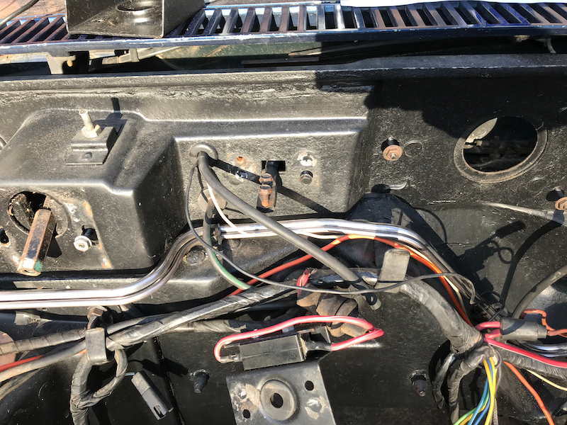

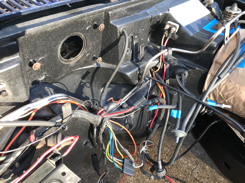

Here are pics of my '72's firewall when the engine was out for rebuilding, prior to replacing the engine harness. The steel line is a double-tube assembly for part of the run. I don't know how/if it would fit a '68.

Yep, those could work for you
