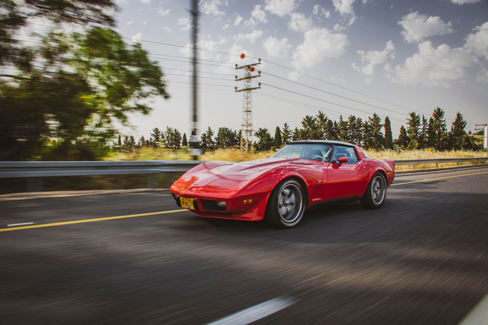

Im from Israel...in the summer its can get pretty hot here...
225F its the top it can get with Ac on
Normal working temp are 190~210F
in my situaition it will be a problem to change pistons ,there is no place that can balance a rotating assembly here...

its seems we have the same car ...my car was 79 L82 4spd
i have it from 2009 i replaced the radiator with 4 row aluminum one with duel spals. in summer days thay its was running hot with the AC on 210-220 and 225 for short periods...
i replaced the spals with a big vent from mercedes its now working much cooler but still can get hot on trafic in summer and ac on
i hope with the new engine with much smaller cam its will work less hot
