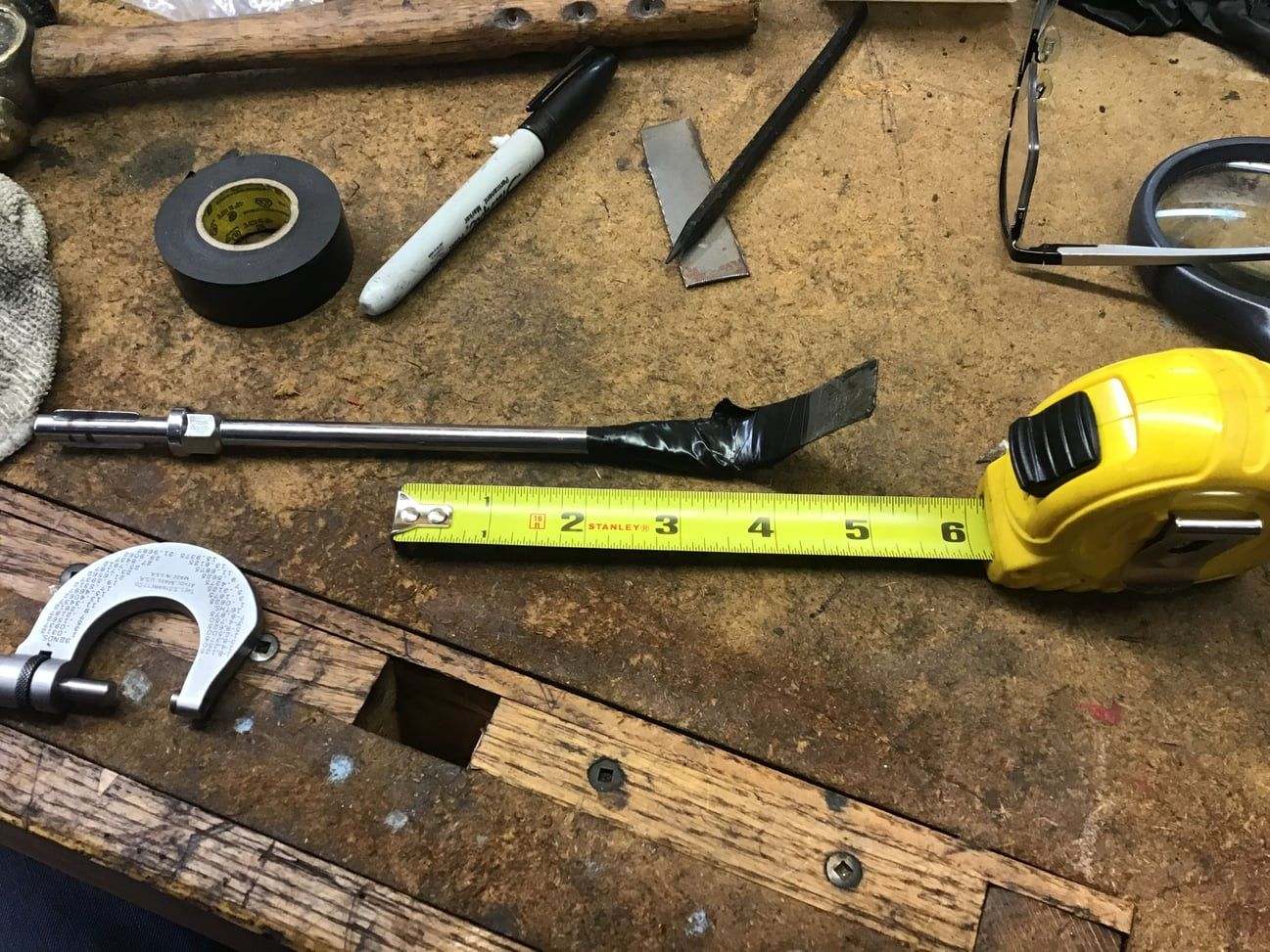

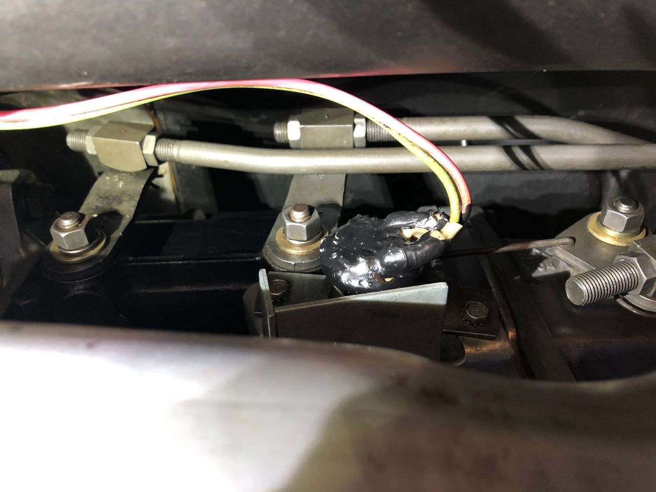

here is your 79 4sp (mine M21 close ratio not sure it matters).
skip to post 60 ish for alignment.
also be sure bracket did not come loose , inspect for bushings in linkages..
use that half moon as final inspection for alignment. the tool you make can work as well but i used visual half moons that seem to be more accurate than the alignment tool i built.
good luck keep posted and take many pics!. also sometimes nice to have someone shift around while you inspect for off stuff..
No you don't need to remove transmission for linkage but if you do want to start at post 1
also check clutch adjustment below
https://www.corvetteforum.com/forums...ispreloading=1
