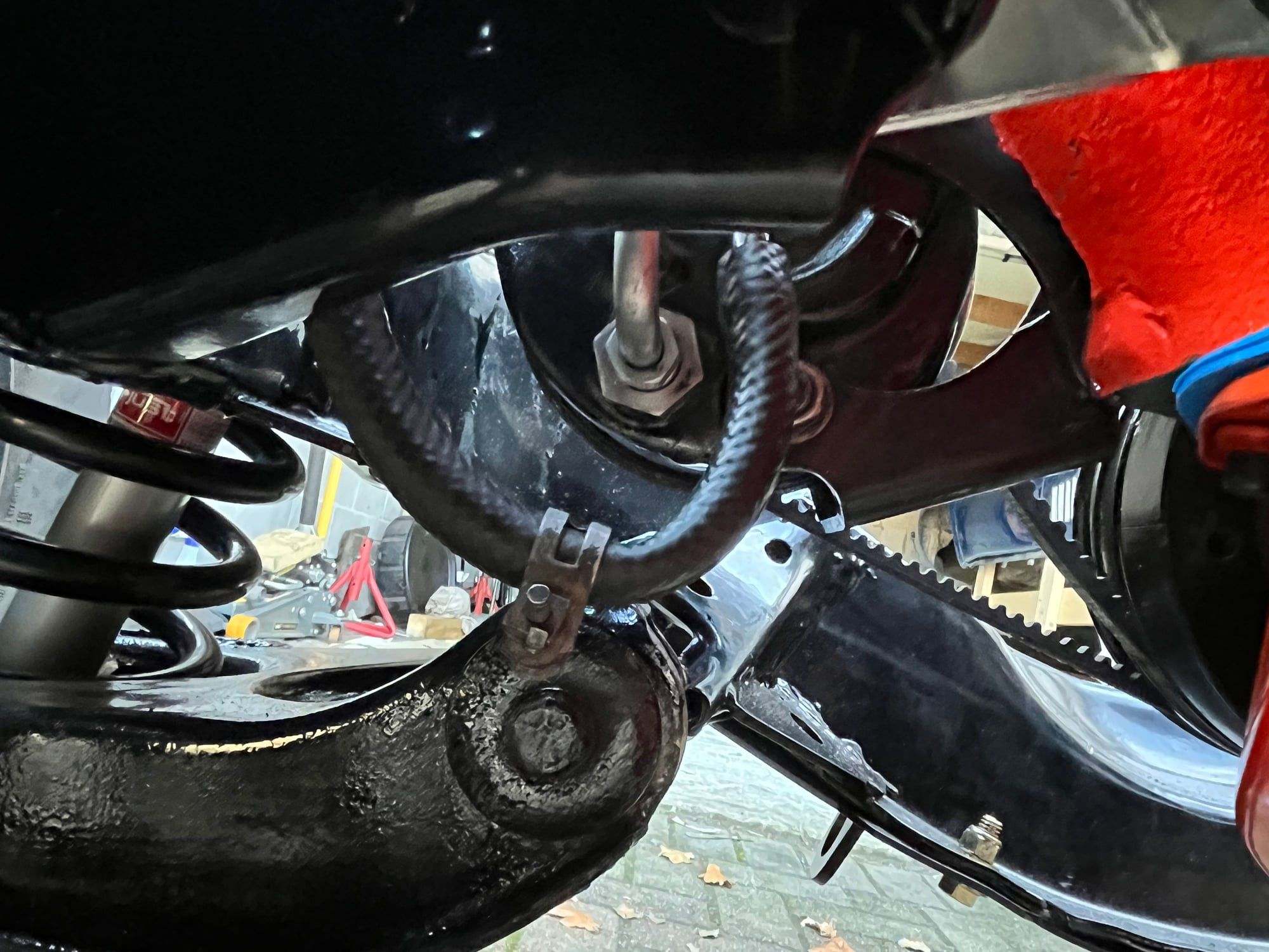

…well, in my Borgeson PS return line, I do No matter how I route it, I cannot seem to fully get rid of it. Any suggestions ?

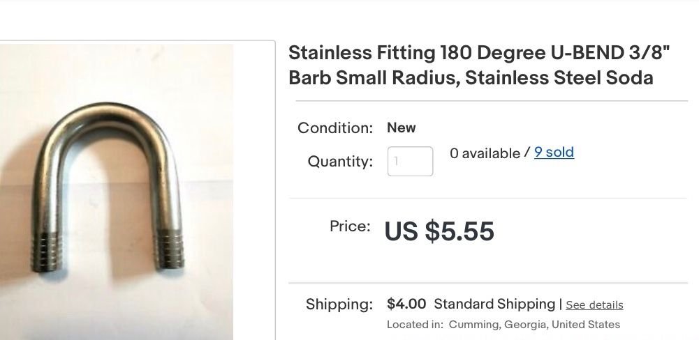

Search this forum for Borgeson Return Line. A U shaped connector will do the trick. I bought mine from kegworks.com.

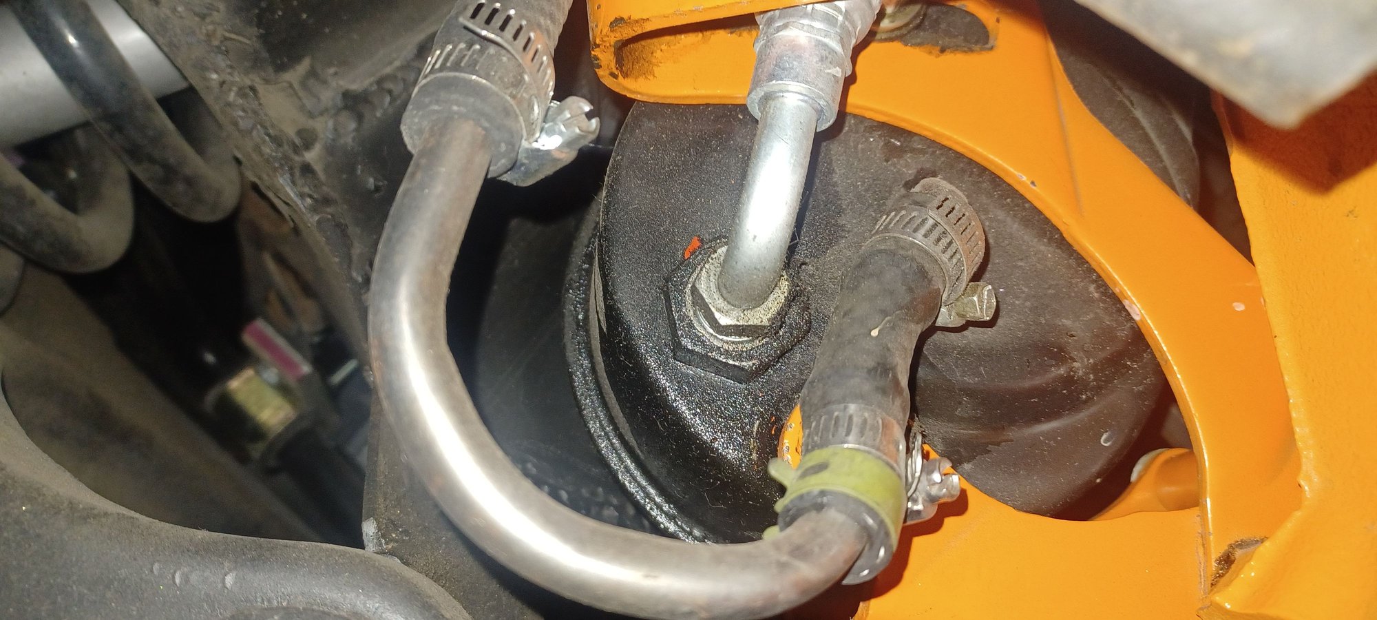

Heres the one I made

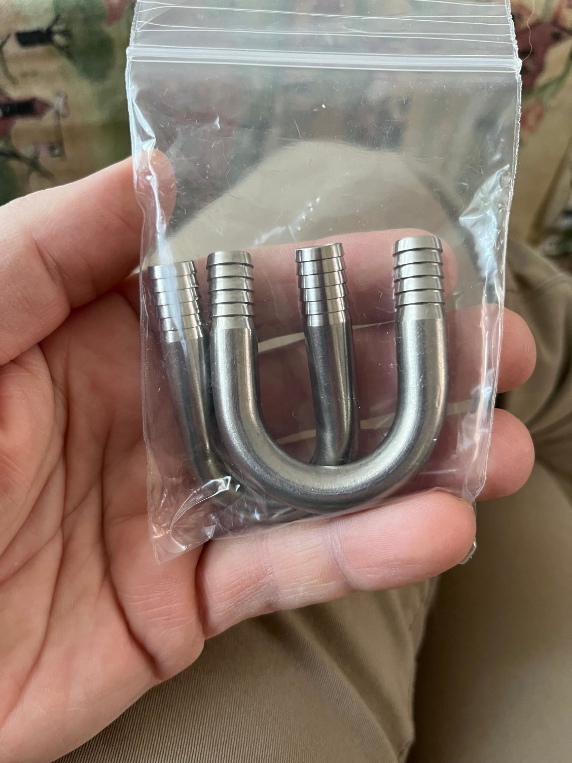

Tomorrow we try this out.
From Kegworks

Thats the ticket.
