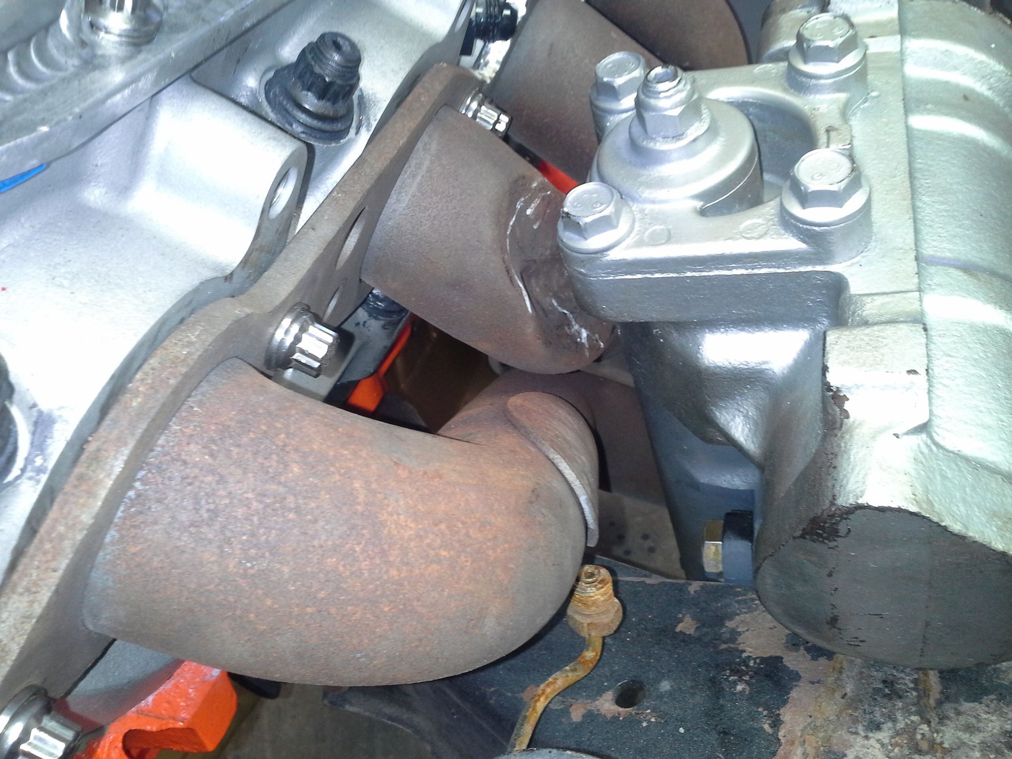

Look at marine manifold extensions...They make different thickness spacers. I used a set on my 327 to clear rubbing issues. To see mock it up just use a stack of washers to mimic the spacer to see if they would work for you before throwing money at it
https://www.hardin-marine.com/c-390-...d-spacers.aspx
https://www.hardin-marine.com/p-1281...ock-chevy.aspx
https://www.hardin-marine.com/p-1282...ock-chevy.aspx
I used longer allen head bolts that were drilled for safety wire to lock the bolts so they didnt loosen

About my header installation sage. Just found out from Brodix that the exhaust ports on the heads I have are elevated 0.600 of an inch higher than stock! Great for performance, not good for a generically dimensioned pre-made header. Curiously, the passenger side header fits fine! It's the driver's side that's going to need altering. Looks like I need to cut cut the driver's side tubes along their generally vertical sections and have small exetensions welded in. Building a rest-mod is a lot of fun!

I went with Brodix Race Rites so I wouldnt have to deal with this...good luck. Heres your chance to learn to Tig

I did the brodix heads years ago , I had to get only one tube of the hooker side pipe header "adjusted" and the worst fit one was cut and replaced to clear the jeep box
