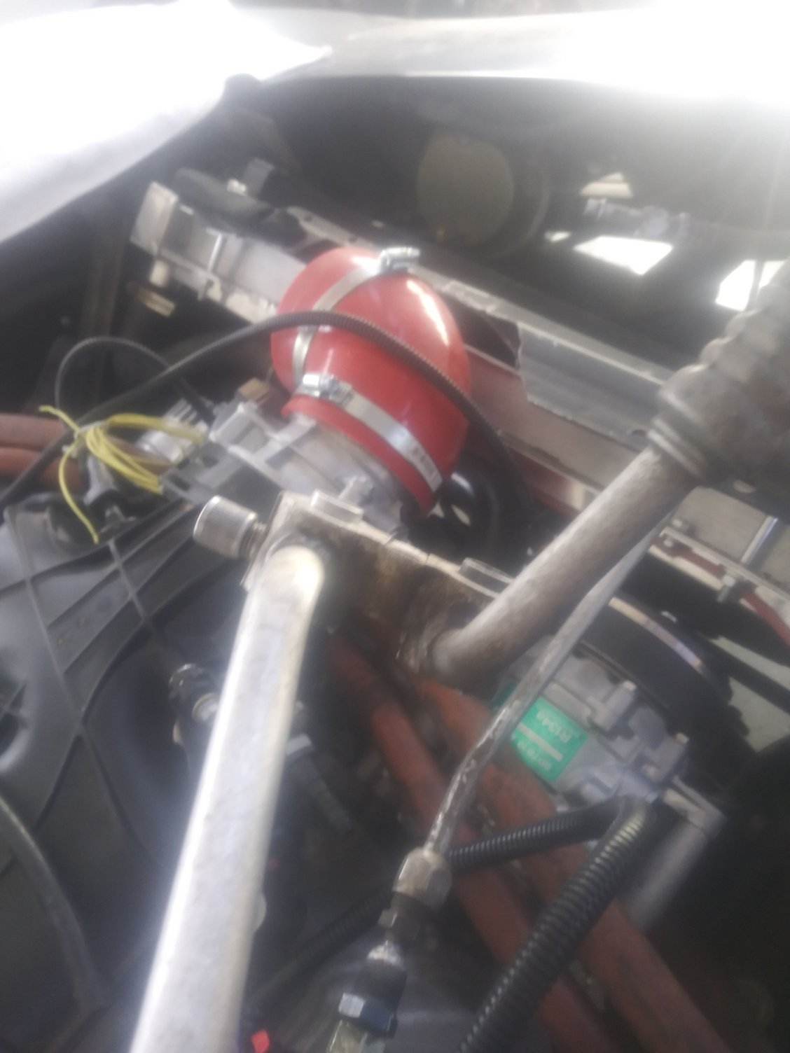

I am installing a gen V LT1 into my 1978. I am using the Holley front end package with the SD7 compressor. The original mounting was at the back of the compressor and had the larger tube ( return line from the evaporator ) to the left looking at it from the back of the unit. The new unit has the mount on the side with the larger connection to the front - photos attached. I am trying to make sure that is the correct way to re-attach the lines once I get the fittings brazed on the lines. Any help is greatly appreciated. Ed
I also realize I have to switch to R134 also , which means a new dryer and oil

They make different rear heads. They allow to use your oem lines. I believe it’s. QD head for gm.
nostalgic AC.

The new unit has a side mount , so I plan on cutting and brazing new fittings on the old lines. I just want to confirm that the larger tube is supposed to go on the front of the new mount ( pic# 3 ). It's been too long since high school when I learned about refrigeration to mess things up now.
