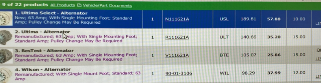

My voltage regulator went out last fall (What kind of junk are they trying to peddle on us, it only lasted 56 years!). So I went to see a family member of whom works at O'Reilly's. He said I could have an ac Delco regulator for $101.99 but he could order me a 63amp alternator internal regulator style....list price is $189.81 but with his discount it's $57.88. What's the best route?
