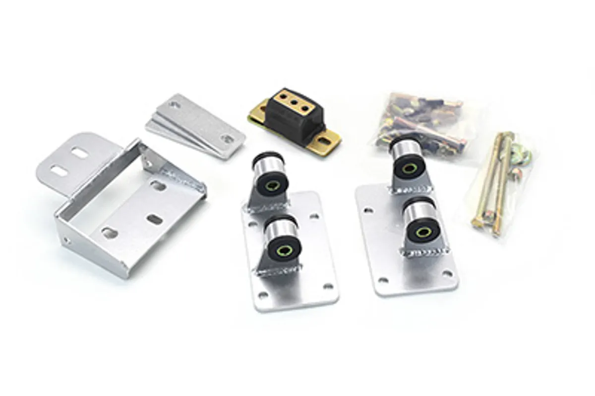

Hello I am installing an ls7 and 700r4 in my 68 c3 . I purchased Top Flights mount kit #75914 and the bolts that pass through the mount to frame will not fit holes are off about 1/2 bolt diameter . Frame measures correctly as per GM specifications. I contacted Top Fight and they recommended this forum .I would appreciate any input THANKS.

You mean one of these kits?
https://www.topflightautomotive.com/...ine-mount-set/
Why not use ICT Billet adapters, and Moroso solid (SBC) engine mounts? That seems to be the go-to solution for most of the LS swaps on this site, and what I'm using for both of mine.

If it's vertical on the engine side mounts. You need to put the engine in and then adjust your transmission up or down to run the bolts through.
Being a 1968 frame I don't know what you actually measured, but I would tend to say that your frame is warped over the years or someone jacked up the car under the front cross brace. I don't think that it would be a problem using a dremel bit to elongate the existing hole. Or cut off those mount raised arms and reweld in the correct for your position.
Attaching the phoney tranny mount to the cross member. I would buy the complete tranny cross member from some place like G-Force for the TKO/700R4. It makes routing the exaust so much easier because the pipes pass under and not through it.
