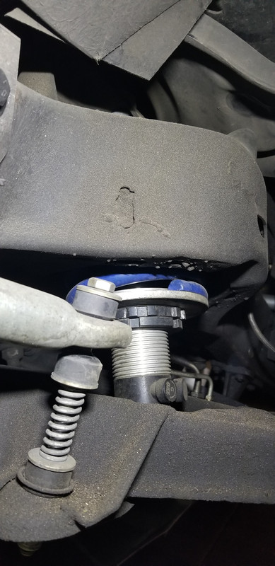

From: Reno Nevada
Start out about 1 3/4 inches of threads on the botton to the collar to start and it's easier to lower later than lift. Enlarge the bolt holes like previously mentioned. You install them and go drive around stomping on the brakes at slow speed to settle them out and then disconnect the sway bar on one end to set equal ride hight both sides unless you have the spring ends like mine.
This is typical road grit after 1000 miles

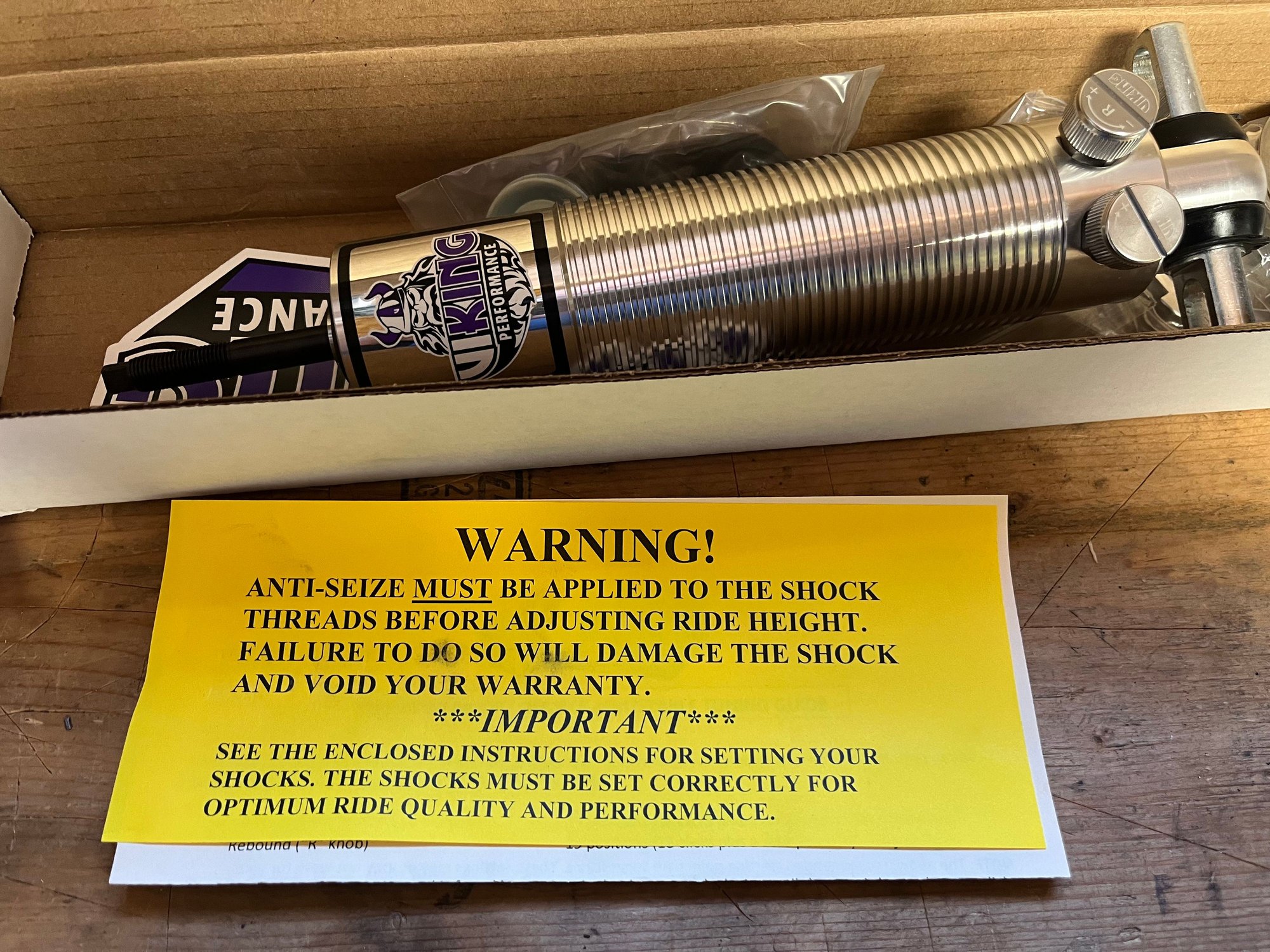

Originally Posted by gkull
Wrong! too much road dust. That is really bad information! Even in my off road racing machine the most I have ever done is a squirt of penitrating oil and then blow it off with brake cleaner when I'm done adjusting with Fox shocks
This large notice came with the shocks, so I will be putting “some” on there. They don’t say how much though…
