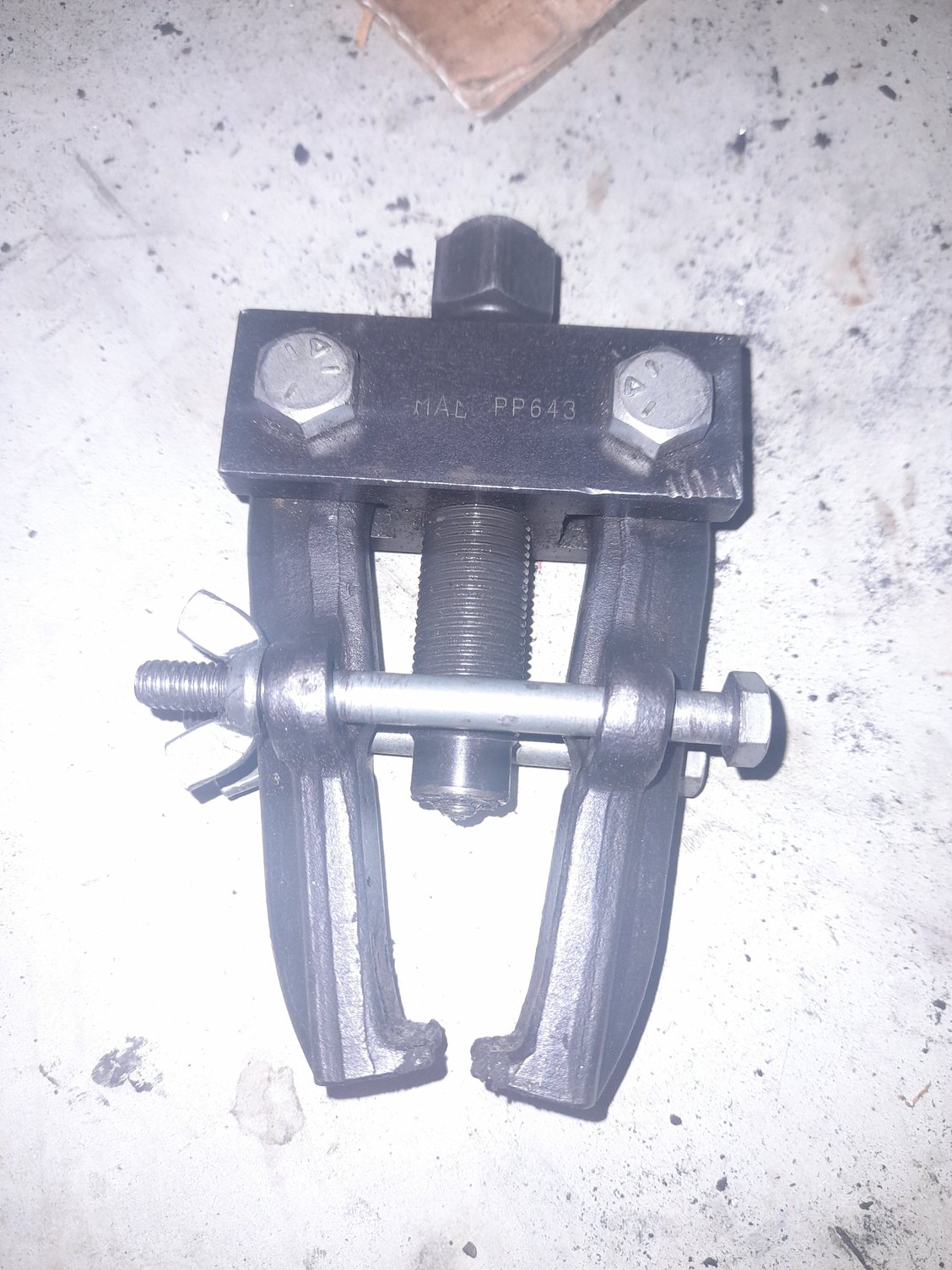

I used this separator tool for all my front suspension and steering.
Just remove the castle nut and put it back on upside down, just enough to protect the threads of the idler arm.
Install the tool and turn the bolt assembly.
I would put a little pressure on the bolt and walk away, come back and add a little more pressure to the bolt.
After a couple times, I would walk away and hear the joints pop.
No hammering, nothing.

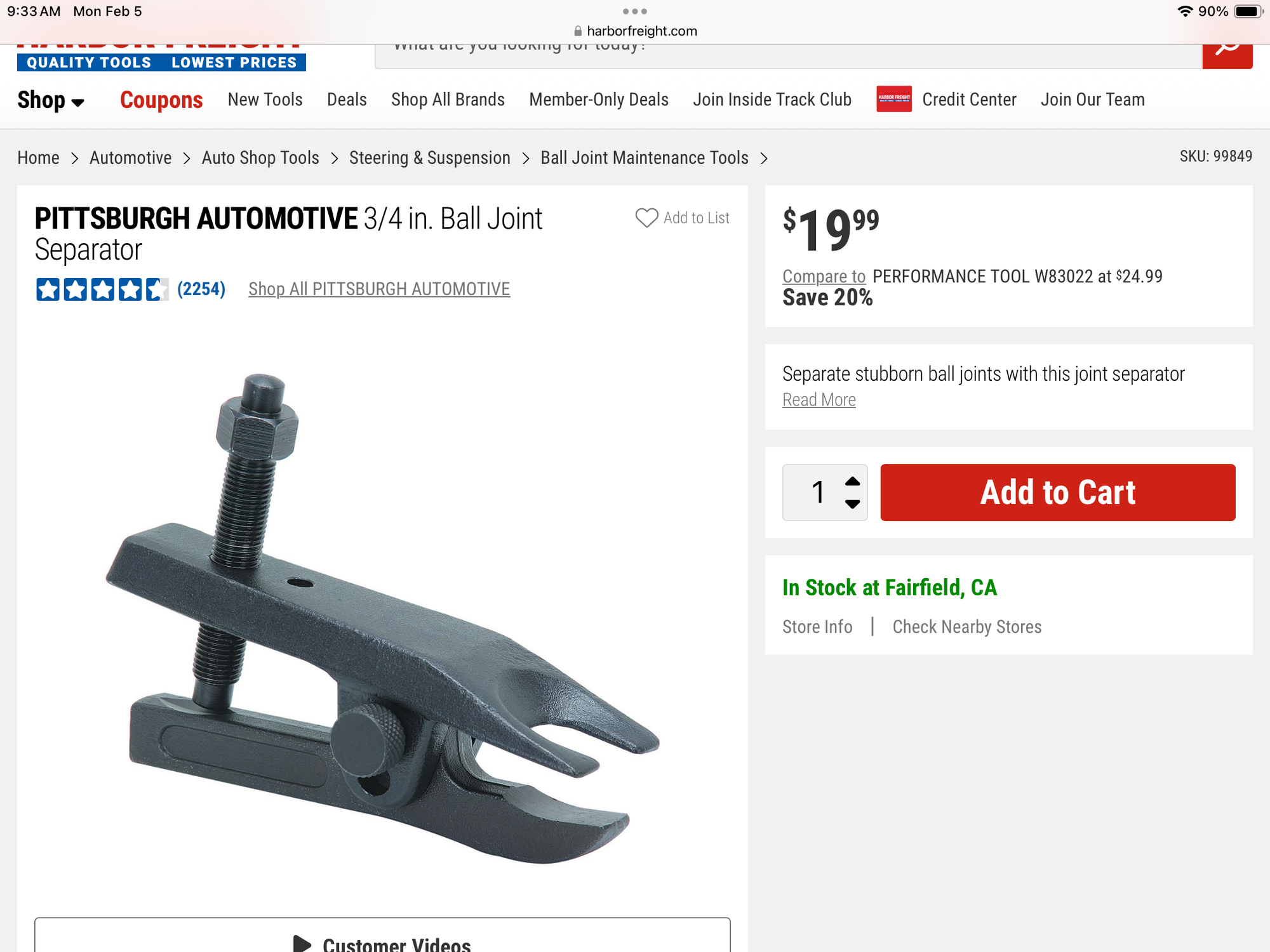

This tool. And done.
